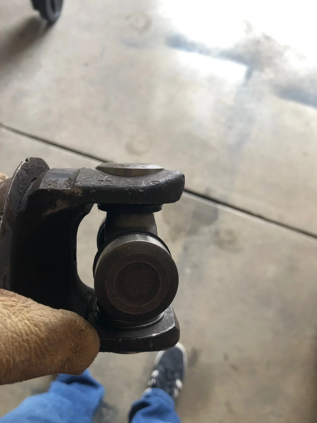

So I have been dealing with axle shafts/ujoints from hell. Long story short, but the caps are shearing the ear. This cap needs driven down about 1/16" is all for the clip to slide in. I've beat on this thing, pressed, soaked, it simply will not budge any further.
75737
Have you pulled it apart to make sure there isn't a needle bearing laying in the bottom?
I did, they are packed well with grease and have not moved. In this spot, I can turn the joint pretty freely, its not binding. The passenger side was just as stubborn.
And verified that the ears on the shaft are not bent?
They very well may be considering how much effort I've put into removing the old joint and installing the new one up to this point.
By the naked eye it looks straight. The cap shearing away at the metal though leads me to believe that there is a lip somewhere within the ear that the cap is getting stuck on.
This makes me question putting new joints in my trail spare axles. They are both pretty worn out, and need replaced. Are these chromoly axles?
Yes. Alloys I believe. They came with the built Dana 30 a couple of years ago.
