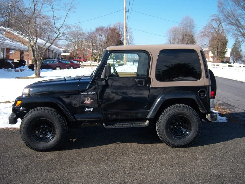

Hey guys, I want to put some larger tires on my stock Sahara but am worried about rubbing both on the fender/flare and on the inner fender when turning the jeep as it is my DD. I love the look of the tires coming slightly outside the flare soI am considering some 15x8 Pro-Comp series 97 steel wheels with 3.75 backspacing (with the 5 x 4.5 bolt pattern obviously). If I stay stock and pair these wheels with a tire around 31-32 in, say a 265/75, would I be ok for a DD? The most "offroading" I will be doing in the near future would be camping or fishing, so I'm not concerned about major flexing. If anyone has pictures of a similar set-up I would love to see them and hear how it has worked for you. Thanks!

With that back spacing your wheels will definitely stick out past the fender flare and give you the look you're after, no doubt about it.
In addition, you can comfortably run 31" tires on a stock TJ Wrangler suspension without any issues. Going up to a 32" tire will indeed fit on the stock suspension as well, it may just be a little tighter, but as long as you don't plan on doing any major off road flexing you'll be just fine!
FYI, here is stock suspension on 32" tires:
