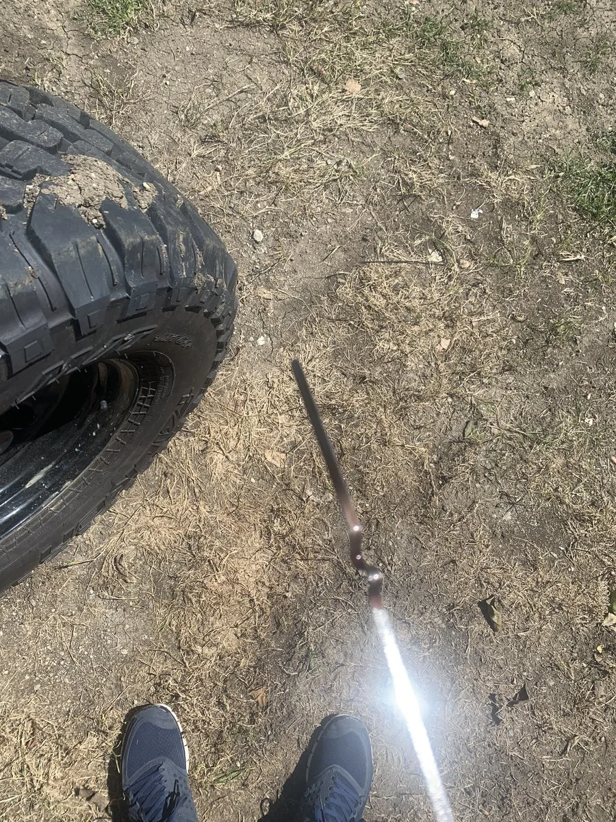

What does the trans fluid look like on the dipstick? Have you washed out the mud from underneath? Clean up the underside and park it over a large piece of cardboard. That will give you a good indication of where to look for the leak. If there is water inside the trans drop the pan and (bare minimum) replace the filter, refill and get to a shop.
I’ll post a picture here tomorrow to show you guys

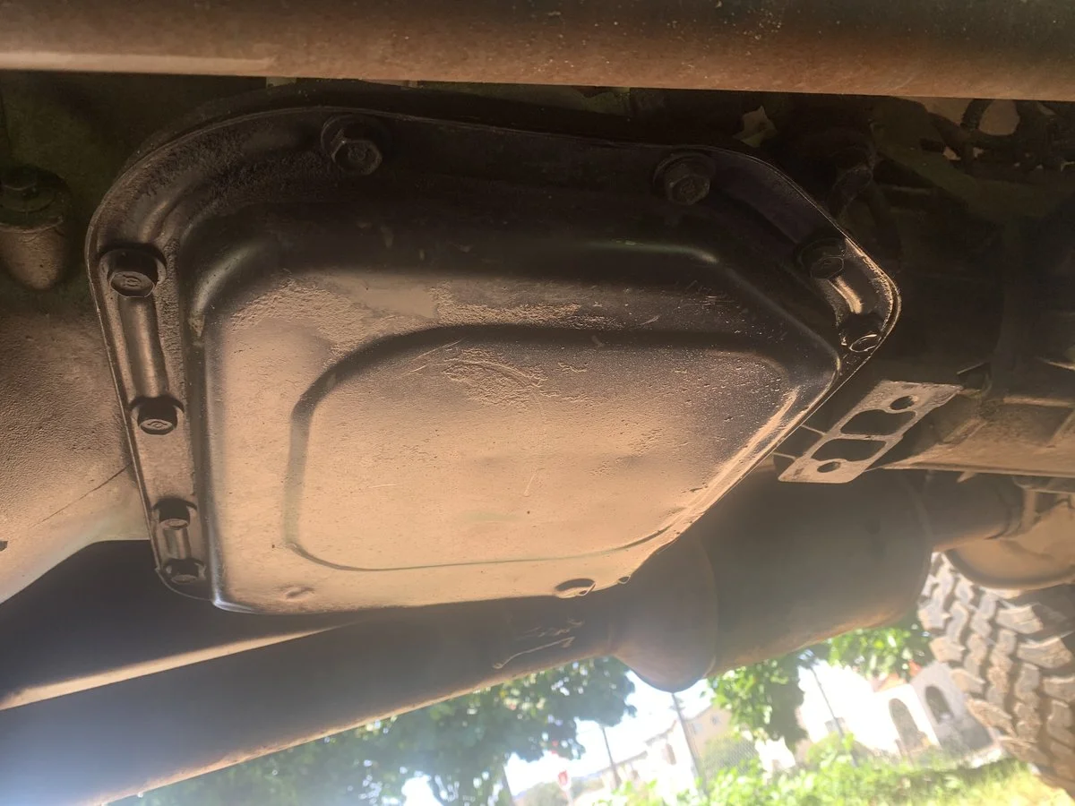

So I found out where it’s leaking from and it’s here. Transmission fluid is still good though?

Niko
Nov 1, 2019
25
Los Angeles
Hey guys so it’s leaking from here and here’s a picture of the dip stick
Chris
Administrator
Staff Member
Sep 28, 2015
45,245
Salem, Oregon
From what I can tell, it looks like your transmission pan seal is toast.
Drop the pan, flush the transmission fluid completely (that fluid looks way too dark), and install a new pan gasket, transmission filter, and new fluid as well.
