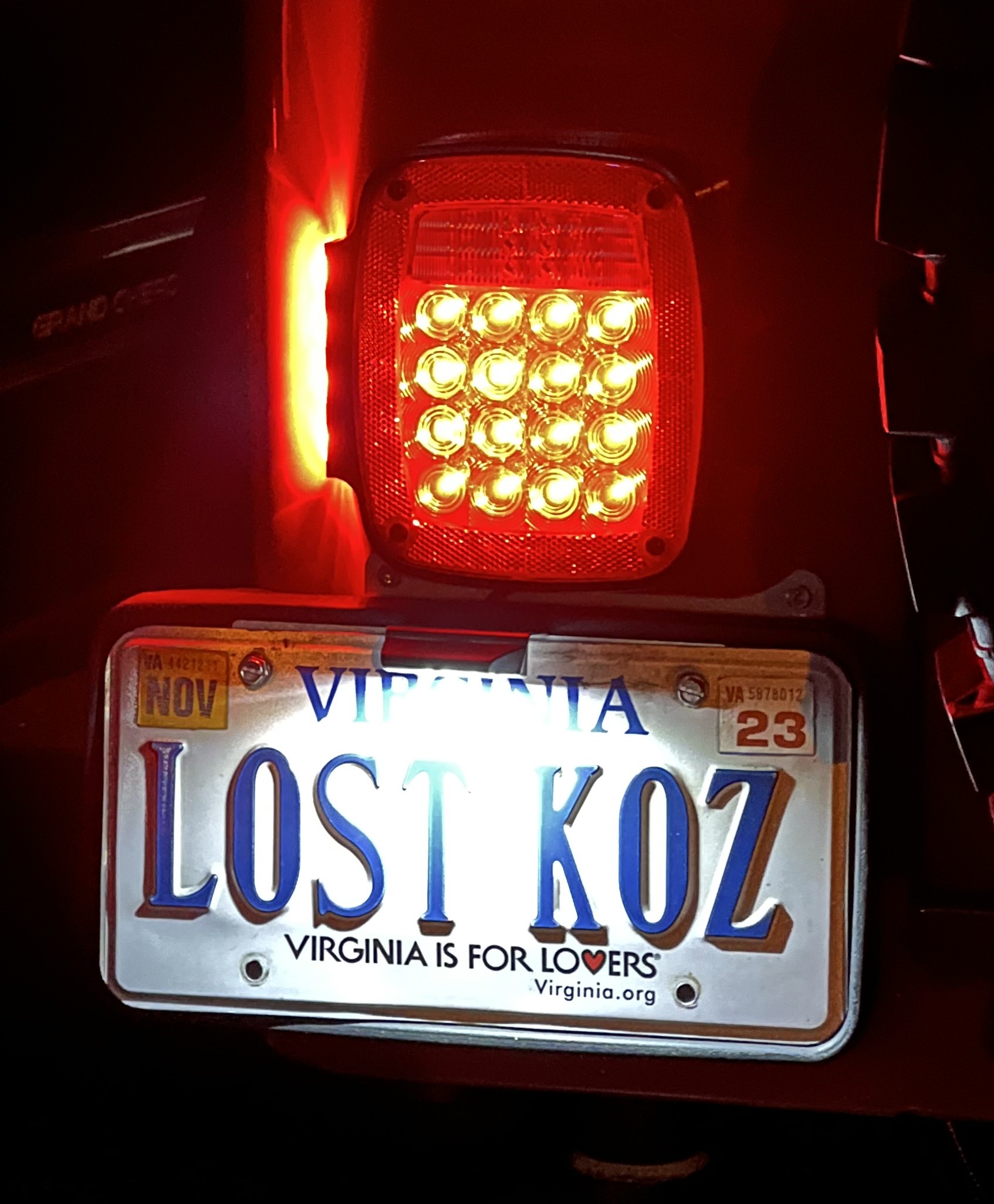

I've installed these Pair 39 LED Conversion with great effect on the rear
However the Euro Taillight Covers do not fit, as the lens isnt removeable. It has the LEDs epoxied onto it.
This is the Front: DOT Approved 7 Inch Round LED Headlights with Start-up Gradient Welcome Halo Ring DRL Turn Signal, as well as the ARB bumper signals.
When installing LEDS Front and Rear, you will want one of these as well NOVITA FLASHER 01-06TJ LM470 OLD# 37076 - this is what i used for my 04, they have specific ones per your year, its an easy search and are ava everywhere.
This will stop the Mad Blinker Syndrome. FYI, this is installed in the steering wheel column not under the hood.

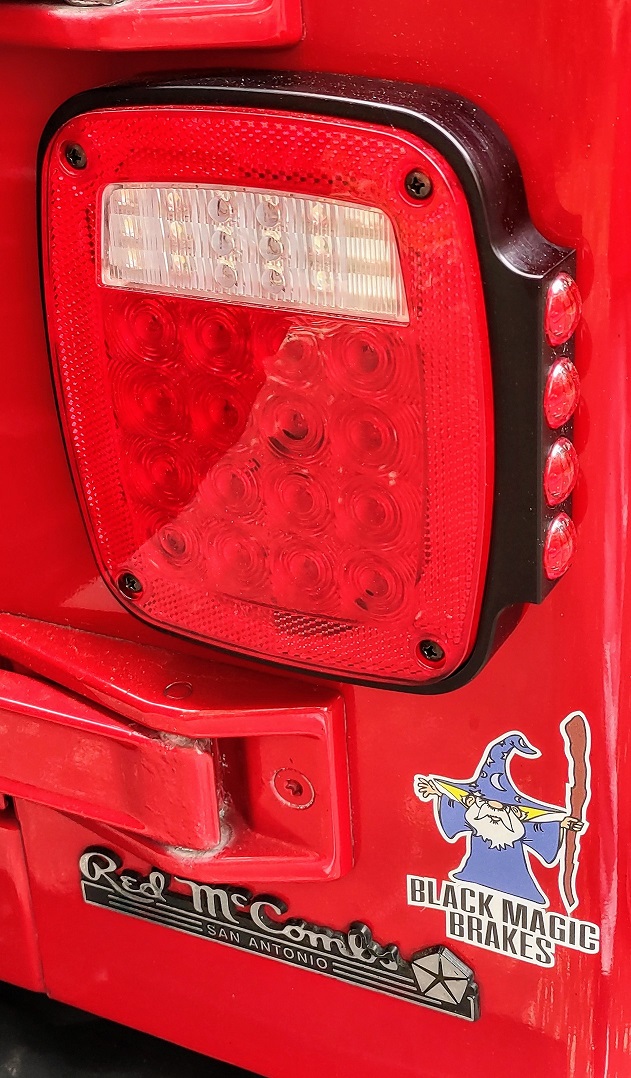

I have and like the Trail Tails. They are slim and can take a beating.
I cut the connector off the OEM tail lights and wired it to the Trail Tails so it plugged in like the OEM taillights.

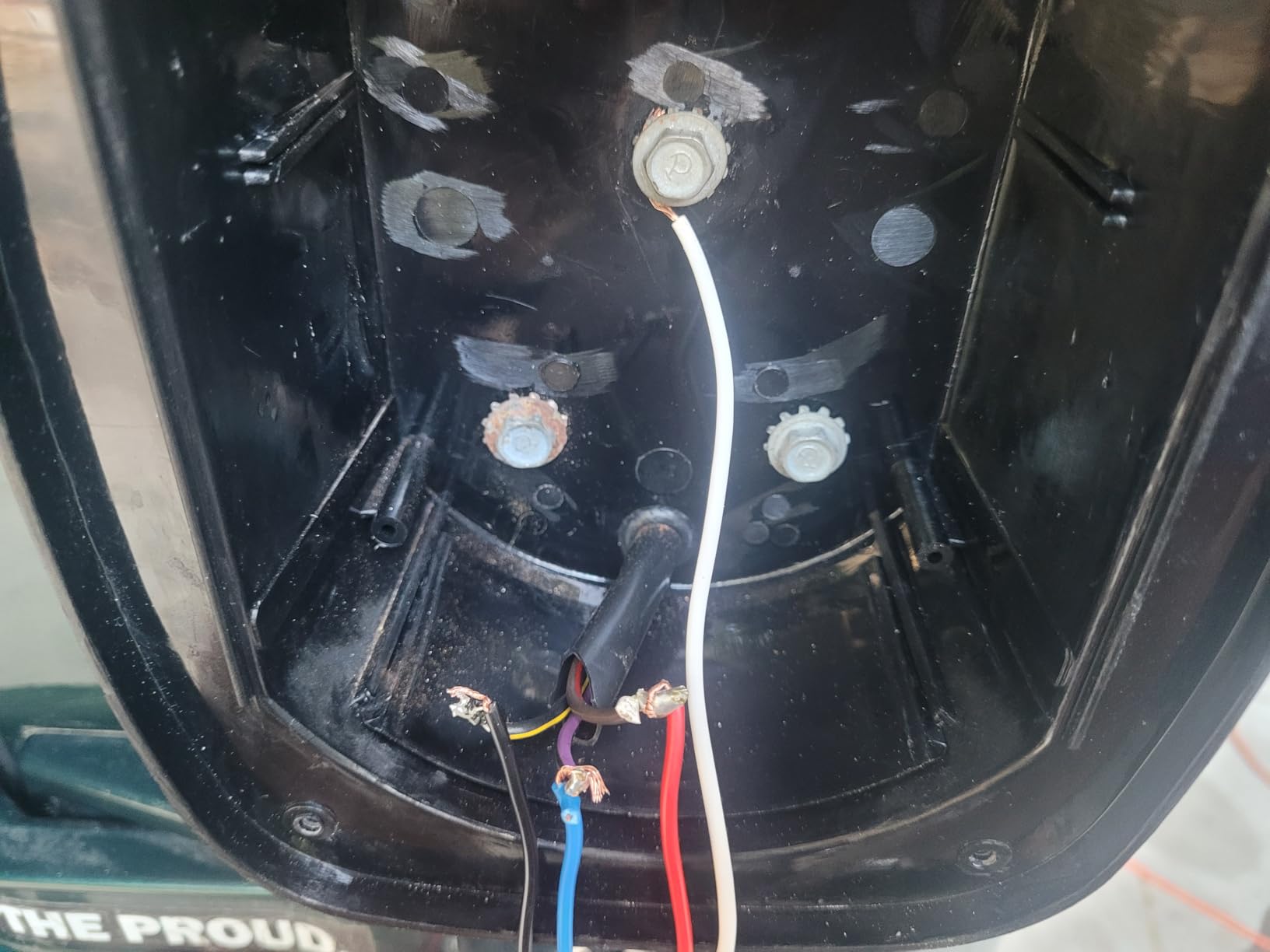

No oh god, course not, this was just an amazon pic to illustrate the correct connections for this particular unit. I should have stated that, please do not wire your stuff like this. Its just to show which wire goes to which wire for this unit.
I thought you were going to say you duct taped them properly after that pic was taken. ;)
