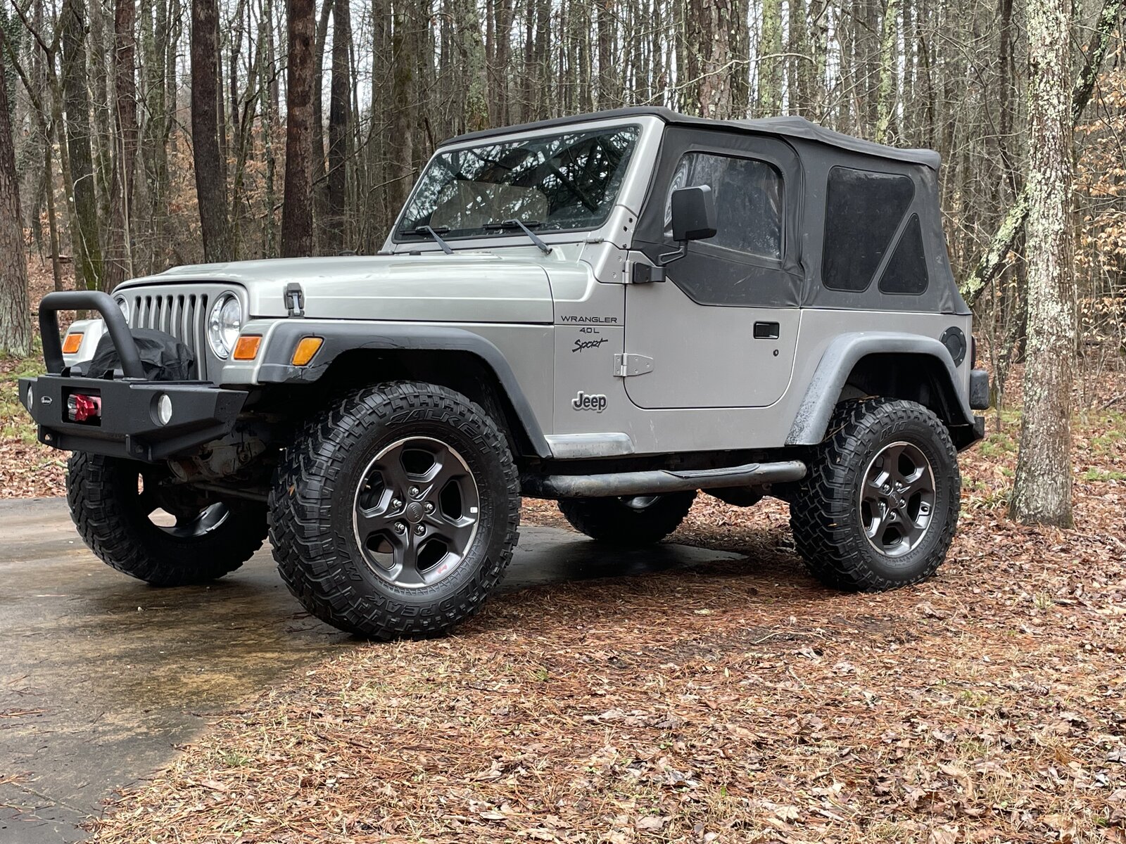

Hey guys,
First time poster here. I have a Shale Green Jeep LJ and am currently running 35x12.5x15r. I am looking to upgrade to the 17" stock JK rims. Does anything need to be addressed for me to be able to do this? Also, if you could drop some pictures of your jeeps with 17" stock oems I would appreciate it. Here is mine in its current state.
