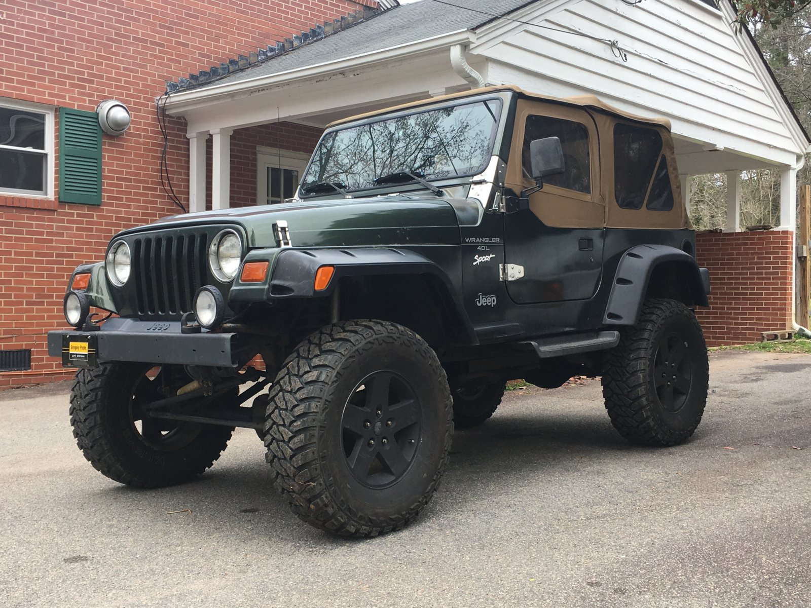

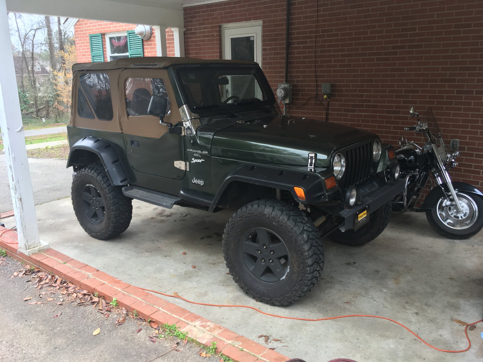

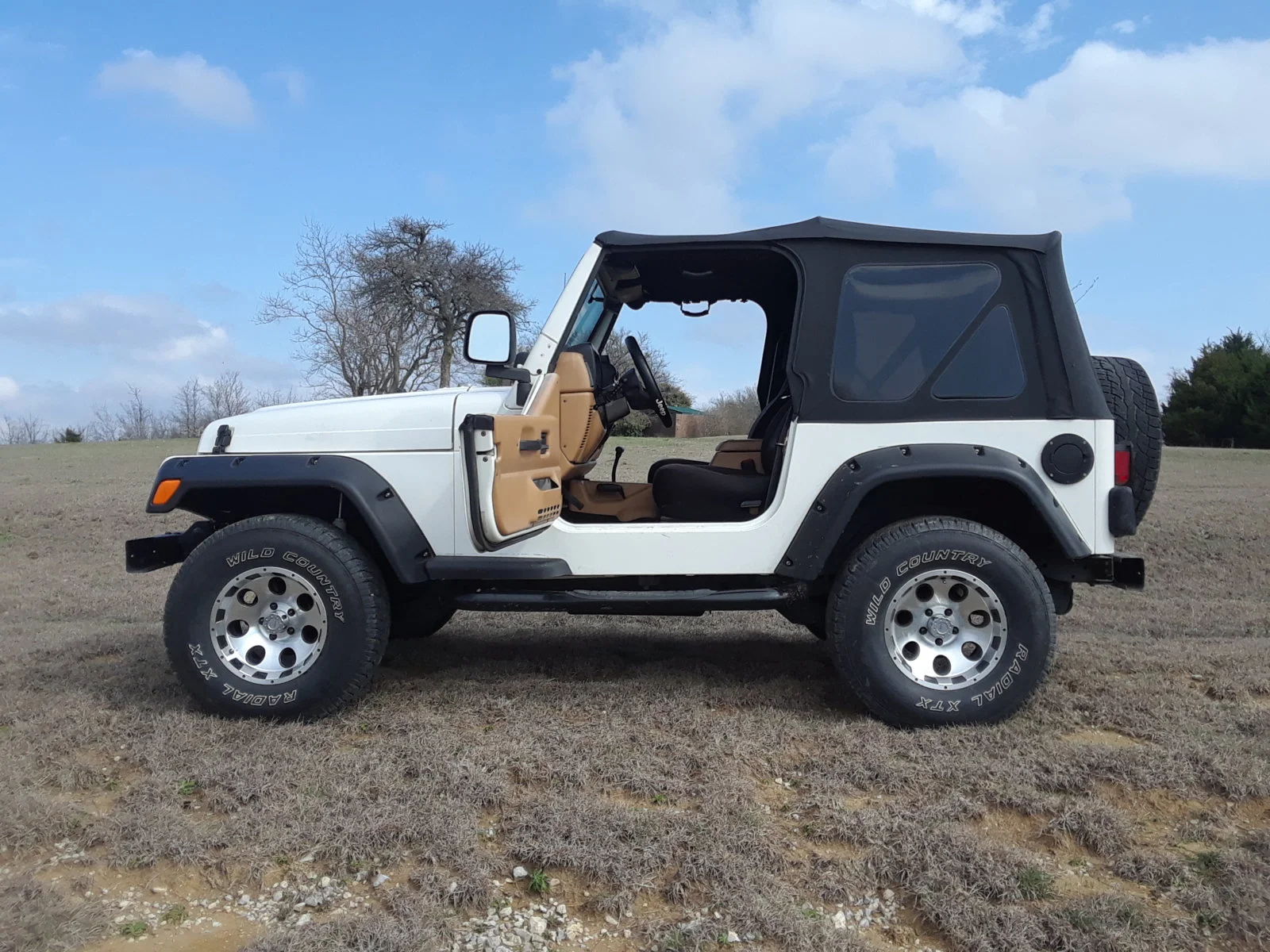

31x10.5x15 Duratrac on Pro Comp 15x8 3.75 BS
You may not air down, but an off-road tire guy told me that the problem with E-load tires on a Jeep, is when people air down, there is a layer in the 10-ply sidewalls that cracks and has to be repaired or a new tire. Not saying you have a bad tire, just saying that people should know this so they can research it.
I don't air down as in for off roading so I'm sure I'm OK. I do run a bit less pressure than I would for Load Range C tires (28 vs. 30 psi) for on the road. I'm curious though as to how a cracked side wall would be repaired.
I wondered the same thing. He mentioned some liner in the sidewall, I suppose to make it stiffer, along with the extra ply. Have no idea how you could repair that.
In further research, I can see that an E load tire would not be ideal for our TJs. They are designed to carry greater weights and greater pressures. The TJ is light. In the airing down department, people do air them down without issue, but they have to go lower to get the same footprint as a C range due to that sidewall stiffness. Most can’t accomplish this bc the TJ is not loaded down with enough weight and going to 2-4lbs might cause tire damage or loss of the bead. C load is the way to go all around nd.

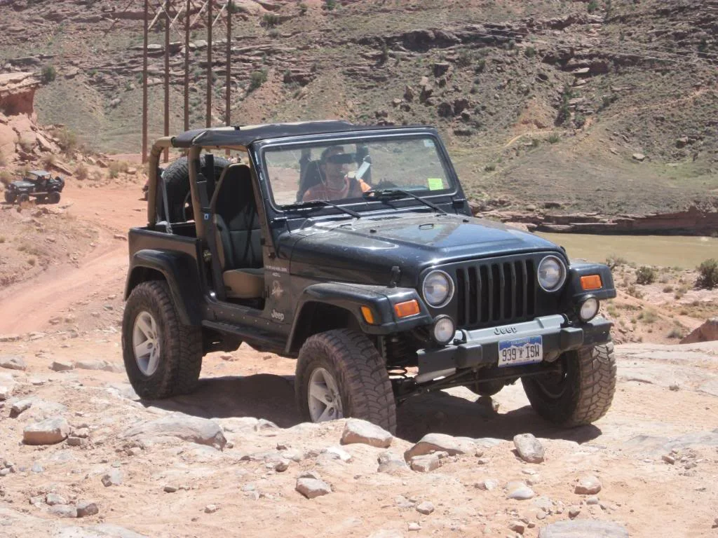

Stock MOABs on 33s
1.5" Spidertrax spacers
