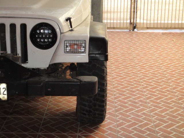

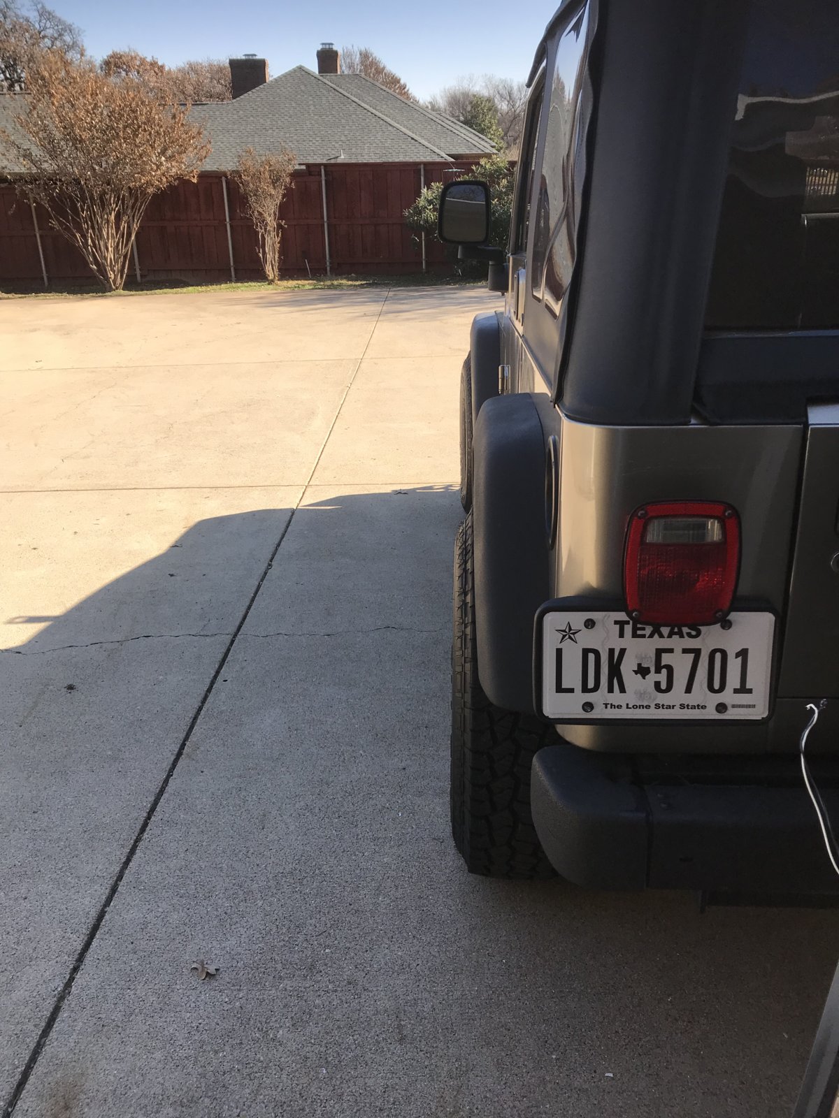

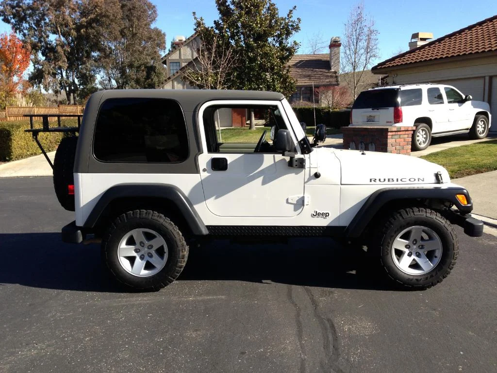

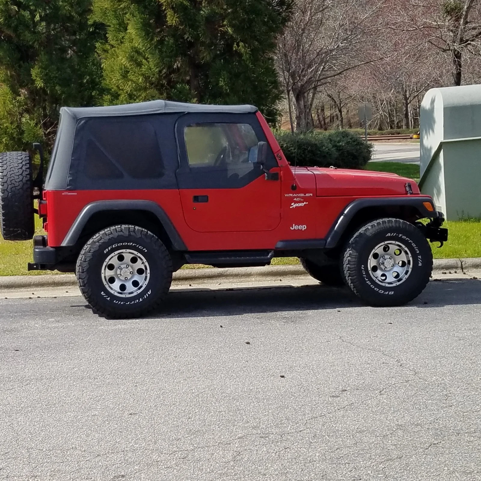

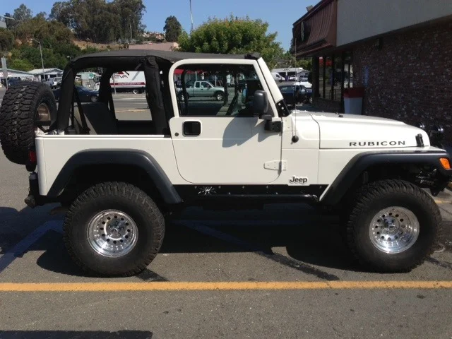

How much tire stick out are you guys getting with the rubi flares, 285.75.16 inch moab or maba mr1x wheels? I think the mr1x whhels have a 4.75" back space compare to a 5" bs on the stock moab wheel. I borrowed a set of 285.75.16 mr1x wheels from a friend that has them on a JK and could exactly mount them as they are a 5 on 5 bolt pattern but sheesh it doesnt look like ill fit this tie wheel combo and pass PA inspection. Our state requires full tread coverage. I was already told if i come in with 1-2 inches past the flare, he'll fail it. Jere are a few photos. I dont have rubi flares and if my math is right with rubi flares ill still stick out 2 inches past the flare. Anyone have a direct down the side photo that shows how much goes past the flare?

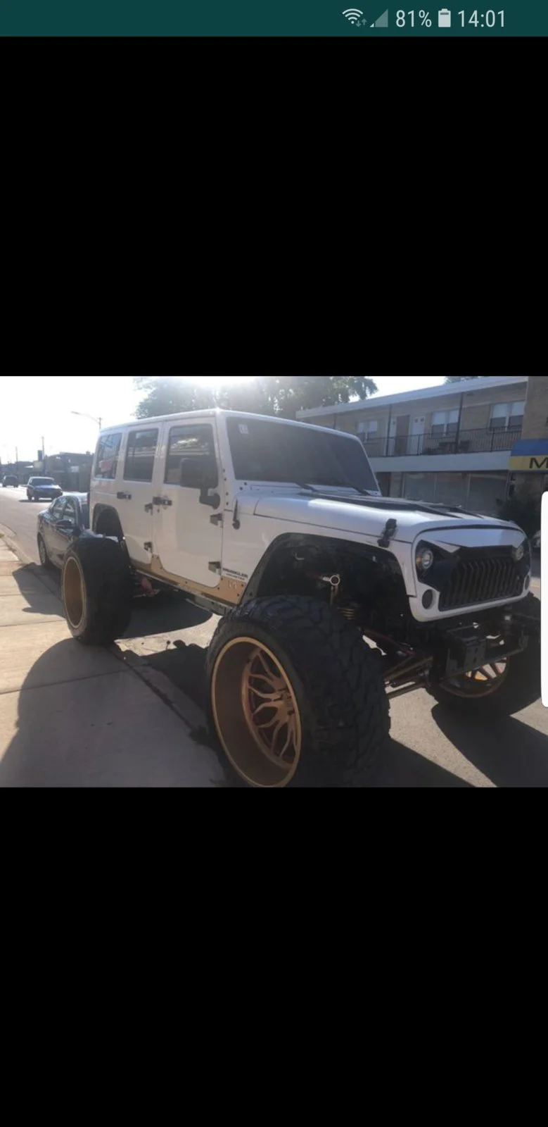

Do it and will look like this, lol
This thing is been on the market for months in Chicago and it asking price is 60k 🤮🤮

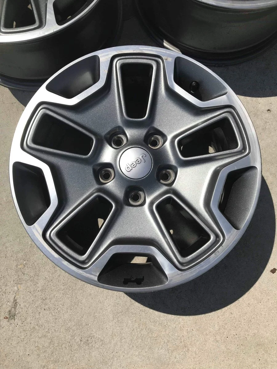

What do I need to put these wheels ,17” Jeep Rubicon Wheels, on my 06 Jeep Wrangler X ?
I will be running 33” tires and an OME Hybrid lift from DPG as well.
Don’t mean to hijack , if I need to start a new thread please let me know.
