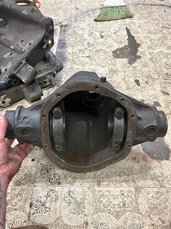

If you want a HP rear axle this would be one way to go about it..... This sold already but you can find them like this now & then... Plus the 77-79 HP44 axle out of a Bronco/F150 had the cast in radius mounts on the axles. So they aren't as desirable. . Retube it and make your own HP44 rear axle.

At one point I was looking at doing something similar, but ended up finding a CJ offset flanged 44 and gave up. It's been a little bit, but I thought the dimensions on a JK rear 44 worked out to allow narrowing only one side to get the correct offset and width.
Some of the cj2a page guys have been playing around with rear steer too.
