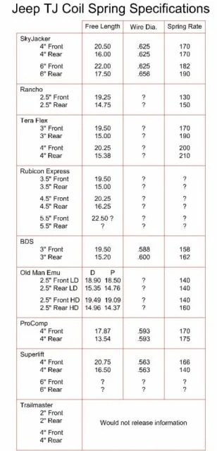

I found this formula online while reading up about springs...I've taken a class about springs (more than one, really), but have forgotten more than I remember...Anyway, if I could get actual pictures of each of the springs I'm looking at and some measurements, I could calculate the pertinent information myself...of course, I'm not sure what I'd do with it, as I don't know what the design considerations were originally...
http://www.bluecoilspring.com/rate.htm
Believe it or not, I used to make springs...of course, they were tiny little suckers used in valve lash adjusters but still...
Slippery slope. Springs need to keep your jeep at a certain height without it riding like a dump truck. it is my theory that finding a spring with the least in.lbs. of spring rate that maintains the lift height advertised would be my choice.
All other things being equal, more active coils means a lower rate. Also, smaller diameter wire is a lower rate. Its all a balancing act tho, as the more coils you add, the less travel you get before coil bind. Start pulling coils out, internal stress in the steel increases and it will shorten the life of the spring (whether that shorter life is practical is another question).

Found this over on Pirate...take it with a grain of salt...but interesting nonetheless.

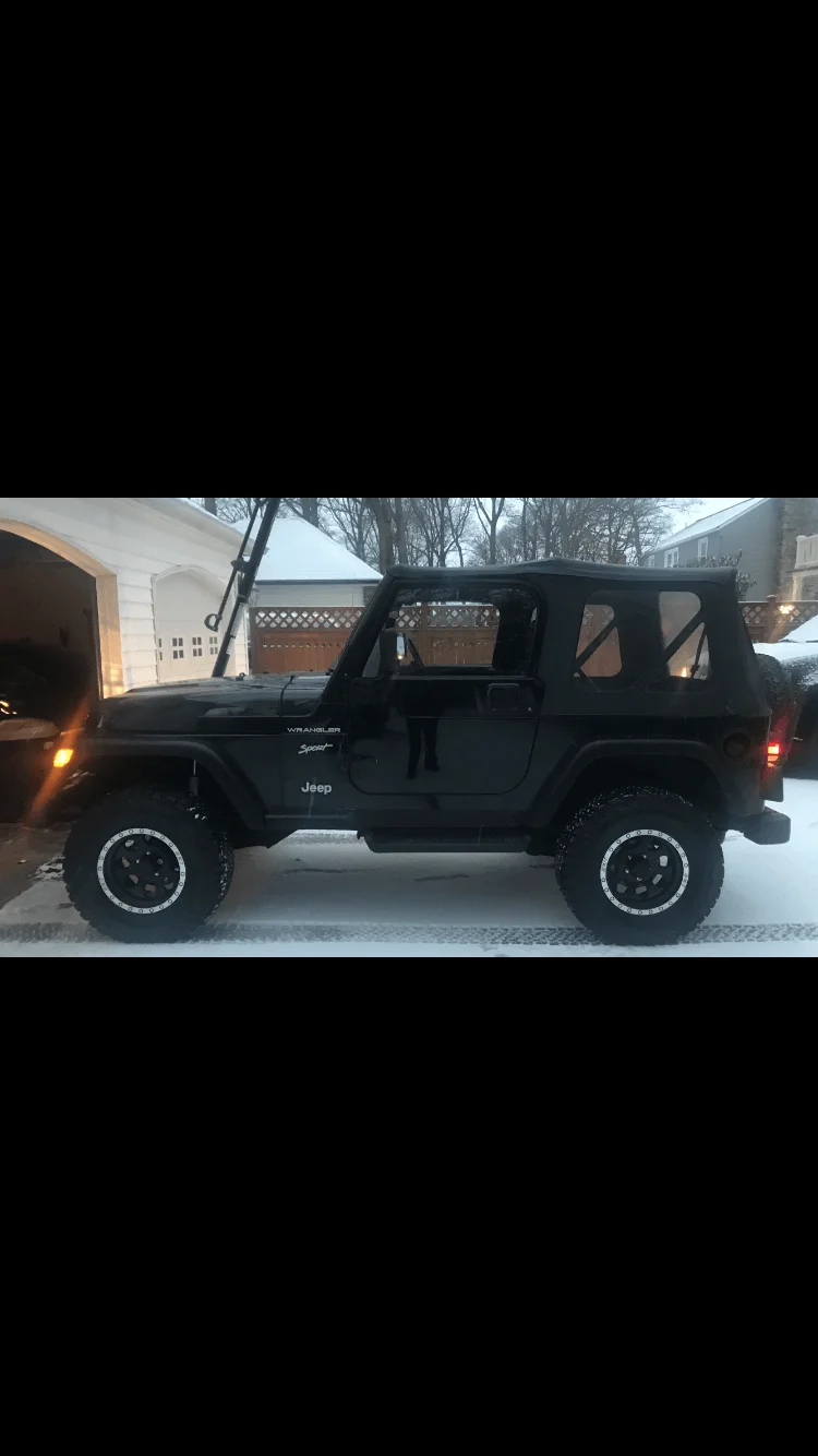

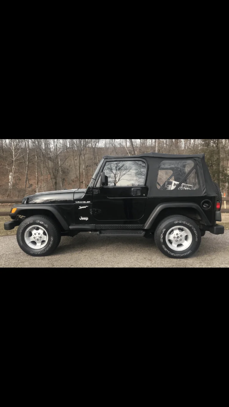

Before:
After:
With 31" BFG's. Measurements after were almost 3" higher but I think they may have to settle.
