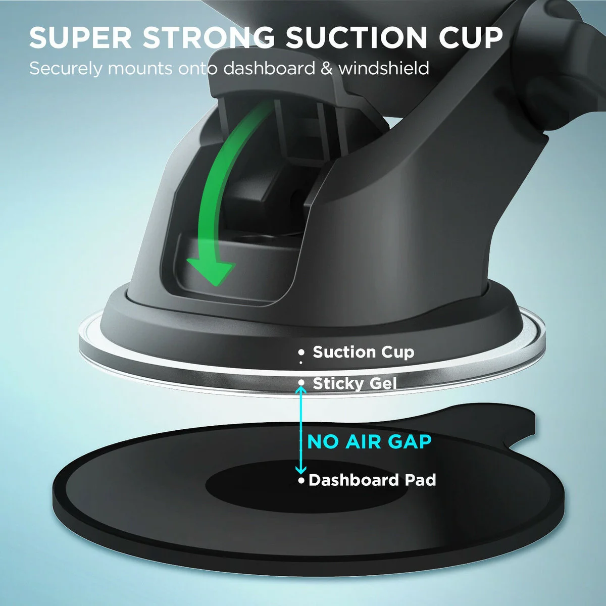

Looks like good stuff. I haven't had good luck with suction cups in hot (90's )and especially in cold (around 0)weather.
If you get one with the extra round rubber plate to mount them on they work much better. There called a dashboard pad. And can be bought separately. The iottie cellphone holders come with them. At least version 2 and above IIRC. They are the most versatile cellphone holder I have used. Although I'm trying out the magmount this week. We'll see. When working I need something that is not permanent. So the magmount is only going in my Jeep. If it can hold my cellphone with the cover on.

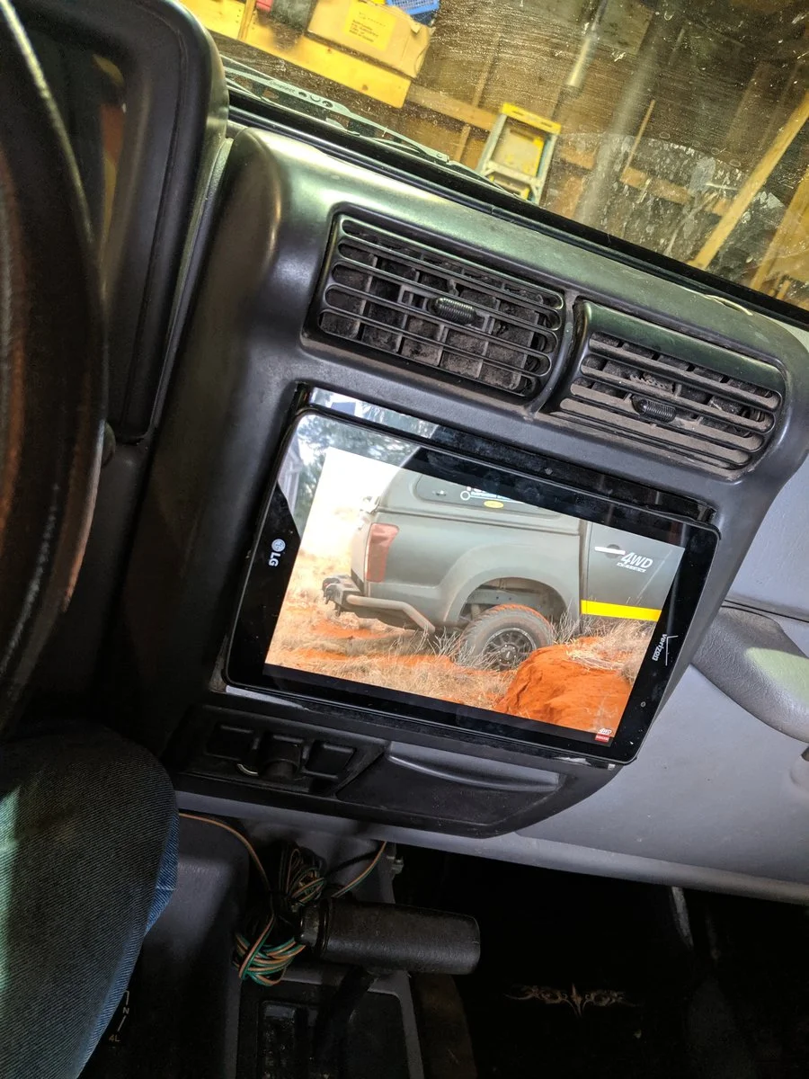

heres my set up, bent some plex glass and expoyed into place. its a lg vk815 (verizon freebee) it does cover the hvac controls but that doesnt bother me.
How do you adjust your ac/heat?
I mounted it on an angle so I just reach up and switch it. Not ideal and could be mounted higher of course. The Plexi was originally made for a s10 and it fit well where the radio was in the tj. And used a cheap case to epoxy to the Plexi, the hardest part is to heat the Plexi up just enough to bend and not create bubbles so a few test pieces and some spray paint it comes out looking pretty good
