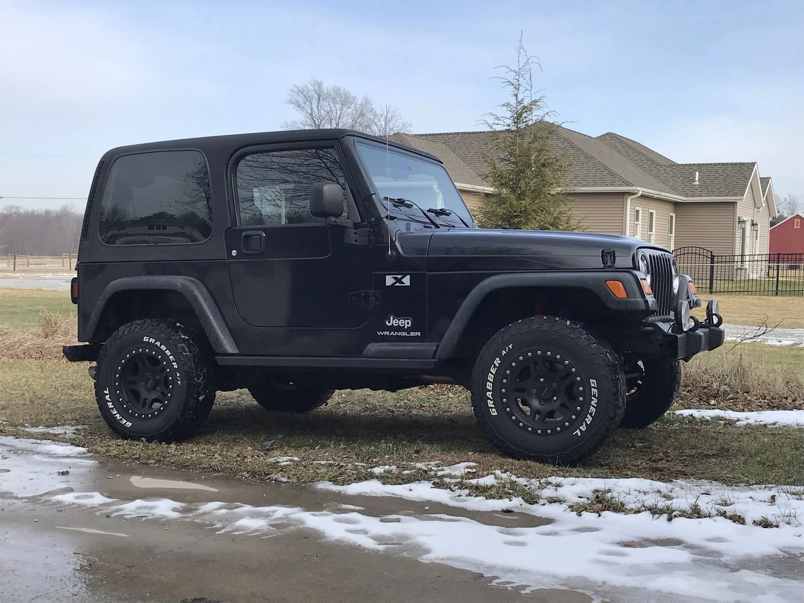

I put H&R springs with Rancho RS5000X shocks in. Originally I put a 3/4” leveling puck up front, and then added one in the back as well. I’m netting about 1.5” lift like this. With the hardtop, rear dirtworx bumper, and rock sliders it only gave me 3/4” lift in the rear before the leveler was added there. If I knew beforehand, I’d do 2” springs and call it good. It looks kinda small on 30s now, so when these wear out, I’ll get 31-32s and regear. A lower profile transfer skid is in order also.

looks kinda small on 30s now, so when these wear out, I’ll get 31-32s and regear. A lower profile transfer skid is in order also.View attachment 221385
I like the looks, very proportional.
What rims are those?

The rims are pro comp la Paz or something like that. I think they discontinued them, which really irks me because my full-size spare doesn’t match.
