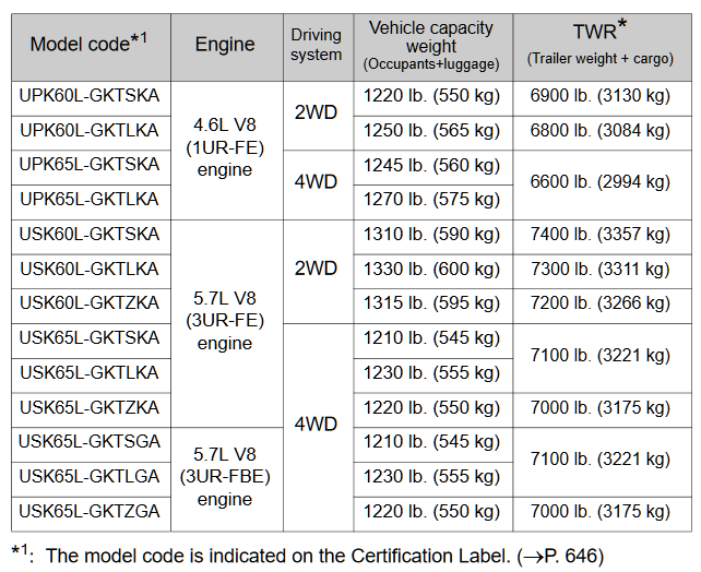

Looking at getting a new vehicle, needs to check several boxes if possible. It'll be my "daily driver" for driving across the metroplex for softball tournaments, buying jeep parts in south Dallas, etc. And my wife will be driving it, so it needs to ride nice, which currently my JKU does not qualify LOL. And neither do the TJs. I have 5 kids, so having a 3rd row would be ideal, which precludes any sort of pickup truck, which I don't really want anyway. I've found some options, mainly in the Toyota/Lexus family, but I need help understanding towing capacity.
But let's start from the back end. The desire is to trailer my 97 TJ to the trails. I don't have a trailer myself, but obviously I can rent one for the handful of times a year I would need it. I don't have a place to store one so buying is out. And I have a friend with one that I could borrow in a pinch. The U-haul car hauler weighs 2210lbs. Looks like the TJ weighs close to 3300lbs. I have aftermarket bumpers & sliders, which adds an additional 190lbs. So call it 3500lbs, or 5700lbs in total.
Using the 2011 Sequoia as a working example, the 4.6L V8 4WD states it has a towing capacity of 6800lbs, so before doing anything else, it would appear that I'm 1100lbs (almost 20% under max). Having exactly zero experience towing, I don't yet understand curb weight GVWR tongue weight (actually I do understand that one) etc, but this chart would suggest that I'm good to go at 6800lb capacity even with 1200lbs of cargo in the towing vehicle.
In situations where I would be towing, I would likely only have me in the car, or me & maybe 2 kids. I carry some tools & parts when we go, but I would still be well under that 1200lb figure listed in the vehicle weight. So I say all this with the understanding that based on stuff I've read here, the numbers get more complicated in ways I don't understand yet. This is where you educate me.

Based on your needs and the fact you mentioned Toyota, I’d say a sequoia is a great choice. IF you can find one with a high enough GVWR.
Tow capacity is kinda a BS made up number and doesn’t really matter legally in most cases. The biggest thing that will matter from a legal standpoint is Gross Vehicle Weight Rating, Axle Weight Rating and tire weight ratings. Ideally you’d be under all those to be safe in a legal aspect in the event of a crash.
GVWR tells you what the total weight of the vehicle can be that includes passengers, gear, tongue weight of the trailer and anything else put into the vehicle besides how it rolled of the factory line. It does include 150-200lbs for the driver already.
GVWR are made up by the manufacturer and the formulas they use to get to those numbers are not consistent between manufacturers.
Axle weight ratings tell you what the axle was designed to support. Same goes for tire weight ratings.
To figure out your GVWR and Axle ratings when all loaded up will require scales. I use the CAT scales you can find at gas stations.
For GVWR add up whatever passenger weight over 150-200 pounds plus whatever gear or tools you put in the vehicle or Lods done to the vehicle. Once you know that you can get an idea of what your new “curb weight” is.
For example I have a 2018 Ram 1500. It’s a GVWR of 6,900lbs and has 3900 axles front and rear. In stock form I had roughly a 5,600 lbs truck which left me with 1,400 lbs of payload. I’ve added about 400 lbs to the bed of the truck through drawers and a camper shell so that brings my payload or GVWR capacity to 1,000 lbs before I hit that 6,900 mark.
When I tow my Jeep (4,500lbs) on my trailer (2,000lbs) that adds about 650 lbs to my GVWR. Meaning I have 350lbs to spare for passengers and gear to remain legal. I don’t particularly worry about being over GVWR for worrying of breaking something but should you be involved in an accident and you’re at fault, and it can be proved you were over GVWR, there can be some legal action taken against you for that.
In that same scenario, my rear axle capacity is 3,900 lbs and as my truck sits the rear axle weighs 2,700lbs. Add in the 650lbs for the trailer and that increases up to 3,350 which is well below the 3,900 rating. My tires are rated for over 3k lbs each so no worries ever there.
Hope that helps paint a picture.

Like I mentioned I wouldn’t worry about tow rating much. For reference in Ram trucks you can find tow ratings for the exact same truck for anywhere from 6,900 lbs to 10,400 lbs depending on what gear ratio it has. For you I’d look for the biggest engine, a sequoia with the 5.7 and the biggest gap between curb weight and gvwr or “payload rating”. On the driver door jamb will be a sticker that tells you how much weight can be added to the vehicle before you hit max gvwr. If it’s 1,000lbs or more you SHOULD be okay but you’ll have to figure out the math on your own to know for sure.

Ok on that particular vehicles curb weight is 5900lbs, GVWR is 7300lbs.
So is the math actually simple here?
GVWR - curb = how much cargo
Tow rating is how much you can haul?
I swear I’ve read threads where it’s waaaay more complicated than that.
If the curb weight is actually 5,900 lbs then you’d have 1,400 lbs of gvwr capacity to play with. Subtract any passenger weight, gear and any thing else added and roughly 600 lbs for the trailer and as long as you’re not at 7,300 lbs then yes that’s a good vehicle as far as gvwr is concerned. If it was me I’d look for a sequoia with a bigger engine which should have a higher curb weight and possibly a higher gvwr as it’ll have a easier time pulling the weight.
But if the tow rating is higher than the weight of the trailer, the gvwr is higher then load and the axle ratings and tire ratings are higher than the load then you’re all good on a capacity and legal stand point.

7,300 - 5,900 leaves you with 1,400. (Assuming it actually weighs 5,900lbs, I say that because that is often misreported by manufactures on a individual vehicle basis).
1,400 - 600 (trailer) - 400 (passengers and cargo) would leave you with 400lbs as spare room in terms of gvwr capacity.

Calculating towing capacity can be confusing as manufacturers sometimes use different terminology such as TWR shown on the chart you attached. I see you have the Toyota's GVWR number, which is the maximum total weight of the towing vehicle including occupants, cargo and trailer tongue weight. Is there a GCWR number for the Toyota? That number is the combined weight of the loaded tow vehicle, including trailer tongue weight,(GVWR) plus the weight of the loaded trailer itself , adding both together, to equal GCWR. It is the maximum combined weight of the loaded truck and loaded trailer together that should not be exceeded. For example, my F150 has a GVWR of 7000 lbs, a GCWR of 14,000 lbs. I can load my truck up to 7000 lbs max and then tow up to 7000 lbs max to hit the max GCWR of 14,000 lbs. If my loaded truck only weighed 6000 lbs then I could tow 8000 lbs. If you can get a GCWR number on the tow vehicle then you can do the calculations and ensure you stay safely within the overall combined weight limits.
