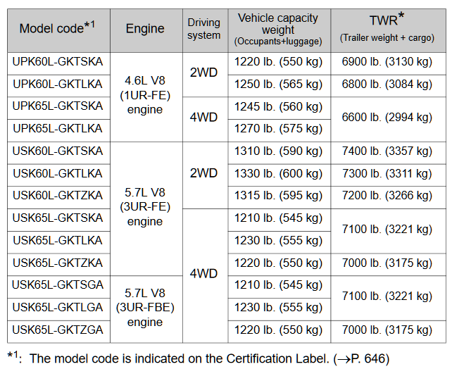

Using the 2011 Sequoia as a working example, the 4.6L V8 4WD states it has a towing capacity of 6800lbs, This is where you educate me.
Disregarding manufacturer specifications and ratings when it comes to towing isn't necessarily going to bite you in the rear, but it could, should you ever find yourself in even the slightest of fender benders. Knowing which model you have and following those printed ratings is not just a casual suggestion. Can you get away with ignoring them? Sure, people do it all the time but that doesn't mean it's safe or legal.

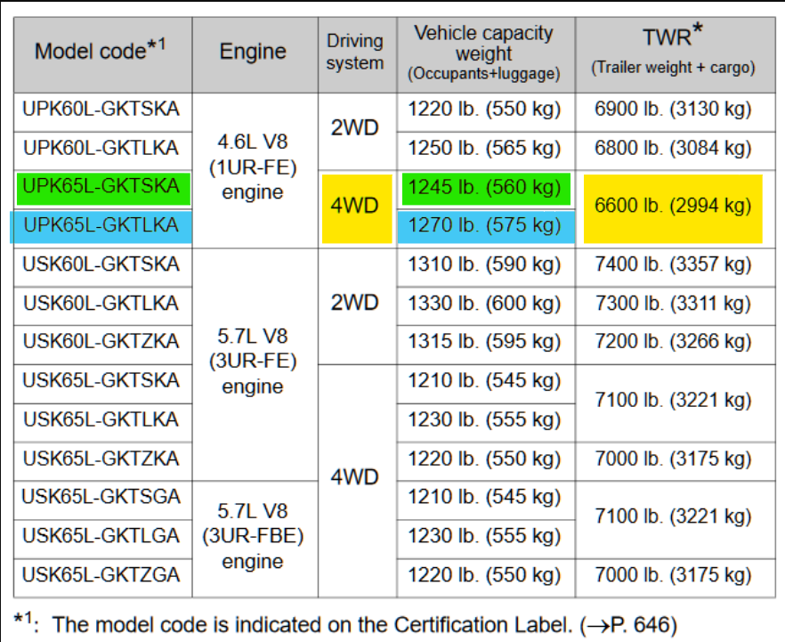

You said you were looking at the 4WD model and stated it's TWR (Trailer weight + cargo) as 6800 lb. The 6800 lb. is for the 2WD UPK60L-GKT(L)KA model which comes back as an Automatic Limited. The UPK60L-GKTSKA model is the lower class model with less options. (which translates to a lighter vehicle.)
Both of the 4WD models have a 6600 lb. TWR (Trailer weight + cargo). Armed with that information you can caculate it fairly simply. If you are by yourself (no tools or gear) and you weigh 200 lb., your trailer weight can not exceed 6400 lb. per the manufacturer's ratings. Maximum tongue weight is going to be determined by the type of hitch you use and what it's specific ratings are. eg.. Using a weight distribution hitch is going to allow for heavier tongue weight, but that will not change your TWR.
Diving into the why the 5.7 has higher capacities than the 4.7 is a pointless endeavor since the TWR is at most 500 lb. different. Without digging into what axles came with what engine it's hard to say if they use the same gear ratios, brakes, or bearing sizes in the axle housings...
This doesn't relate to the Sequoia but it does show how lighter vehicles are rated to tow more than the same vehicle with more standard options.
All that said I'm not real fond of the way NTSA/DOT set the standards for rating vehicle towing capacities. The way the system is set up a 2wd 3/4 ton standard cab with 8 foot box pickup can legally tow a heavier trailer than 1 ton dual rear tires standard cab 8 foot box (GTWR). However the 1 ton with duals has a higher GCWR because the truck itself can carry more weight...

Gvwr 6600 - curb weight 5150 leaves with 1400. Take off about 600lbs for the trailer tongue weight and that leaves you with 800lbs for people and cargo. Assuming the vehicle actually weighs 5150 and not more.
Plus your tow capacity is more than the trailer weight so you should be good and you shouldn’t be anywhere near your axle ratings.

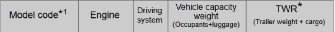

I was referring to the chart you posted in your first post on the thread. Is the Lexus rated the same way specifying a TWR?
