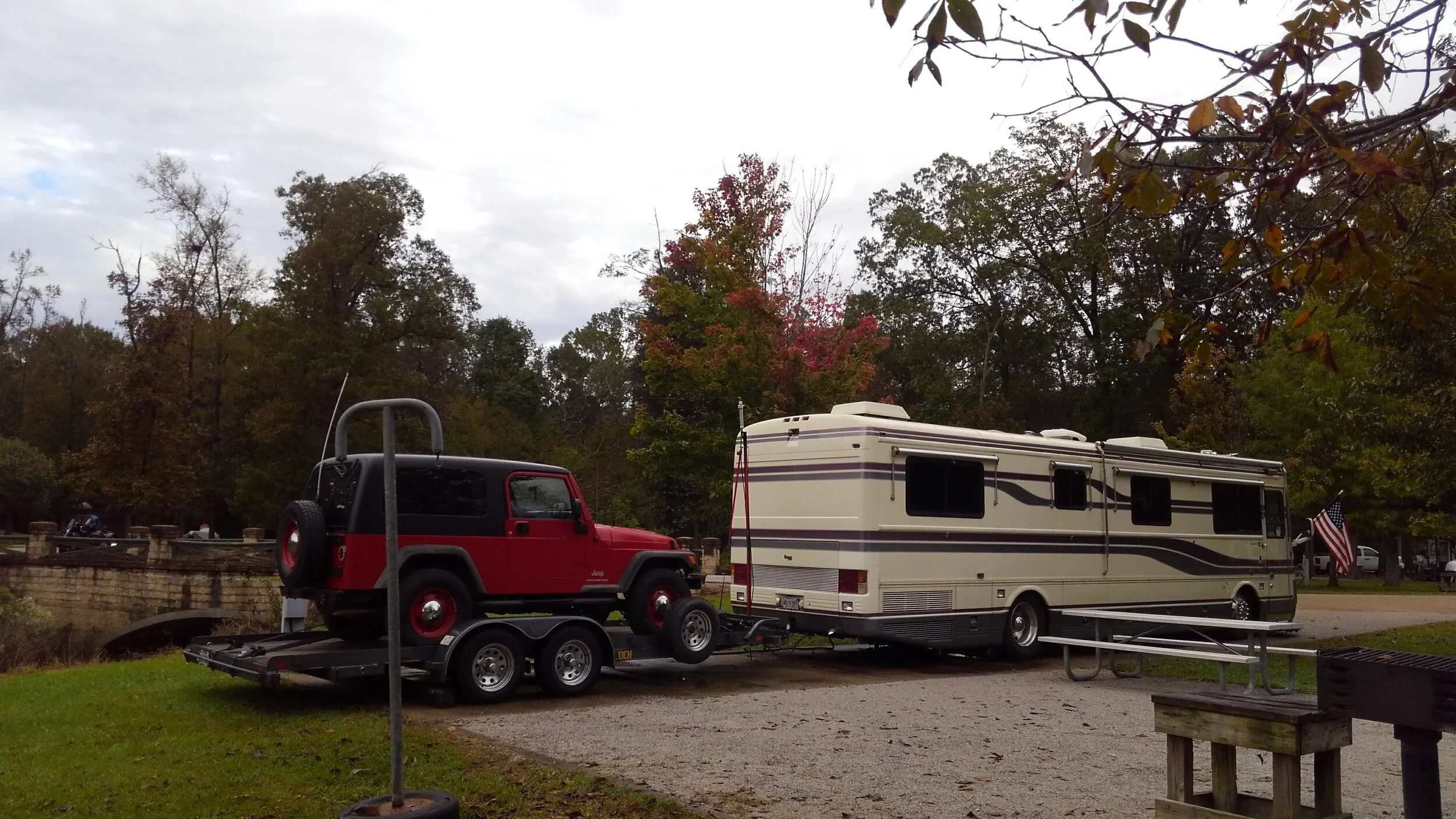

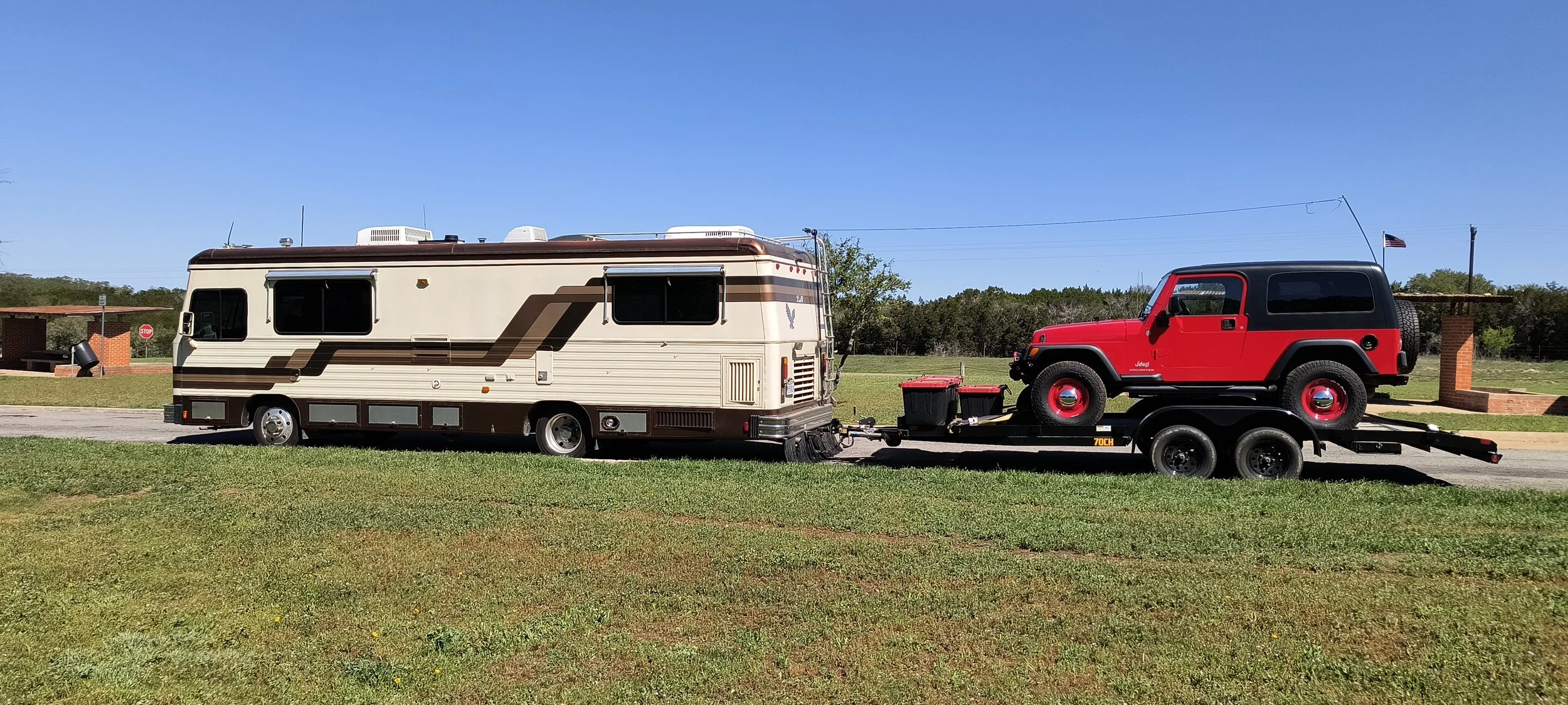

This is our second Big Tex car hauler . So far they have been smooth pulling trailers . We sold our first one with the motorhome after 6 years and putting 60,000 miles on it and no issues with the trailer . It had an 18 ft bed . Our new one has a 20 ft bed and was bought in 2020 . We bought a longer trailer , but a shorter motorhome . I prefer to trailer the Jeep . If we or someone with us breaks something trail riding , we can get the broke Jeep home . It's also really nice to be able to backup , which is not possible towing with a tow bar . I would rather wear out trailer tires and wheel bearings than the Jeep's .
The old one is the grey one and the new one is black . Currently we only have one axle with brakes , but I am going to add brakes to the other axle . The trailer brakes definitely help us get stopped .

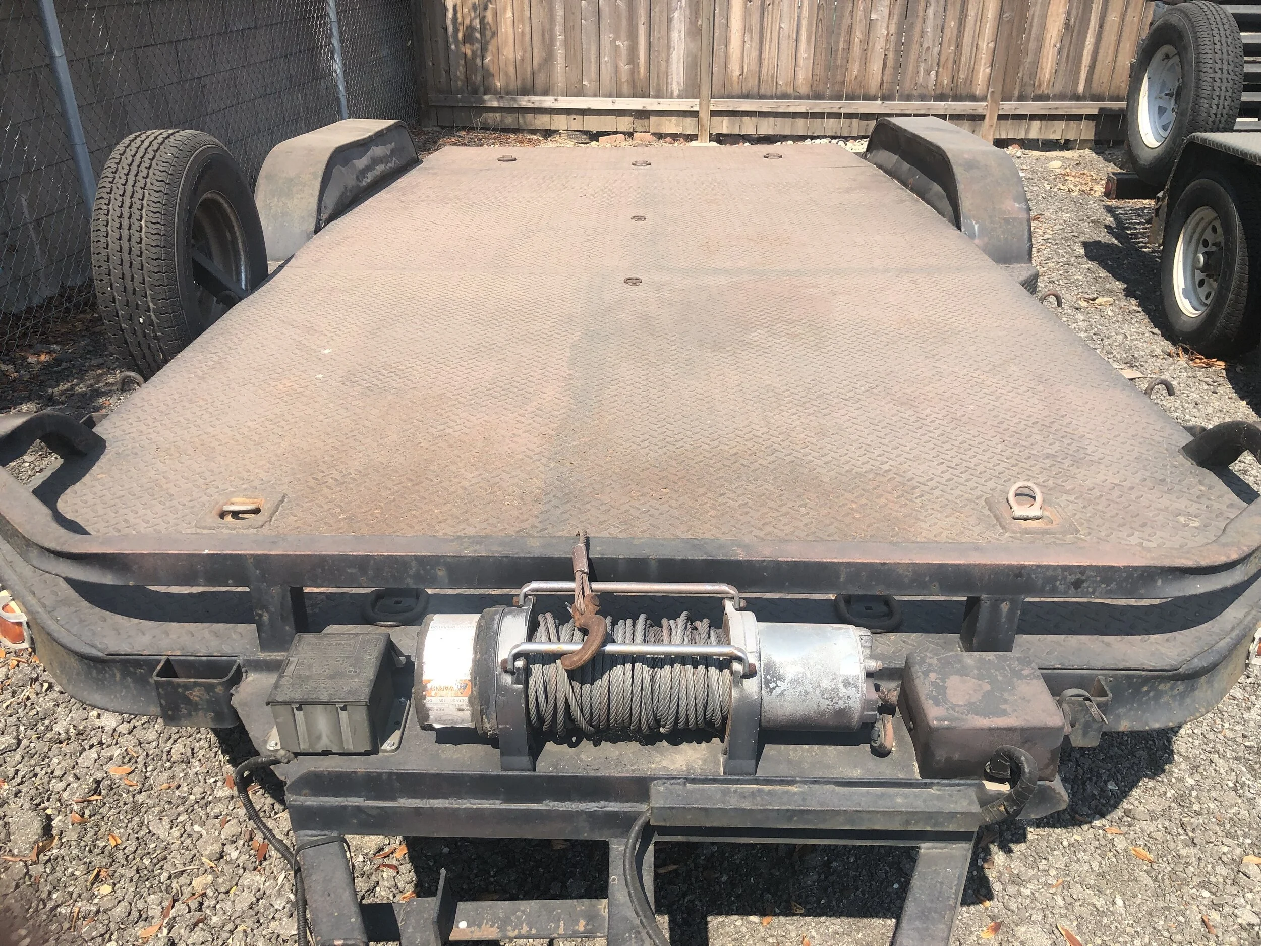

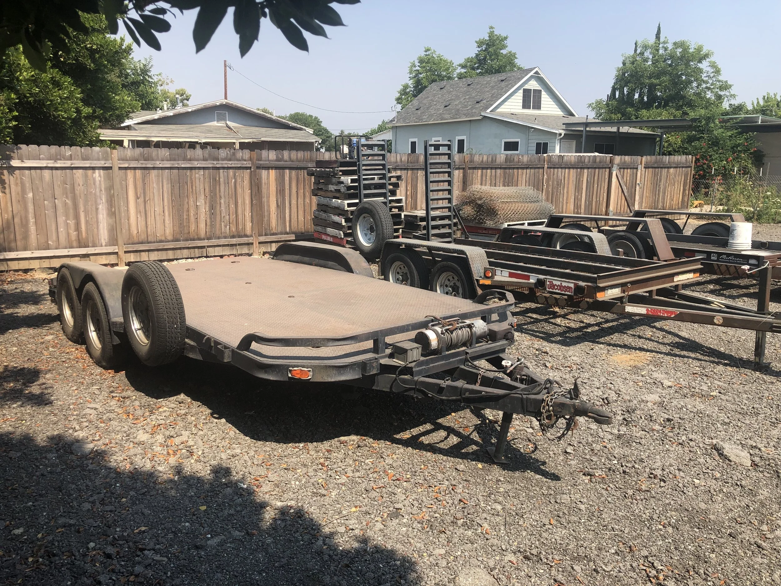

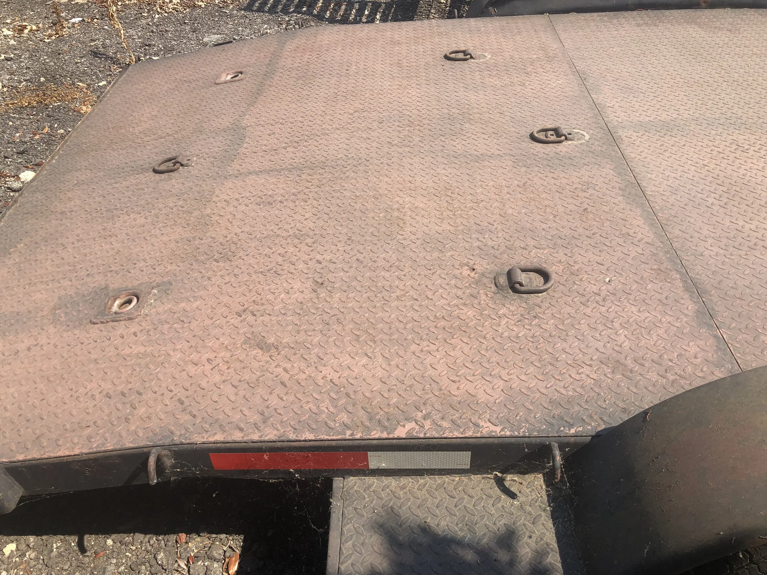

Nice find for $5K.
Yes, was lucky. Also wanted something lighter. Had a Load Trail 5th wheel that was heavy duty but weighed about 5500 lbs. More than the Jeep !! The wolverine is more like 1500 lbs., big difference and pulls great. (19 Ford F250 diesel crew cab)
