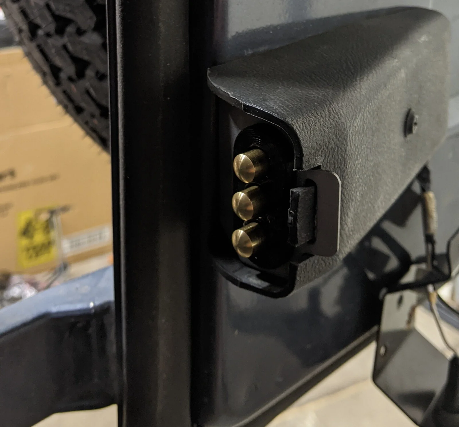

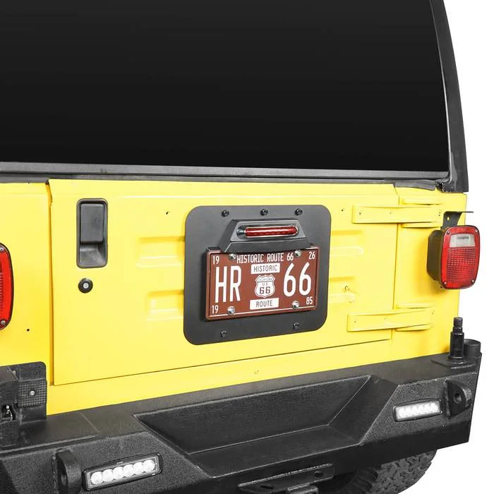

I'm thinking about deleting my spare and relocating the license plate and of course the license plate light wire is a minor issue. Here is the path I'm on so far to address it. My question, for anyone that has done this already, is there value in custom door jamb contacts to support the brake light and license plate or is a wire "good enough"? Are there any other options today other than running the wires from the tub to the tailgate?

If I were going to do that I would probably keep the factory wiring, flush the gate and French in the plate, plate light and 3rd break light. I don’t have any pics but it’s we used to do on mini trucks( I know, they suck) back in the 90’s. Only thing I would change is it wouldn’t be crooked, it’d be centered

I’ve seen some nice ones with the license plate centered on the rear tailgate with armor. I’d like to put mine in the center, but right now it’s wrapped on the side. Can’t say enough good about the spare delete.

We wire up the little lights for spare mounted plates quite a bit. We use the two factory contacts as hots for 3rd brake light and license plate light. We pick up the ground through the hinge by grounding to the gate. Hasn't not worked yet. Much easier than adapting that Dakota Digital stuff in there.

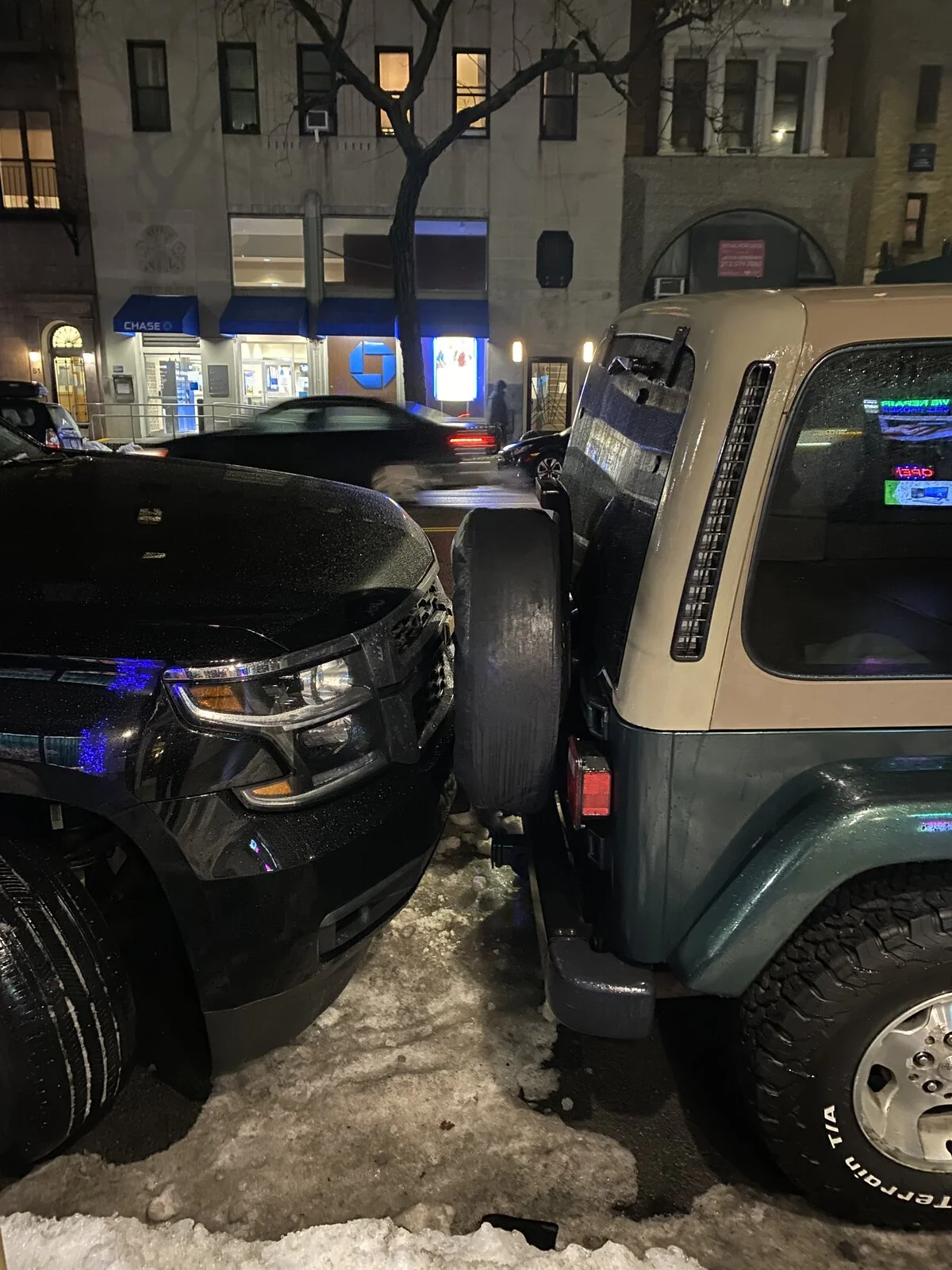

I go back and forth about removing the spare for this exact reason pictured. Do I remove the spare and gain a few valuable inches in overall length to fit into a smaller spot? Or, do I save some body damage from A-holes that park this close by keeping it? NYC parking problems most of you wouldn't understand but I switched from a big ass Yukon Denali to a Wrangler so I can find parking in a fraction of the time. Not the primary reason but it was a factor.

You'll get body damage with a bowed in tail gate when they hit that....
But no spare = bad day, some day

Where are you going to put the "Coms" antenna?
Looks clean. I like it.
