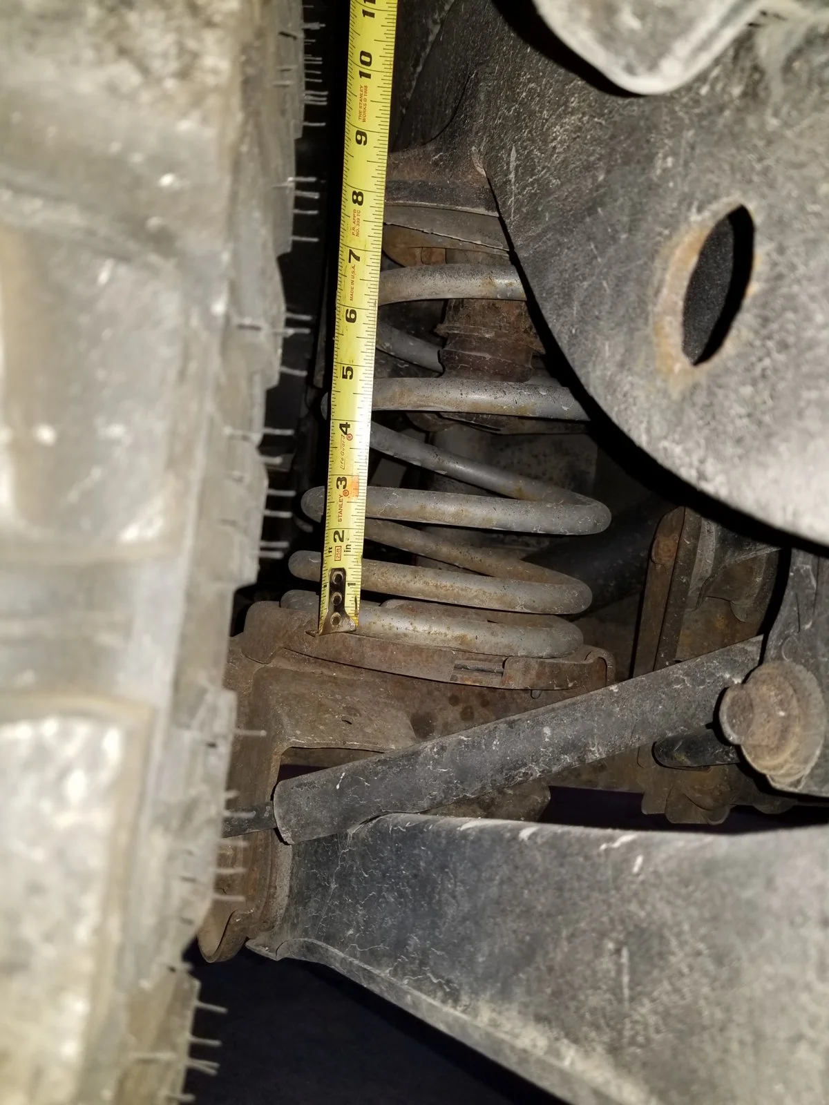

Alright fellas, I'm kinda confused here. So I have a rough country 2.5 inch lift that was on my jeep when I bought it. I know it is a 2.5 lift because rough country doesn't sell a spring that is less than 2.5 inches, but when I measured my coil springs, here is what I found...
Is it possible for springs to sag down this much? I just added a winch so I was curious to see how far it lowered my suspension (I hadn't measured before, so I'm not sure if it was even at 2.5 to begin with. And now I'm confused that a spring has lost so much lift.

I have no experience with RC springs, but I've read a lot of complaints about them sagging prematurely. Looks like you have a culprit there.

I too have heard of issues with RC springs sagging. While I don't have any first hand experience with this, I have heard it on multiple occasions.

Welp, looks like I need some new springs then. Add that to the never-ending list.

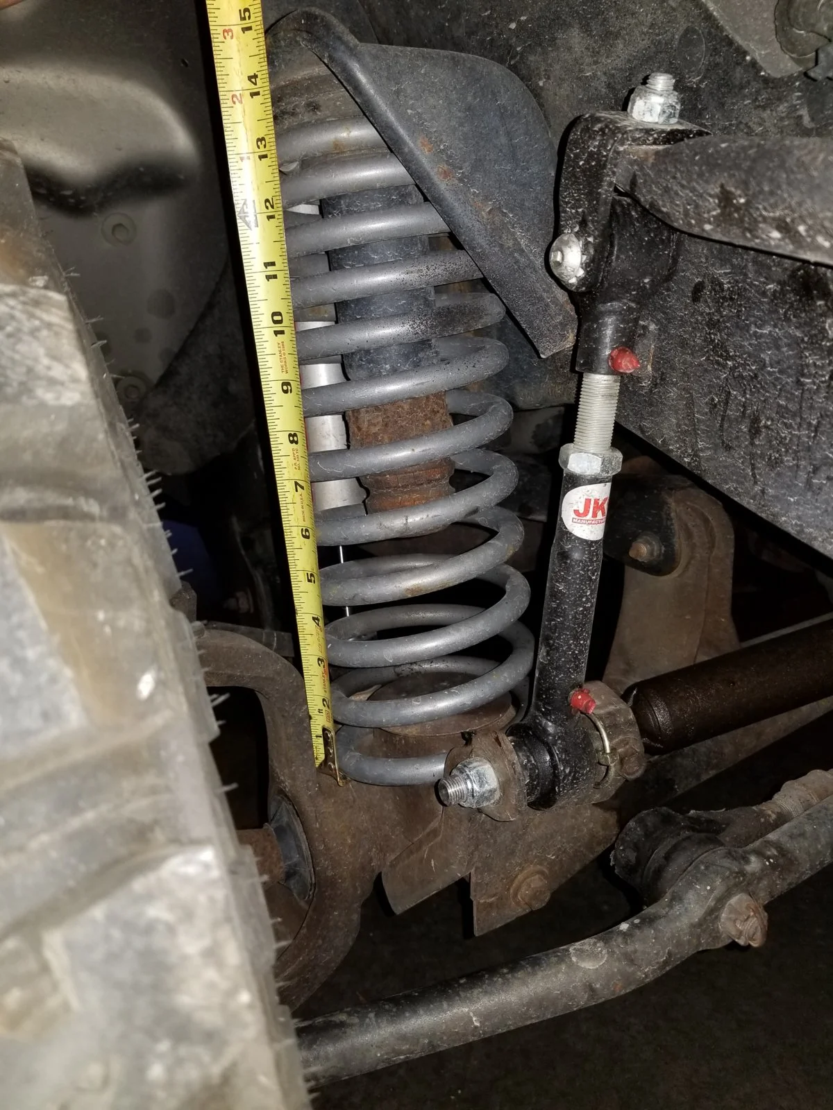

I went thru the dilemma of springs height back in November. Since I tucked the transfer case, I wanted to limit the spring lift to 3".
Savvy wouldn't return emails regarding spring rates.
OME had various springs / rates but looked like 2.5" was the lift depending on weight then dial it in with shims.
Ended up with JKS JSPEC 3" progressive set. And I like them. Reasonable price. Known rates, great response from JKS when inquiring.

I think I put some numbers in my build thread. It did raise it slightly more. But I've driven and wheeled it some. I could remeasure it. Not sure about their reputation for sag as it seems to be a semi new product. They are a progressive spring IE closer coils at the top. Paired with rancho 5000X the ride is nice. (my daily is a 3/4 ton pickup, so I may be jaded!)
On edit: Looks like I put sitting 5 3/4" higher in my build thread. So I had worn down 31" tires and went to new 33" and my stock springs were original with 200K miles on them. Accounting for the tires, it does look like the JKS lifted it 4" over worn stock springs.
