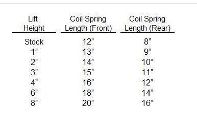

Here a chart help sort this out. How tall are springs compared to stock…
