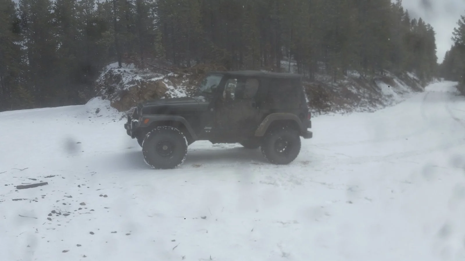

I recently picked up a 2" bds suspension. Rides better than stock. Still have to put on my 1"bl but here's a pic with just the 2" and 33x12.5s. Ran me about 650$ in my hands.
