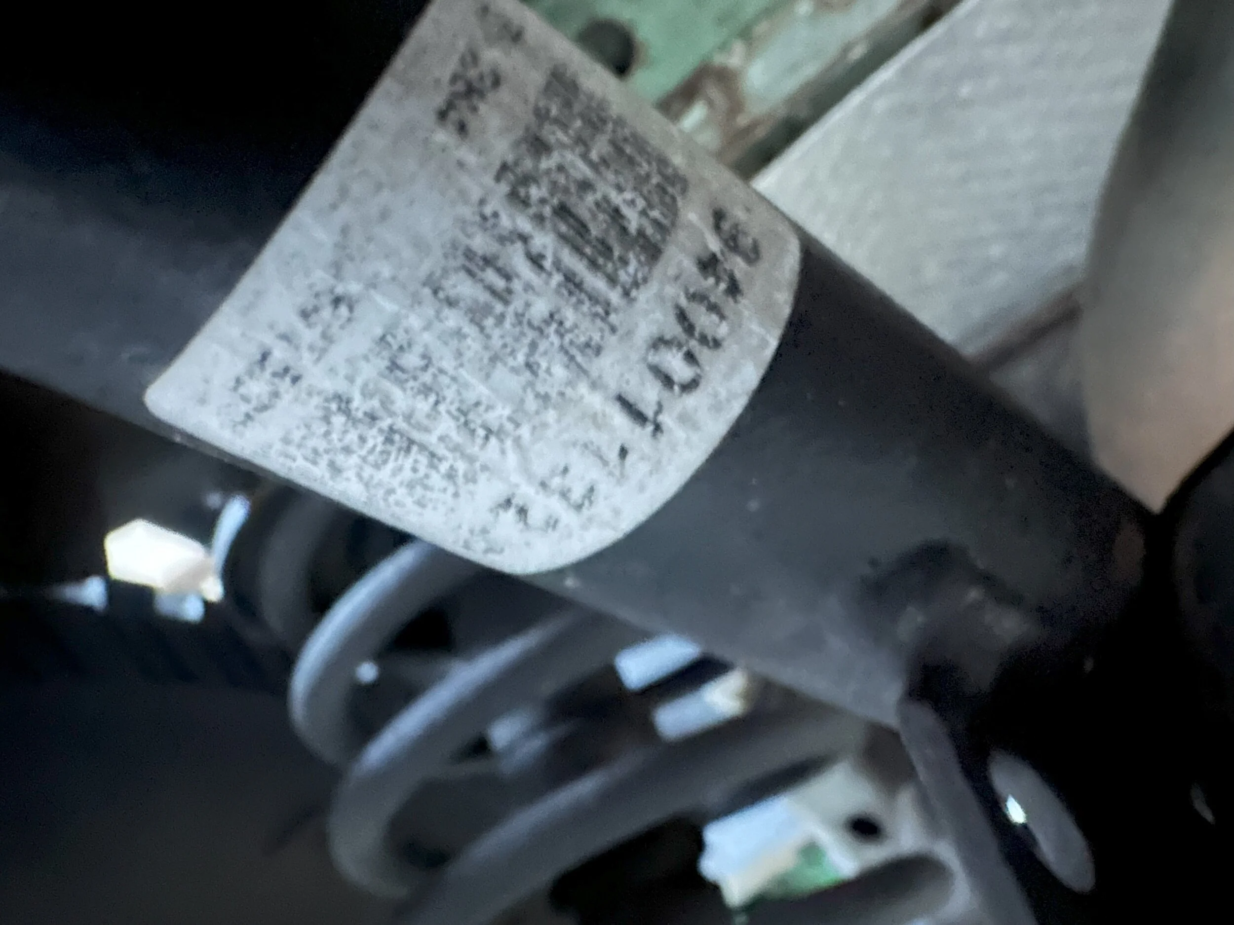

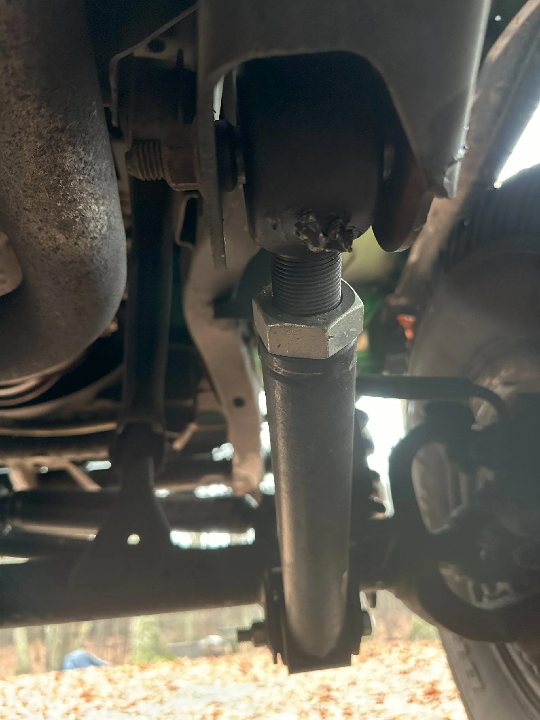

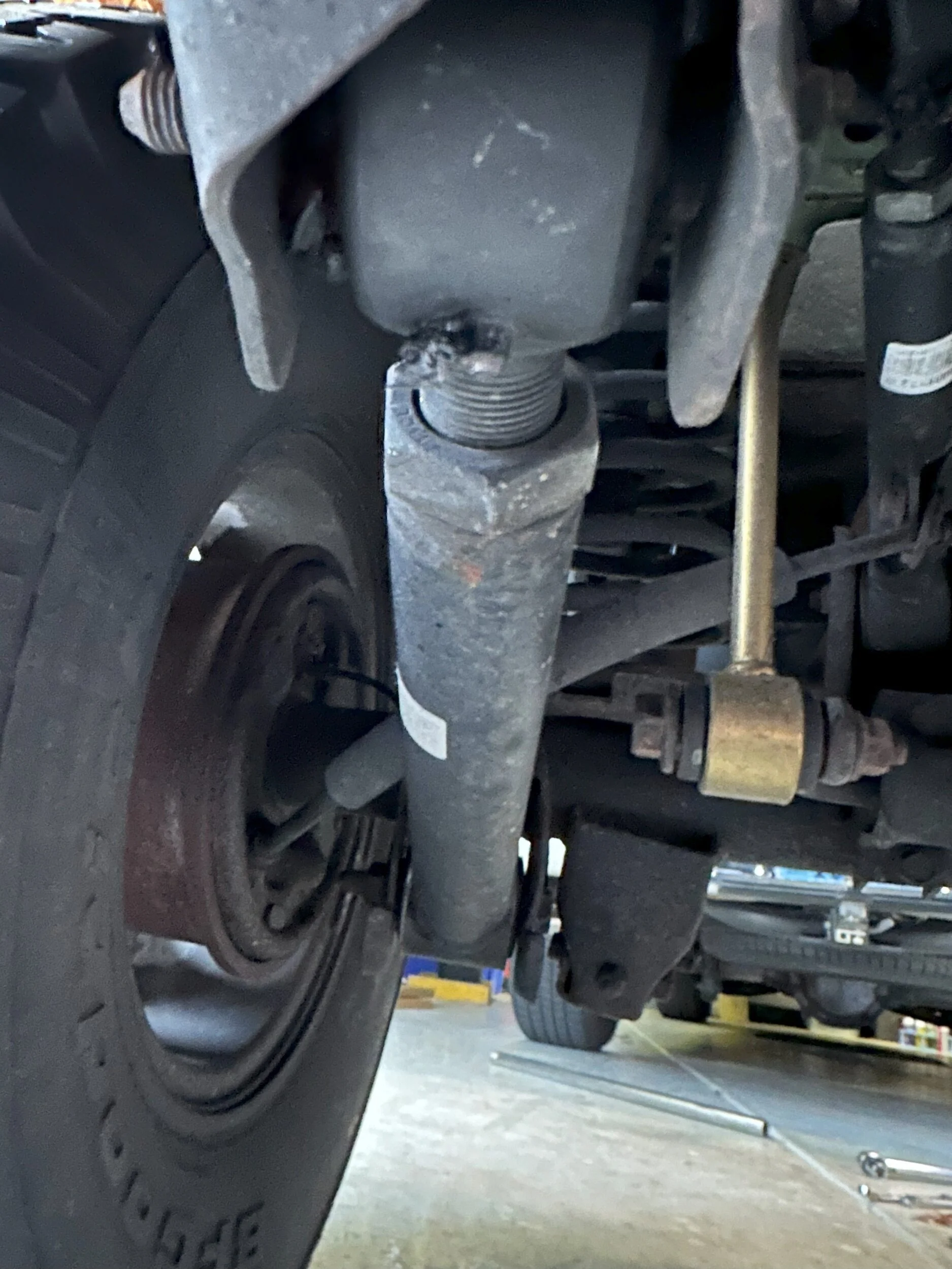

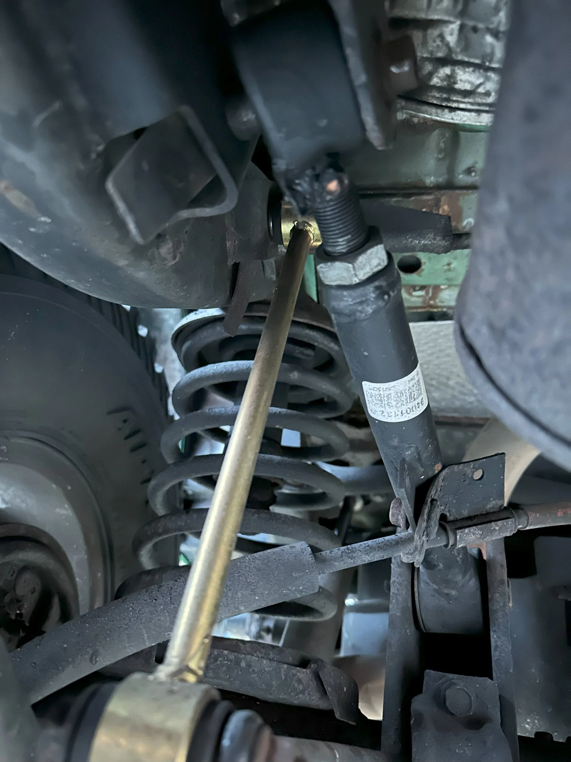

I am also wondering if I shouldn't check torques on the gold colored links as well (pictures 1 and 3). Torque value?
Any other suggestions? Looks like whoever installed the lift kit really hadn't finished it up with torques.
I attached 4 pictures to see if anyone recognizes the manufacturer of this lift kits, and has a picture of the gold non-adjustable link.
