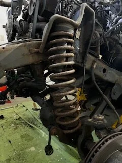

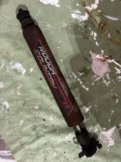

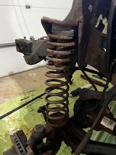

Hi all. Need some help from you experts. I've owned my 2005 TJ for 10 years, but I was in a front end accident and need to replace front control arms, lower front control arm mounts, shocks, and likely springs. My question for you is this: How do I figure out my current lift - I want to keep it the same as I have now. I've read the other posts on this forum and they have been helpful, but I am still unsure as to what is on the TJ now.
Some basic facts:
  1. Rough Country Performance 2.2 shocks
  2. BF Goodrich 33x12.5x15
  3. Before removing the fenders/hood/tires and while the jeep was sitting in the garage, I measured the springs (not sure I did it right) and they seem to be 14 inches long (and have what looks like "puck spacers" at the top that seem to be about 1 inch thick.
So, I have 3 questions:
  1. Do you think I have a 3.5 inch lift give or take (2.5 inch lift plus 1 inch puck spacers)? I've attached pics of the TJ, the shocks and the springs if that helps. Based on what I have read on this site, that it my guess, but I am happy to be corrected.
  2. What size/brand springs do you recommend?
  3. What brand model shocks do you recommend? This is basically a road jeep (some dirt roads, but it's my daily driver).
Thanks in advance for any help and direction.

To know lift, I wouldn't separate the two, spacer and spring, it's just all lift to me. You measure from the spring perch to perch, doesn't "matter" if it's spring and spacer. The stock was 12", so whatever that p to p measurement is in addition is lift. 8" in the rear same concept.
I had an old Rancho Spacer/Spring combo lift, and then just replaced with 4" Currie springs. The TJ didn't know the difference per se, ha.

Thanks wolf. Total measure was 15.5 inches on passenger side front and 16 inches on driver's side front (approx) - I am assuming the slight difference is a result of the accident (pushed axel off center toward drivers side). Appreciate the input.

Based on this, if you have
So your update looks like it's either 3.5" or 4" as it sits. You have 33" BFG's and you want to stay the same. I would ask: What are the measurements in the rear? That shouldn't be as effected, are they 3.5 or 4?
Either way, I'd look at adjustable control arms to replace up front, I have Savvy aluminum, but Currie are awesome, Core 4x4 I put on our 08 JK and I like them.
Springs, there are options, I had Rancho and switched to Currie 4" springs. The Zhone and OME people have said great things about.
Shocks, I put on Rancho RS5000x and have been very happy. I've heard the Black Max are, normal Skyjacker my son got were crap, get the better. Fox people have said good things, and we replaced the Skyjacker with Bilstein on my son's JK and it rides really well. Those are ones I've heard, I would not get RC shocks. I have a garage of new in box Rough Country Truck Lifts etc, and Fabtech and Zhone, but for Jeeps I'm not a fan.
Just my $.02,. I've not replace control arm mounts, I've seen threads on it, no input from me.

Always ask...So in these two posts you wrote:
1. Fronts are currently 15.5 and 16 side to side.
2. Rear are 12.
So stock spring height front is 12" and yours measured 16" that is a 4" lift
Stock spring height rear is 8" and yours measured 12" that is a 4" lift.
So....you have a 4" lift (minus your front passenger front being 3.5" (15.5) and that could be the wreck etc. The other 3 are 4", so that would tell me that you have a 4" spring lift.
Now, replace that with 4" springs, and you will be where you are now. I'd seriously look at the Currie 4" TJ springs front. If you can swing all 4 go for it, but if you can't and need just front, I'd get them, maybe in the future you refresh the rear with Currie. If your current measure 4" as you noted rear, they aren't sagging.

Do you have isolators and spacers up front? Hard to tell in the picture.

There are two "spacers" on top of each front spring (not sure if I'm using the correct term - they look like black rubber pucks) - one is 5/8" thick and one is 3/4" thick - from what I have read on here, the 5/8" one is standard and the 3/4" one was probably added when the original owner lifted the TJ. I don't know what an "isolator" is - can you describe it for me. Thanks to all for the help!

b8525 is black maxx front recommendation.
I am using b8575 for the front. It's a jk front shock and it's only slightly longer with nearly 2 inches more travel. Just have to add a bar pin to bottom bushing which is easy because they don't come with the lower bushings installed.
