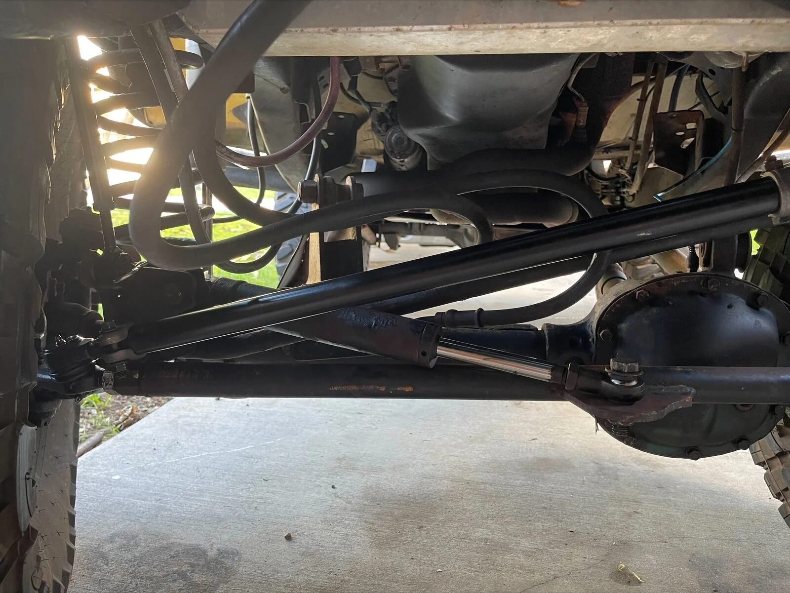

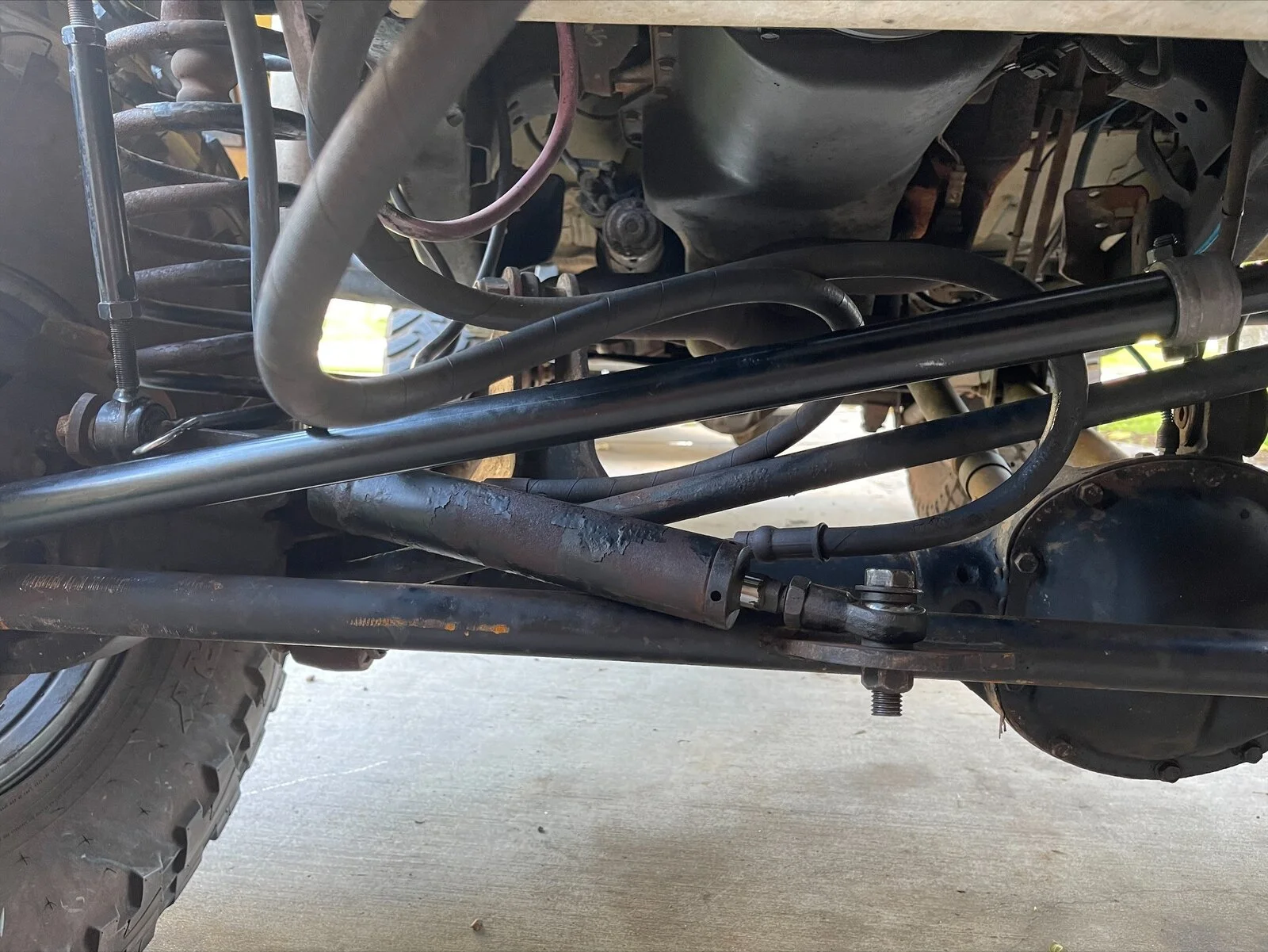

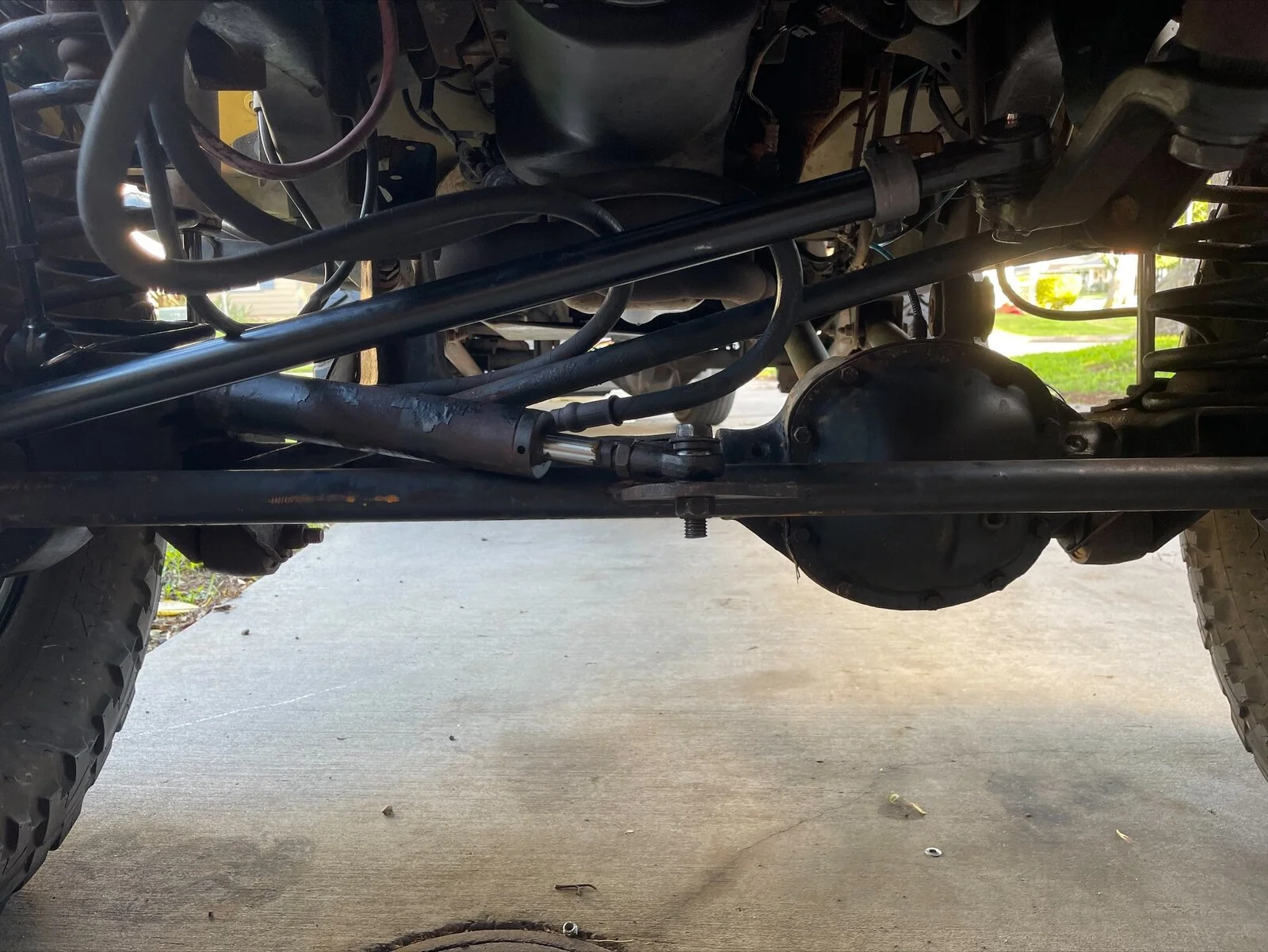

BLUF: Can turn left 2 full rotations of steering wheel. Can only turn right 1 rotation of steering wheel.
I have a 2006 TJ with a 6" lift and 37" tires. I have recently replaced the tie rod ends and drag link. However, I now have an issue with my turn radius. I can turn to the left 2 full rotations of the steering wheel, but can only turn 1 rotation of the steering wheel to the right. I believe it may be due to my hydraulic steering assist piston being out of alignment, but before I go through all the hassle of removing everything to get it off I thought I'd ask here. I have pictures attached that are labeled according to the position of the steering wheel (center, left turn, and right turn). Any advice or insight on this issue would be helpful!

It looks like you have more stroke available for the driver side turn vs the passenger side. How much stroke does that ram have?
You can try unbolting that ram and steer back and forth each way. See if that improves or confirms the ram is the restriction. Make sure that ram won't hit anything at full extension when its unbolted.
It looks like you have more stroke available for the driver side turn vs the passenger side. How much stroke is that ram?
Thanks! I'll give this a try. I haven't considered this for some reason. Guess I've been too deep in the weeds.
