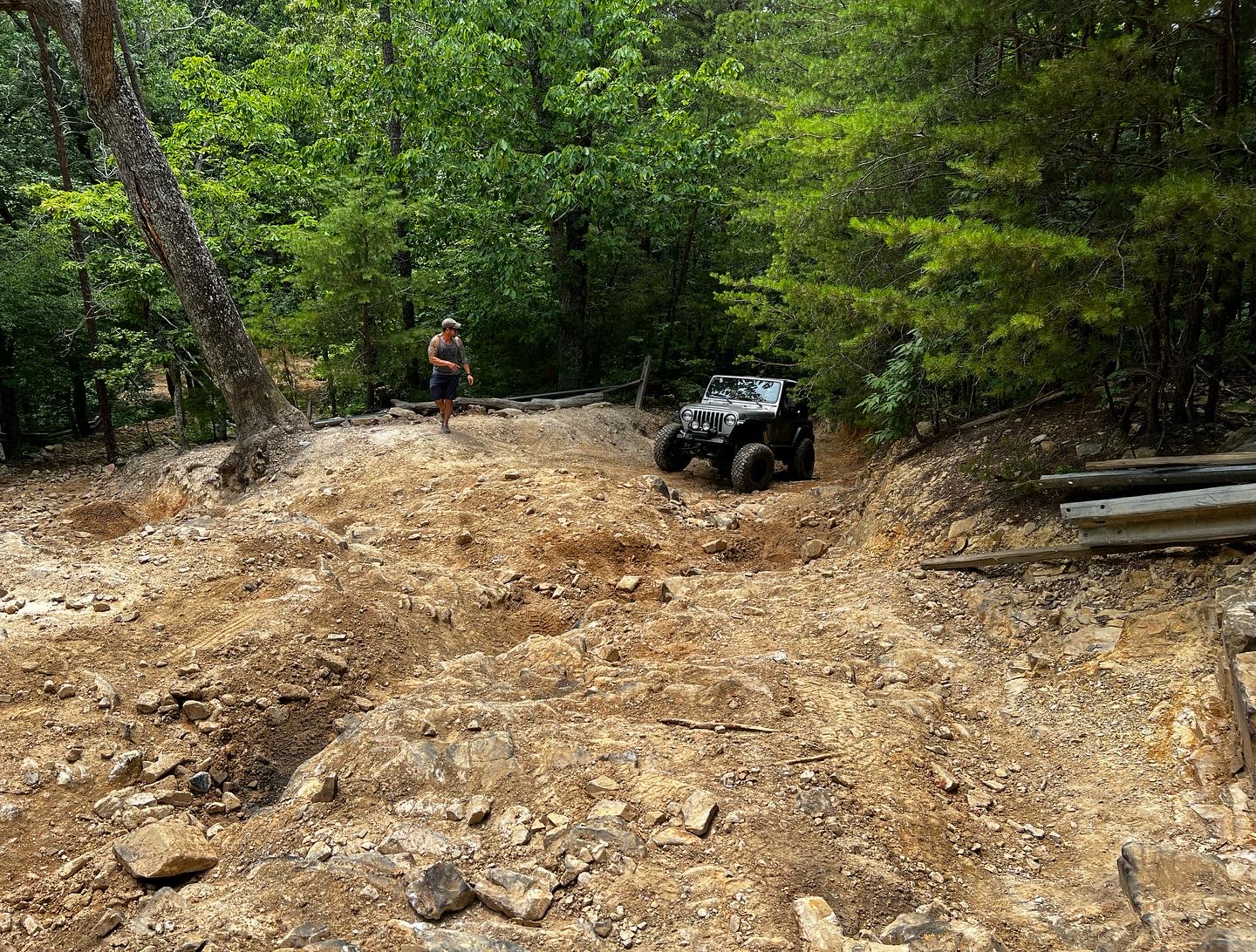

Y’all are missing out! Lol. Had a good time out at Uwharrie this past Tuesday. We only did rocky mount loop, backside of Daniel, and like always I played a little on the front side of it. Then finished off with Dickey Bell. I had the JT go up the bypass on Dickey Bell, otherwise he would have beaten up his truck. Not sure what I was thinking, but I let my dad drive up Dickey bell. Man, that was scary! But he made it.
Sun was supposed to be throwing down 💯 degrees but the overcast kept it nice and cool.
FYI, stock JT rubicons scrape way too much on those high rolling hills throughout the trails. Kind of knew this going in but sometimes it was inevitable.
Nice driving!

Thanks man. It’s tough without a guide sometimes, and I had to walk the line before I took it. A manual Trans. also offers another level of difficulty to it. The more difficult trails I do, the more I realize I need a BBK.
