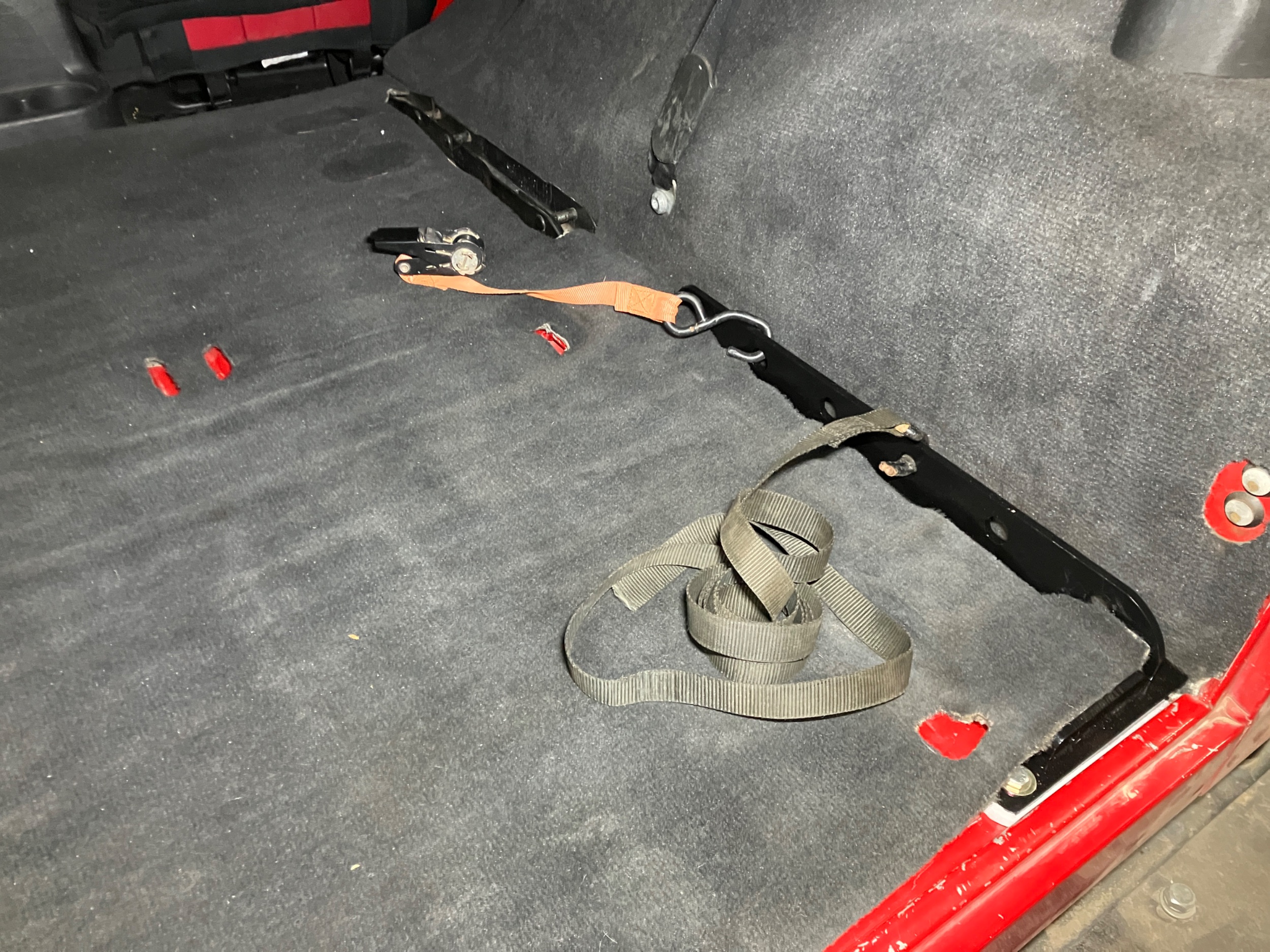

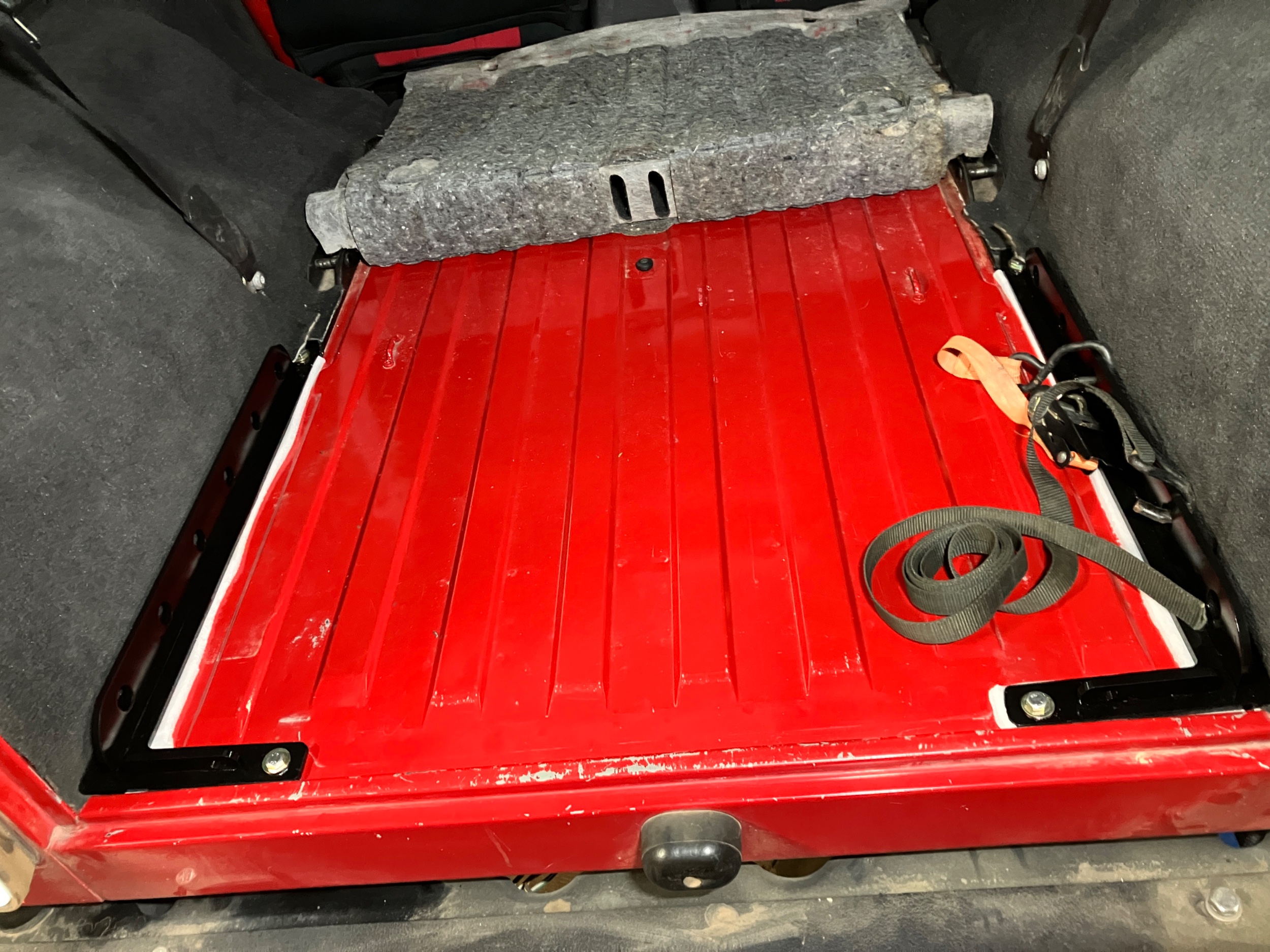

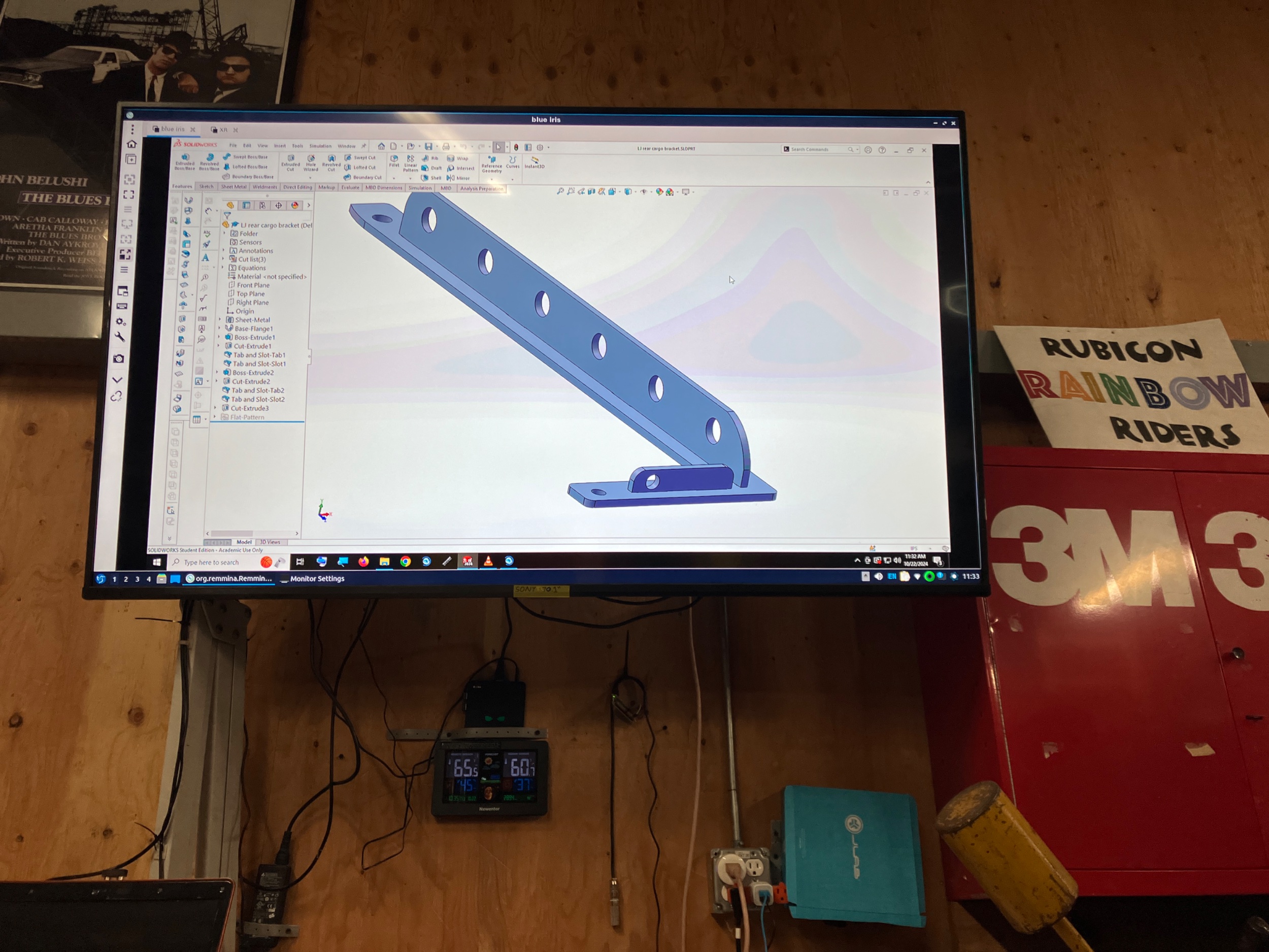

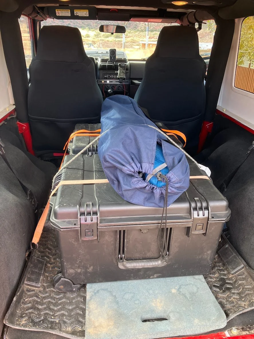

I am racing through getting my brand new-to-me previously-stock LJ ready for a 2 week trip cross country (smart right?). I needed good cargo tie down, but wasn’t ready to commit to any design that required drilling holes yet since I haven’t decided on the right long term approach. I designed and cut this out very quickly. Zero re-do’s, zero re measurements. Used scrap pieces. It’s way overbuilt with 1/4” and yet only attaches to 2 bolts, which is probably not ideal. But they are seat and car seat bolts, so hopefully they’re stout enough. I’ve rolled and flopped too many times to feel comfortable relying on bungie straps and gravity. I ratchet strap everything.
Is this design perfect? No. It needs more attachment to the body, and I could have made some better rigidity choices for the bracket itself, but I suspect it will be just fine and probably last forever if I get lazy and never change it. It seems plenty rigid and doesnt seem to flex at the car seat bolt at all. Maybe it will provide some inspiration for others to do something similar.

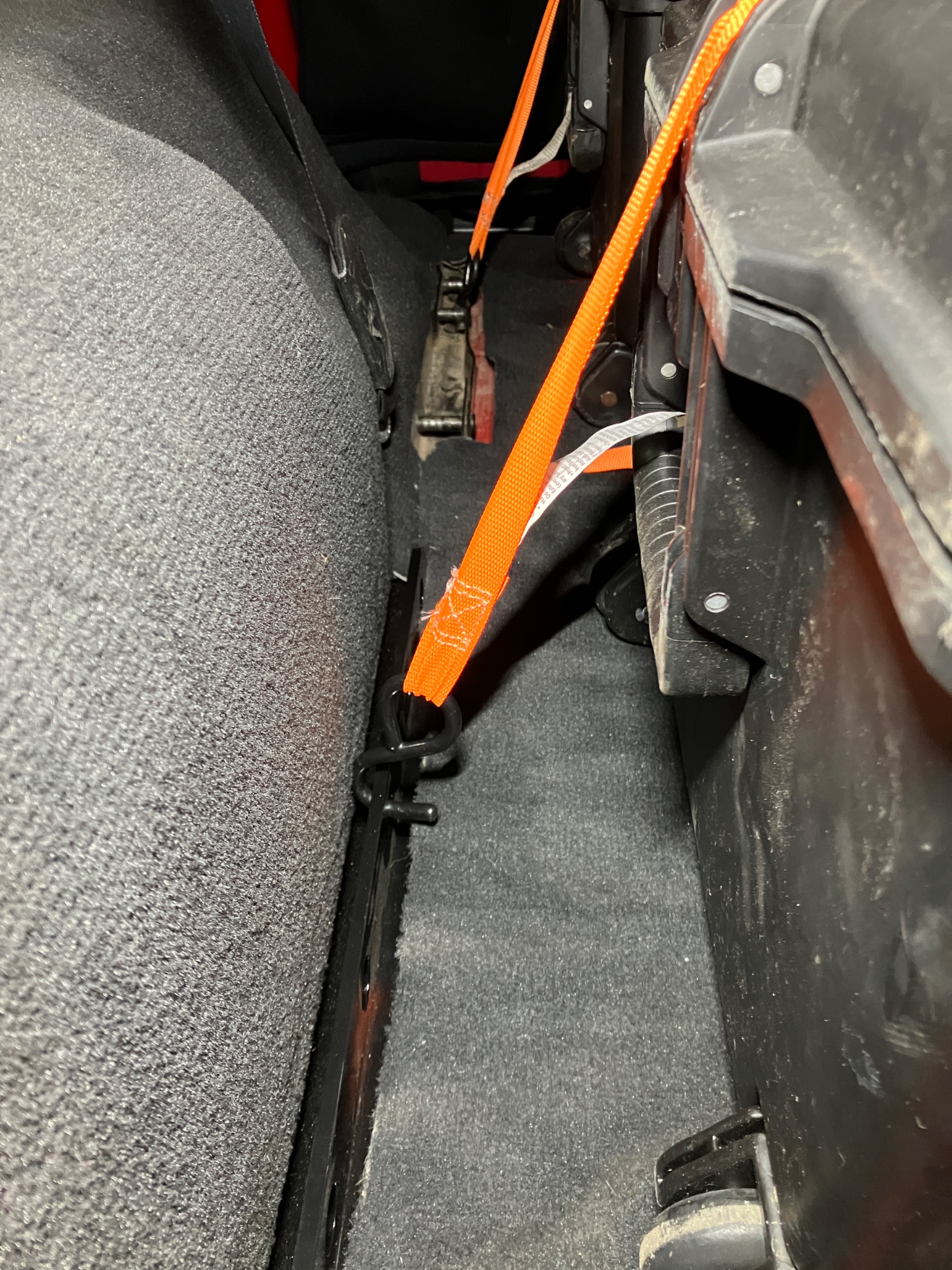

I am just using the OEM seat bracket for a tie down up front.
That seems like a sufficient amount of overkill to me.
agreed.

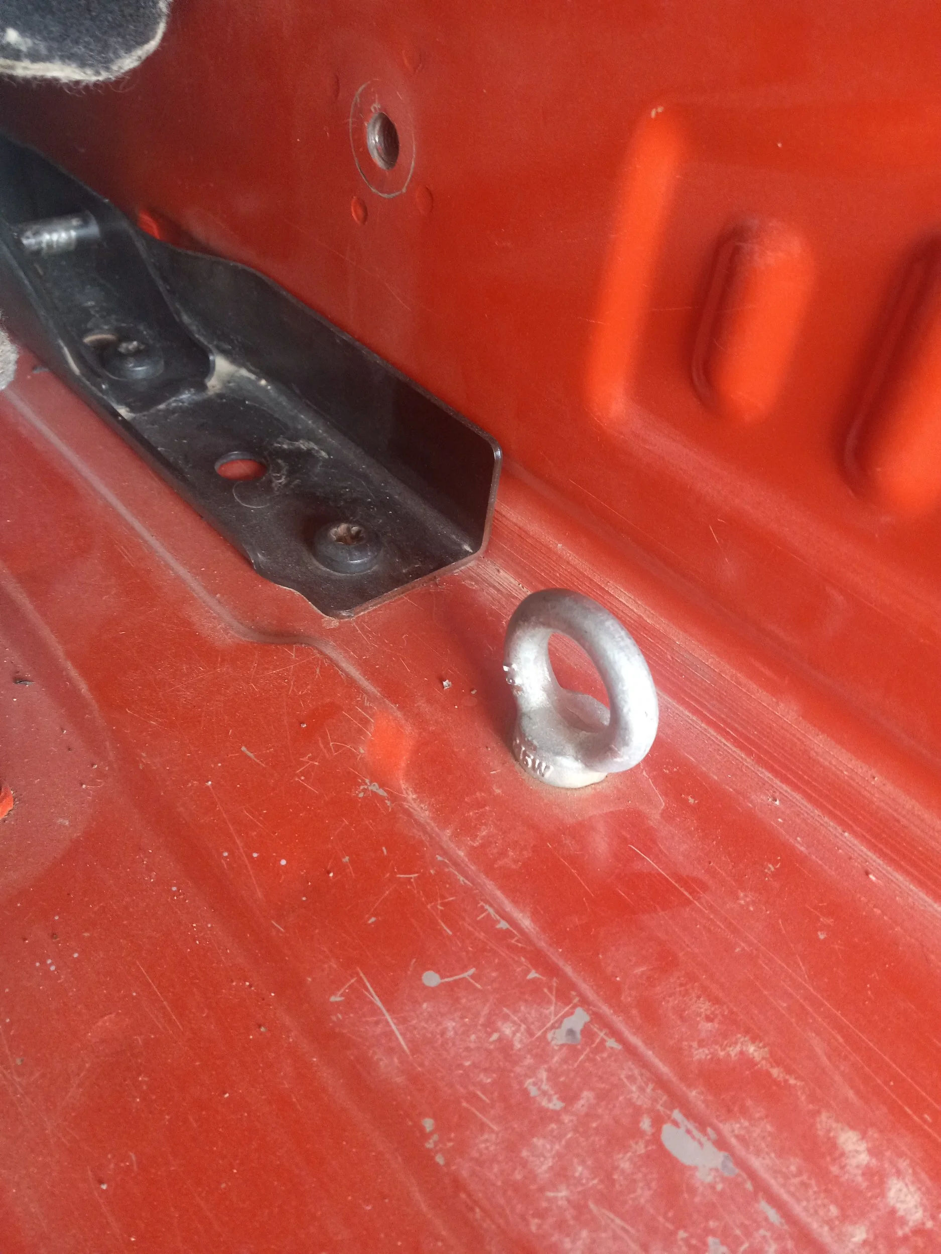

On mine, I noticed there is an unused nutplate nut under the body (in the area of your bracket).
However, you will have to drill a hole in the floor to access it.
I screwed in an eye-bolt on each side.
Reactions: DMopar97
+10 points for using computer-aided design instead of the more common cardboard-aided design

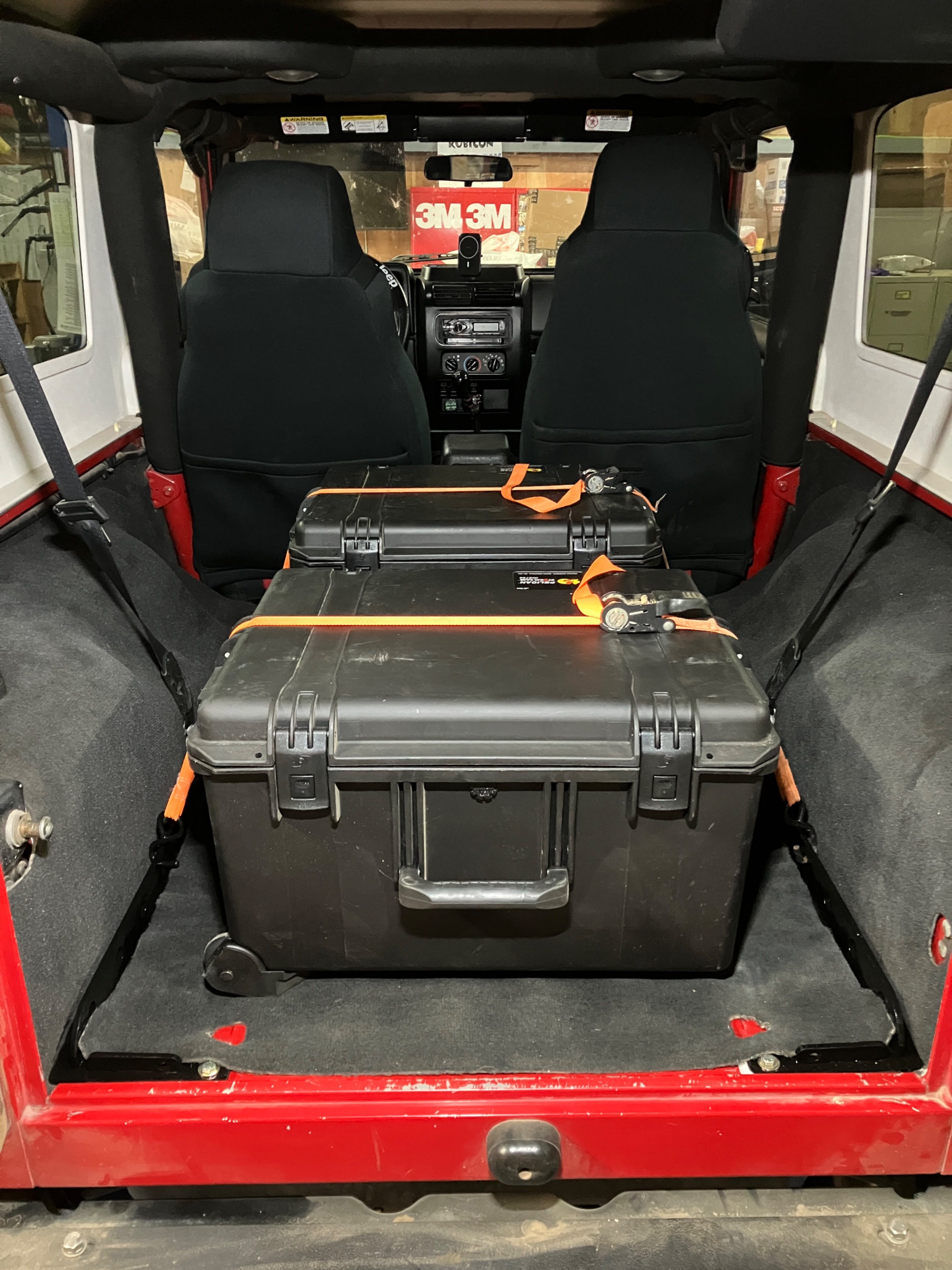

Hey Folks, just wanted to report back that everything worked great through 2 weeks of rock crawling in utah and coloardo. The bracket hasn't bent, and the car seat tie down bolt hasn't broken/bent (which was the part I was most worried about). I had ~200lbs of gear strapped down wiith ratchet straps, and was at some pretty gnarly angles, and everything stayed put, so I'm happy with it, and I'm leaving it until something about it no longer works. I'm still not interested in selling them, but if you have a plasma cutter, or know someone that does, you'll need some 1/4" plate, and you can get the files from here: https://www.langmuirsystems.com/fir...lj-2004-2005-2006-rear-cargo-tie-down-bracket
