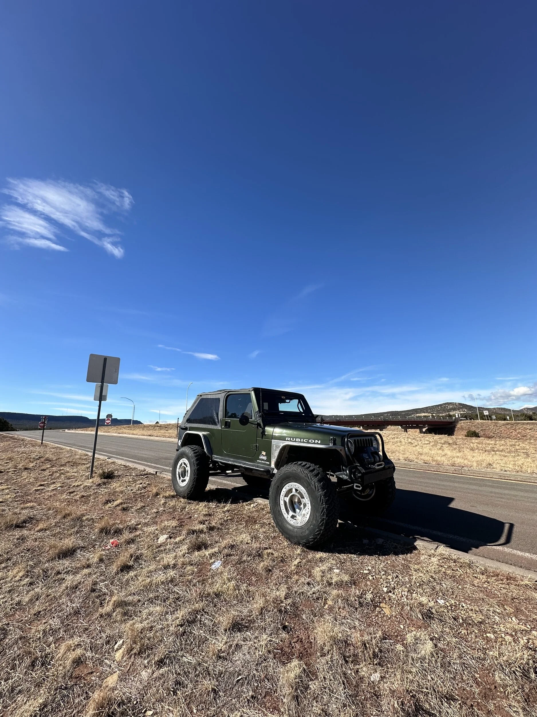

This is it pre fire.. I’m just at a loss of what could cause a fire

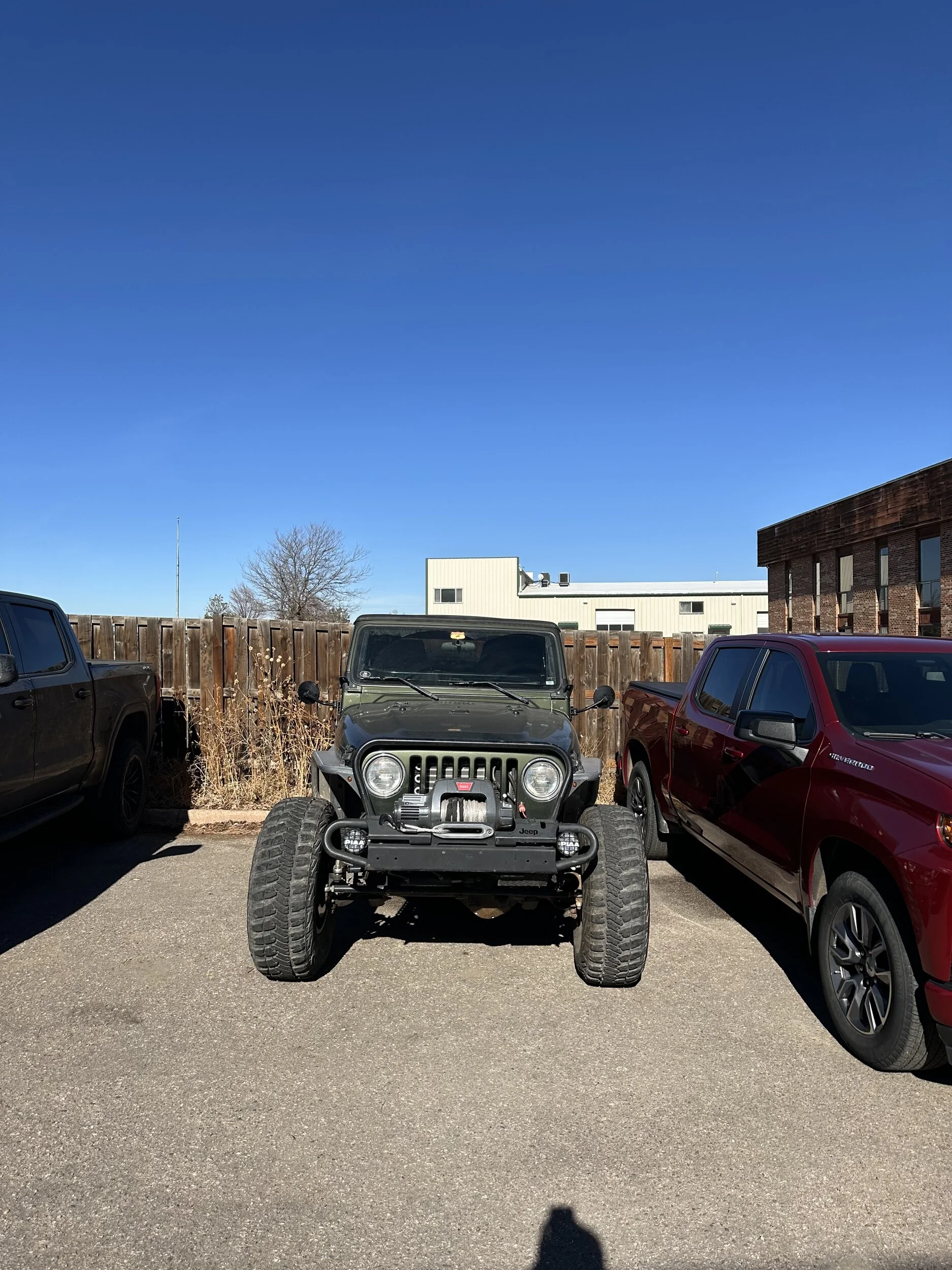

So it seems or I should say it has a kill switch system.. seems to have started either where the winch is connected to the battery on the front side of the battery.. or perhaps where this kill switch system is connected.. he saved it though it seems. I don’t see any melted wires or plastic nor paint.. .. gunna get battery checked tomorrow and disconnect the winch til he gets it home

Possibly winch battery cables cut due to vibration and shorting battery. Also what’s the connector on the drivers front and cable behind grill?
Reactions: macleanflood
Posted this as I was typing about the winch cables. Saw this happen once burned the Jeep up.Ever since I have made sure the cables have a protective sleeve and are routed so they don’t get cut.

my positive winch cable insulation rubbed through and shortened out my new battery shortly after winch was installed. i ran both cables through rubber hoses from which to battery. all has been good since.
