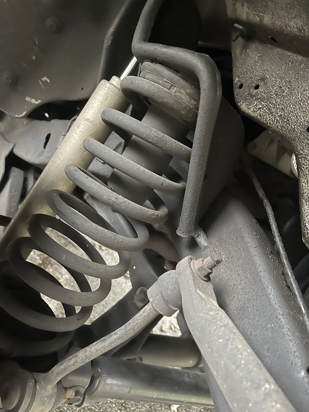

Holy crap you guys are awesome, I just could not find anyone who made the front part that I need. I’ve attached the pictures. Let me know what you guys think.
So the link you sent has the parts for fixing the bottom portion of the frame and boxing the top portion but the crinkle as you can see above is right behind the spring. Any recommendations how I can fix that?

There is a section of frame by the spring/shock that is crushed . the shifted metal at the hole is the oddity.

im worried about it not being straight. The jeep drives fine and hasnt given me any issues yet but on the inside of the frame the upper control arm mount is definitely pushed into the frame, the frame is crumpled slightly behind the spring like you mentioned. Do you really think i should just not worry about it? Am i worrying too much? Im wanting to do upgrades to the suspension and if theres a reasonable way to repair it i might prefer to do that before i sink thousands into a quality lift kit lol

That rail is fucked and if the dealer knew they screwed you over good..there is no safe or legal way to fix that damage..you either live with it or frame swap it..splicing is a possibility but must be done correctly and by someone experienced or don't bother

If the front bumper is level I don't see why you'd spend any time on this. If you are worried it is weak than just weld some reinforcements onto that section. I don't see why you'd replace any control arm mounts, at least not in the pictures you posted. Personally I might just get an alignment first to see if it's within spec. Keep in mind all the factory welds look "shitty" and none of the pictures you've posted look like they have bad welds.

I was thinking add some fish plates over the buckled area. I think the frame is designed to buckle there. It's not ideal but it happens. you can find replacement frames at wrecking yards or it's a good opportunity to cut it off and start going custom :). So long as you got an angle grinder and welder.
