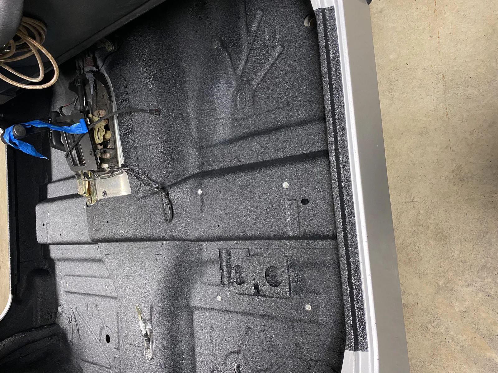

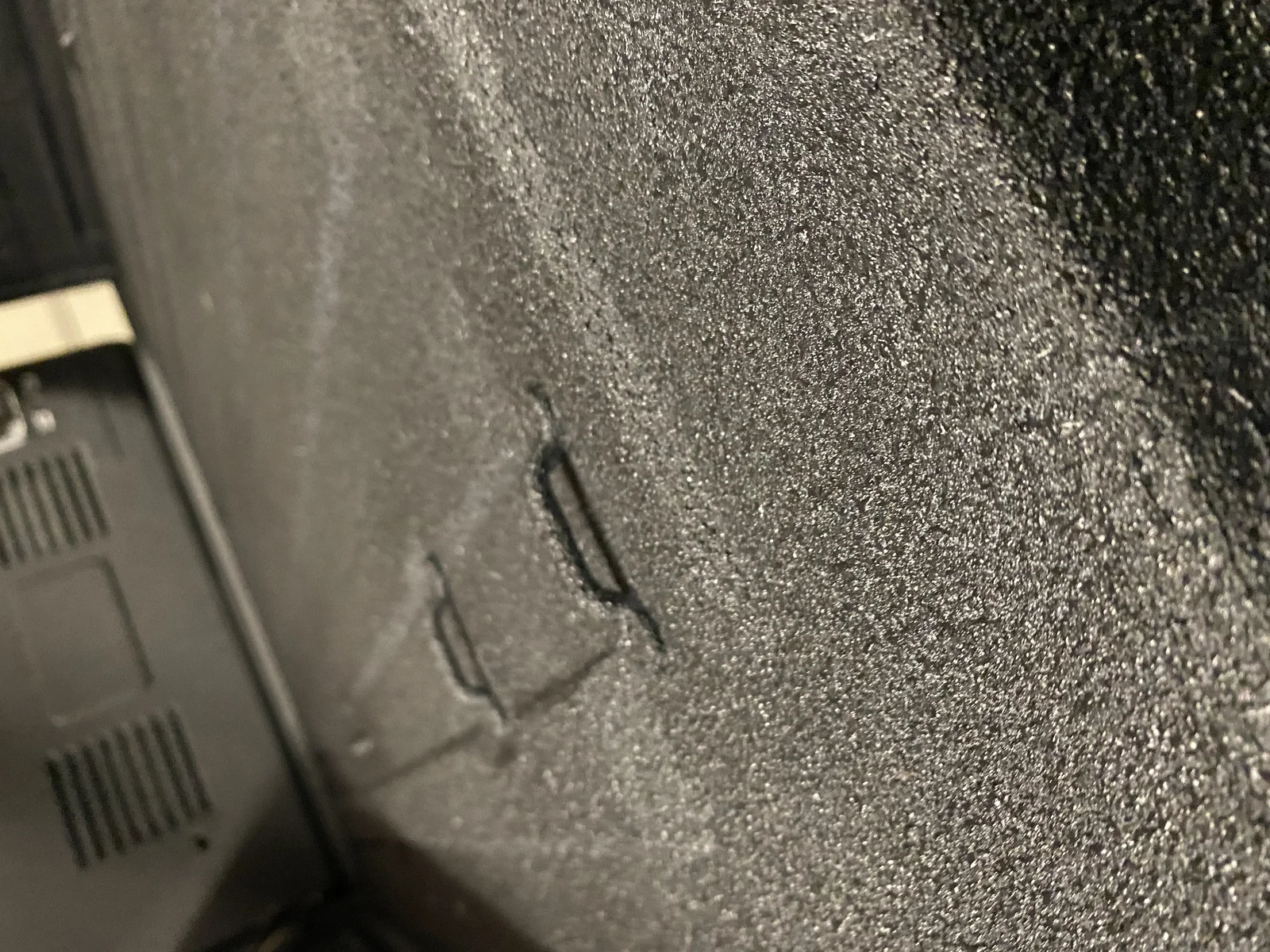

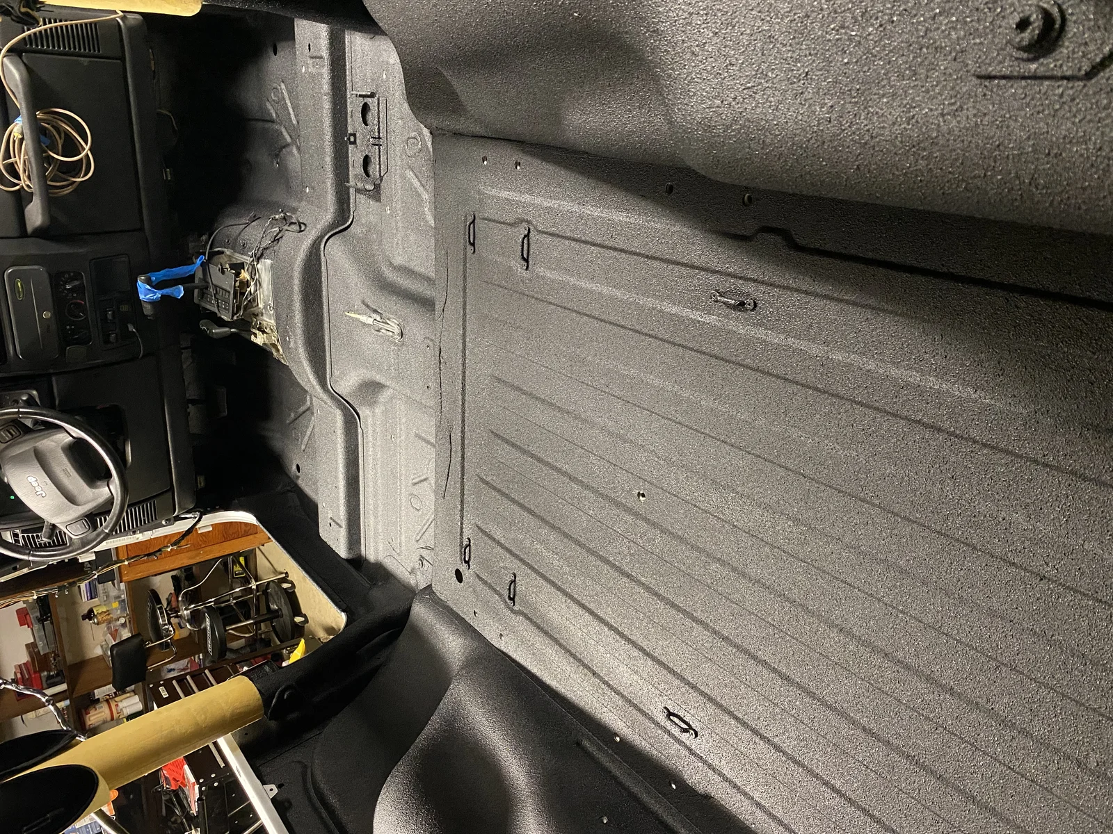

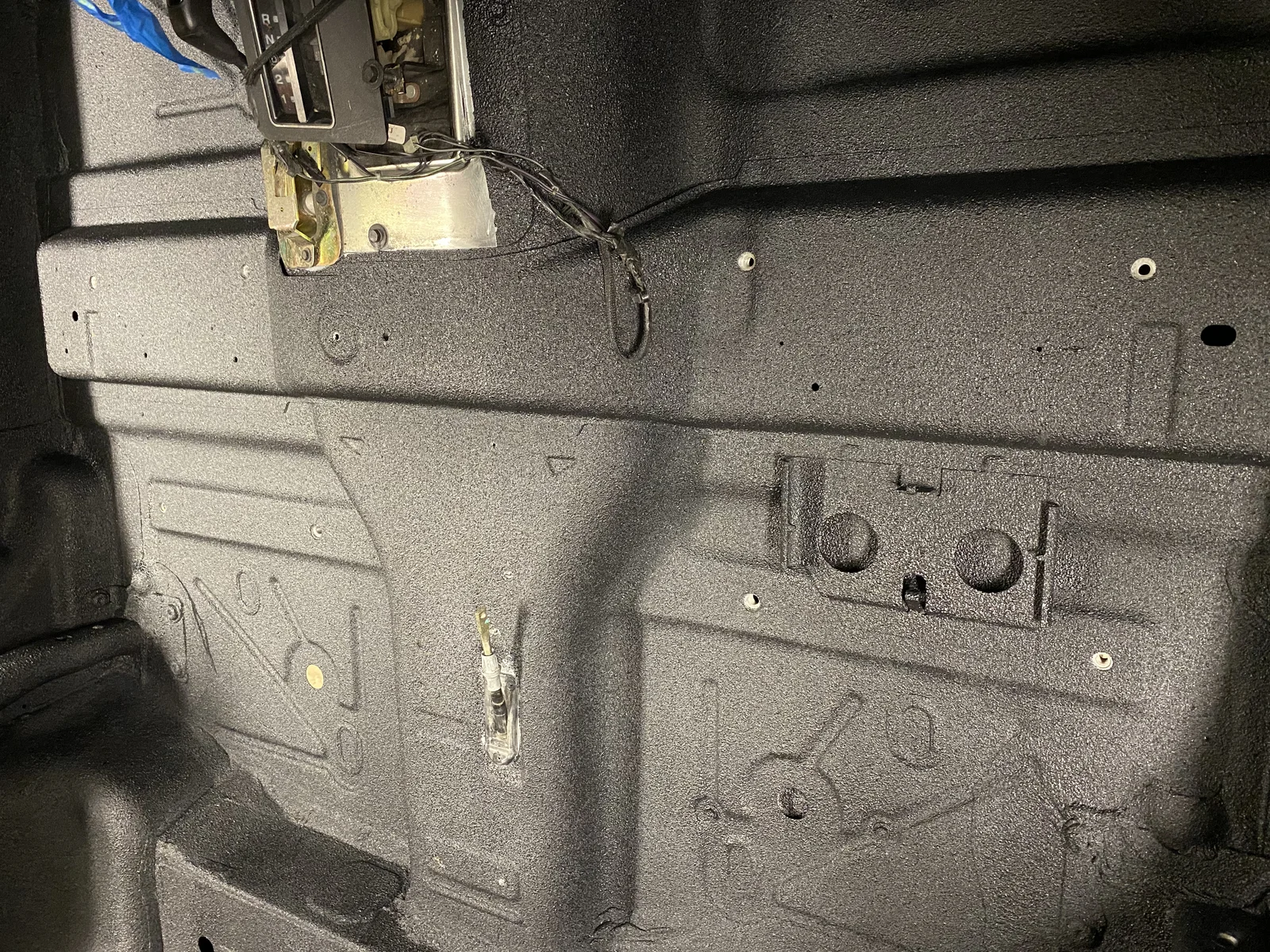

Thanks for all the help guys. Also, @Chris, you are definitely right that this should've been the first forum. It has always been my number one source and I cannot begin to tell you how many things you, @Jerry Bransford and many others have unknowingly helped me on. A quick update: I was able to get it off using a wire wheel to break it loose followed by lacquer thinner and a scotch brite pad. I followed up with the self etching primer. Here is the finished product. Not sure why they loaded sideways.
Very nice job! I would do my tub the exact same way again. I love the Raptor that much…
nice job, looks good.
