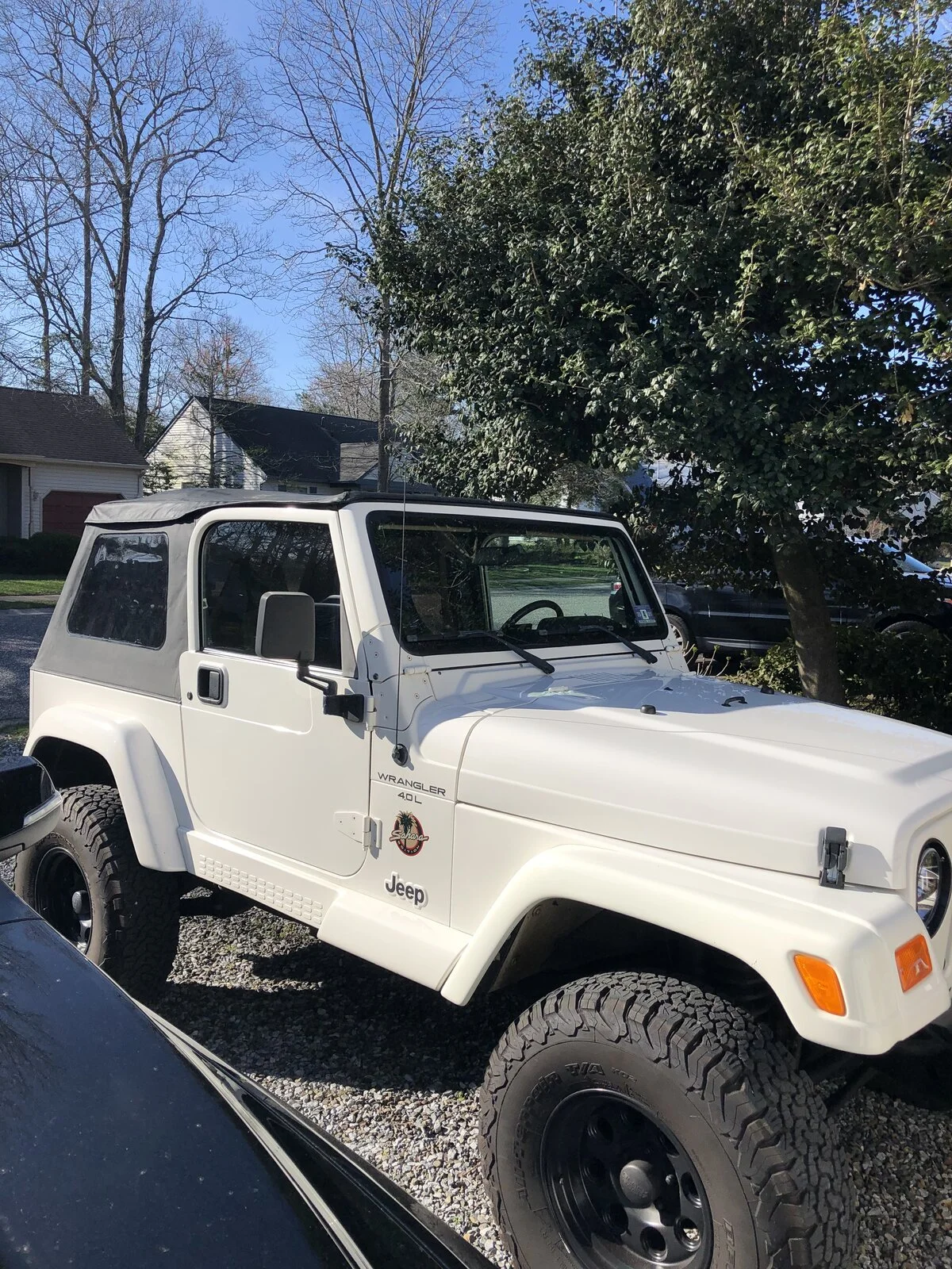

2004 LJ with what I think is OEM Soft Top and full hard doors. Having issues with the zippers on side windows - very hard to zip in and out. Back window was brittle & cracked in several places so bought a replacement but top zipper is missing teeth and we can't get it installed. Trying to figure out best Repair or Replacement option.
Background - This is a trail rig only that gets trailered behind our RV, only on road use is to get to a trail head etc. no daily driving. When we wheel, weather permitting, we like to remove side & back windows and doors, so easily removed/replaced windows a plus.
We think we want to stay with the OEM style vs the fastback style? We like the look of the fastback but feel like we would loose a little storage space - we have a cargo box and strap a cooler etc. on top of it - is that really an issue? Anyone with personal experience or opinions of full vs fastback appreciated.
If we decide on a replacement full top, how do I confirm I have OEM frame & hardware vs aftermarket?
Does anyone other than Bestop sell replacement tops for LJ's?
Any advice greatly appreciated.
