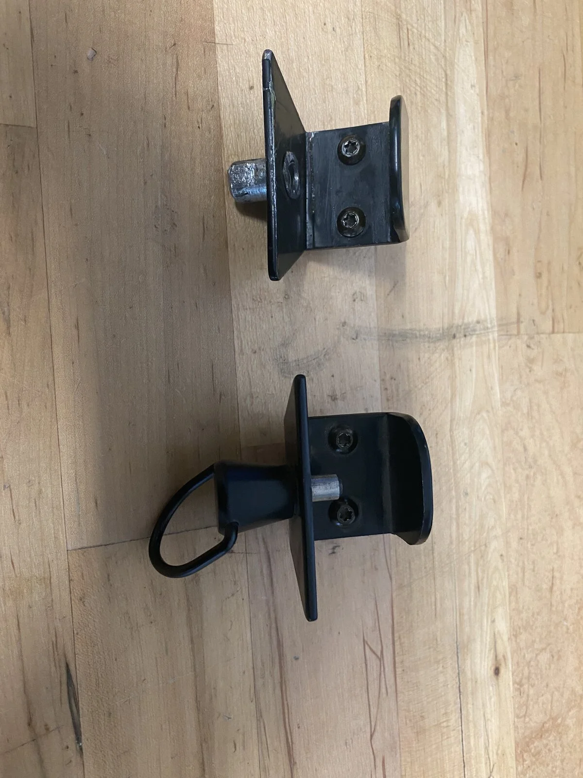

Has anyone been able to source these quick release pins for the lj soft top? They are off the original jeep door surround (mopar stamp in plastic). I didn't have any luck finding oem.
Thanks for the help.

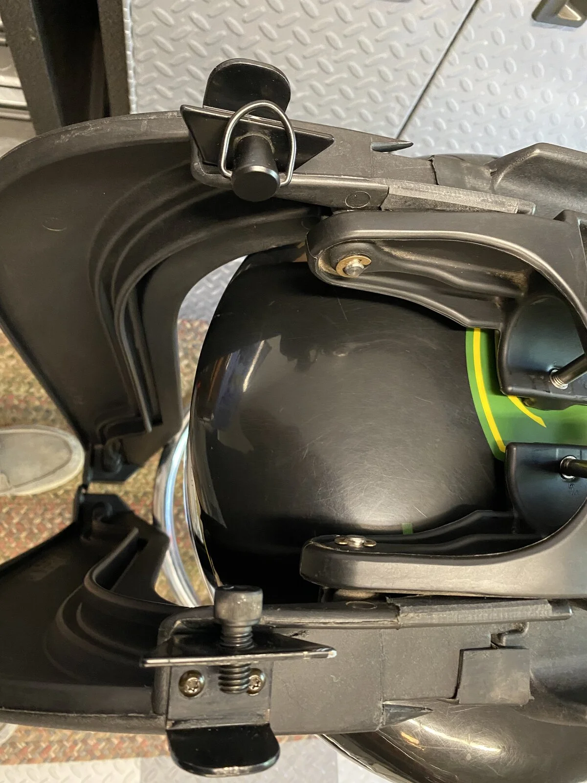

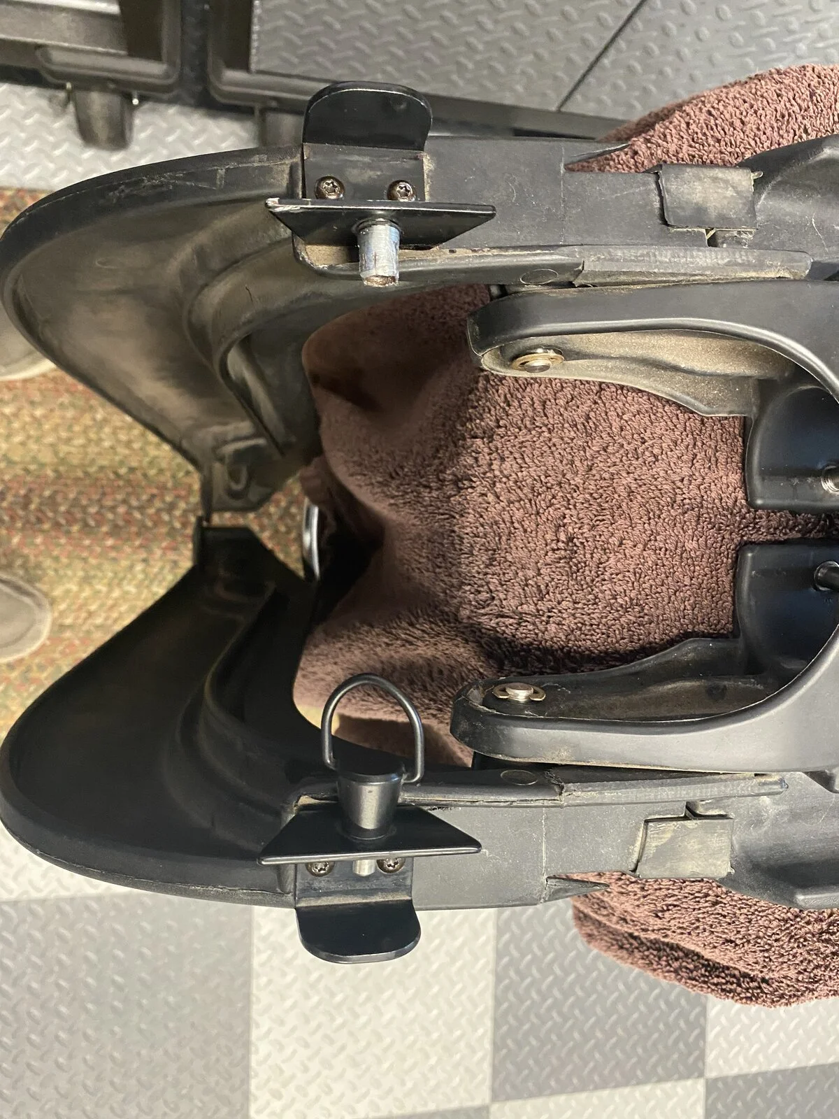

Here was my inelegant solution. I tapped out the hole to 3/8 - 16 and put a set screw in as a replacement. Not quite a quick release anymore but it does make for a more tight grip on the soft top frame (this should be a rattle reducer I think). Will do the same to the other side when necessary.
