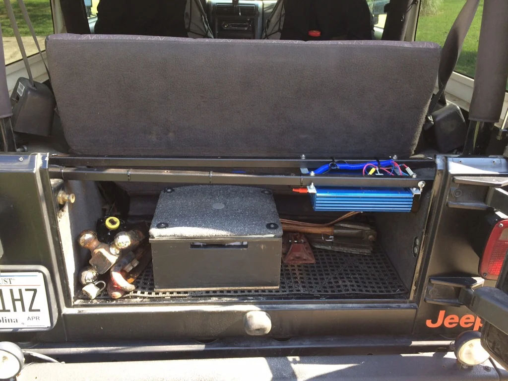

I am working on something not quite as elaborate but will keep stuff out of sight such as my amp and sub plus misc tools. All I need is to add a piece of diamond treadplate and some carpeting and it should be complete.
Sent from my iPad using Tapatalk

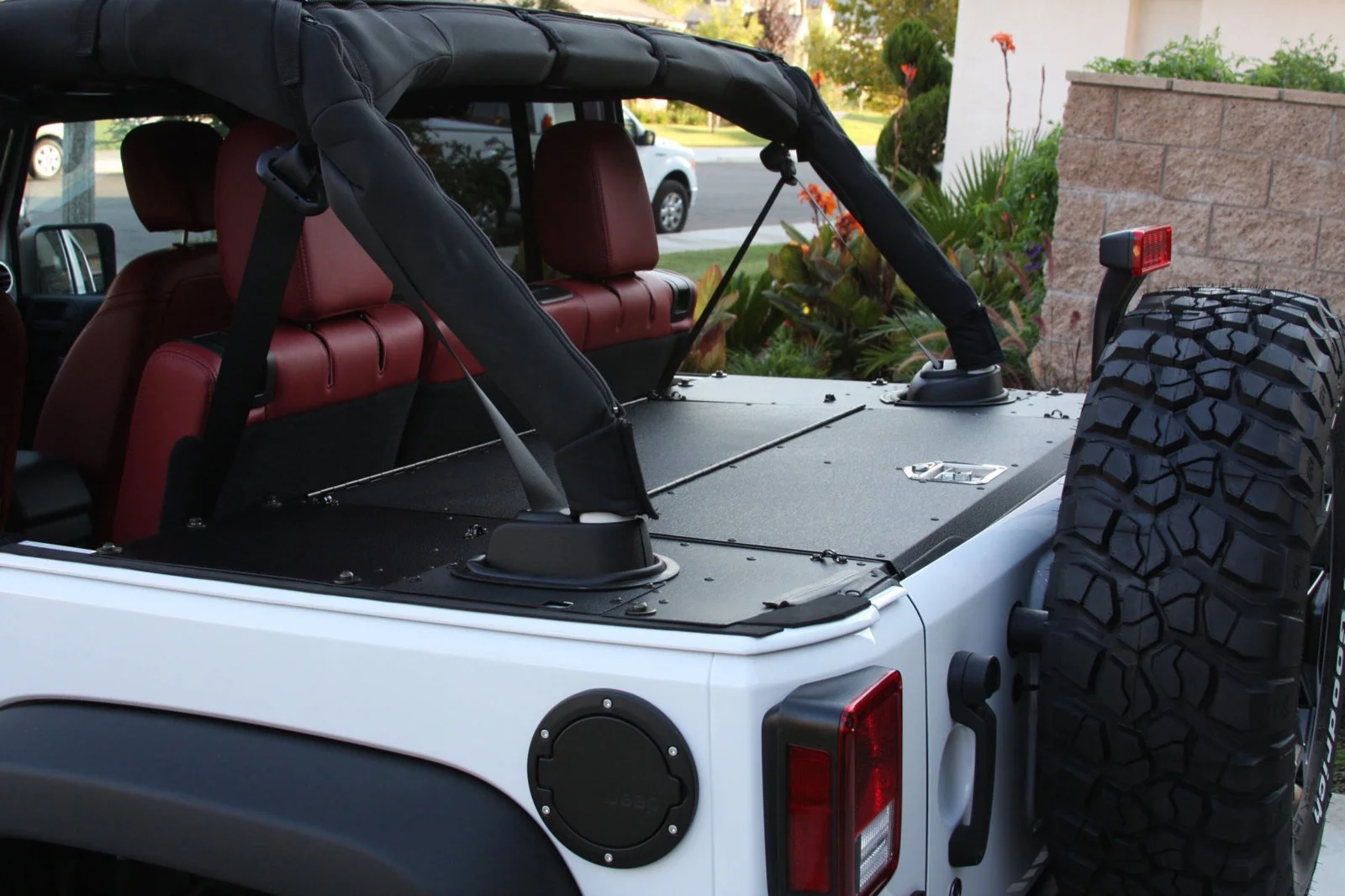

Funny you bring this up. I've been topless all week and have been looking at options as well. Most of the aftermarket options are more limited space drawers or boxes than true enclosures. I will be working on one in the coming weeks and hope to have functionality near or similar to the Aries Cargo Box for JK's.

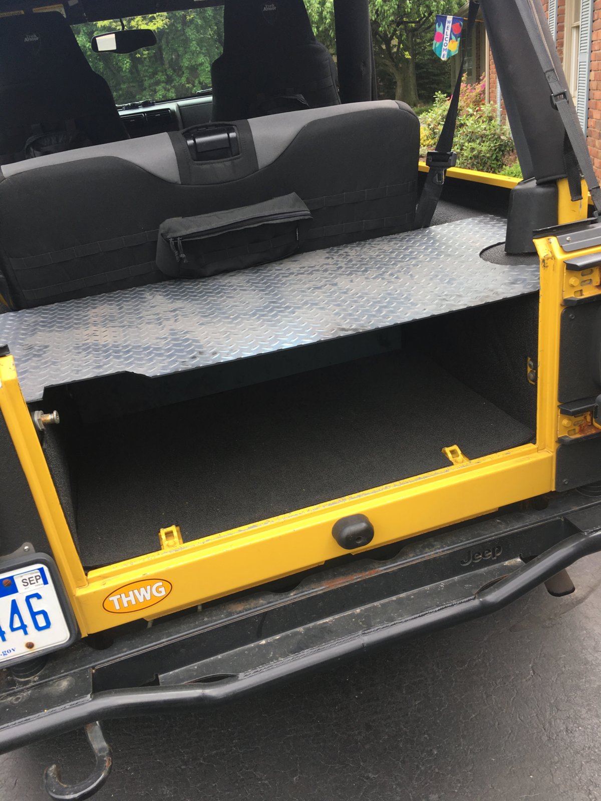

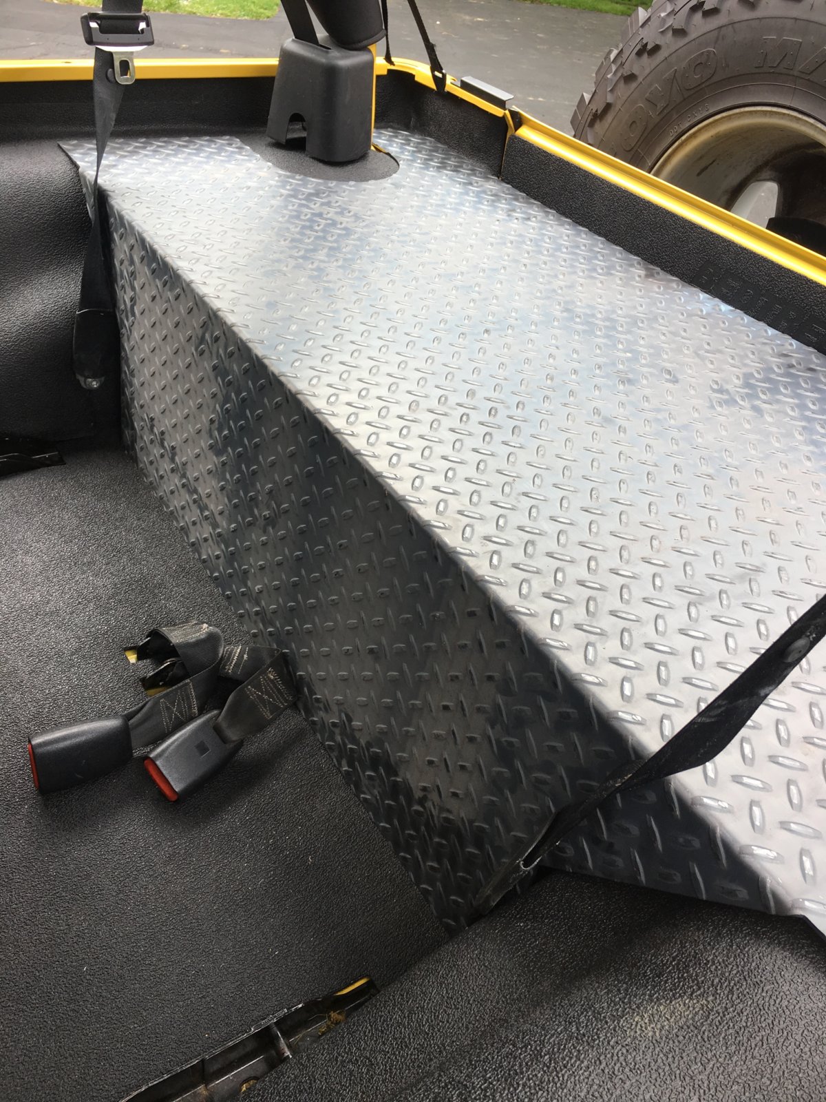

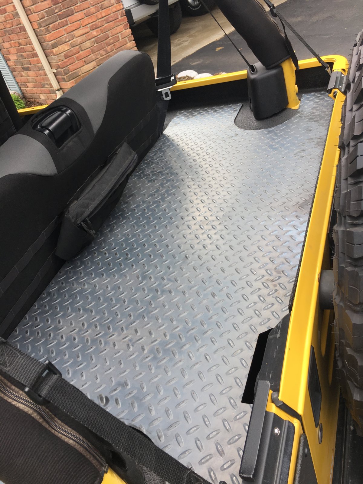

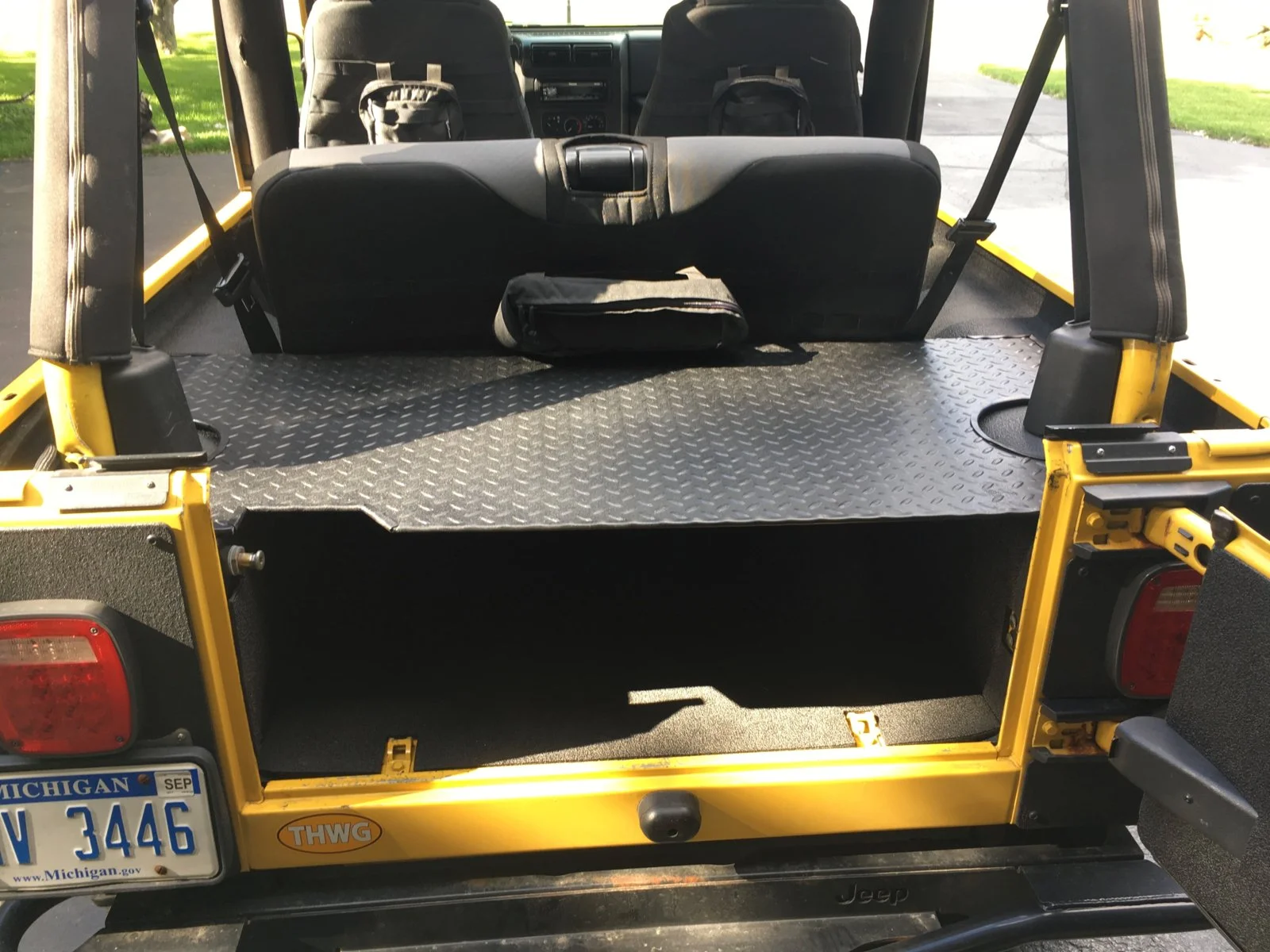

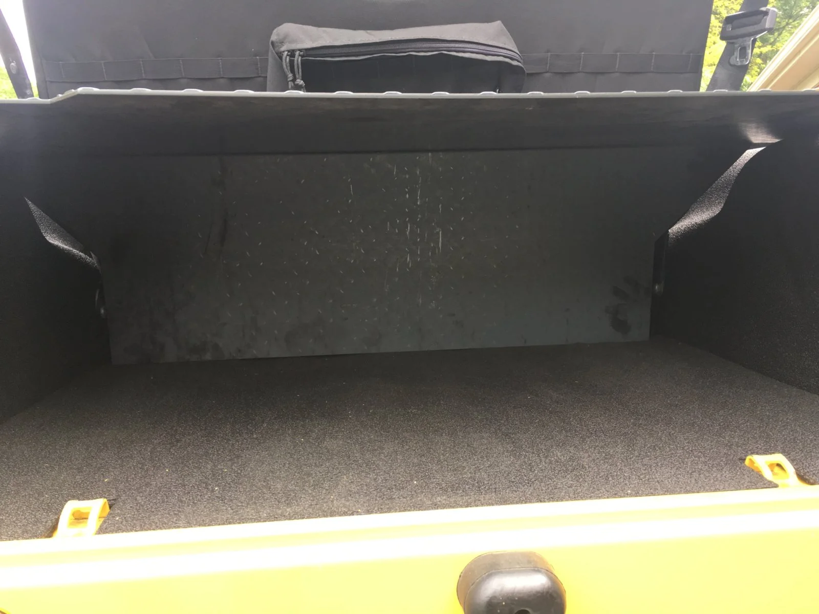

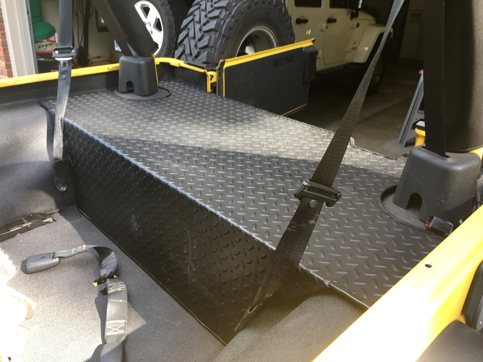

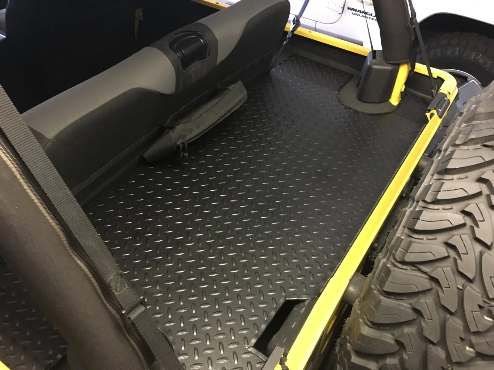

Is this cut from the plans that you posts recently?
Yes but I did have to modify where the catch is for the tailgate and, instead of a 90deg bend, I had the rear bent to 95deg to follow the line of the rear seat better. I'll make a note in my original post and update with my new plans. The only other debate I'm having is whether or not I'll need to attach it to the tie downs on the floor behind the rear seat (currently covered over by the Bedtred in my pictures). At 1/8" steel, while it can be removed by a single person, it's definitely not light!
Reactions: FF_Jeep
If you attach this to the tie down loops, does this mean your attachment will be outside of the box rather than inside? Also, being bent 95°instead of 90°, did you have to make cutouts for each of the rear seatbelt anchor?
If I had bent it straight to 90deg then the tie down loops would have been on the outside of the enclosure. With it being just shy of 90deg, i.e. bent at 95deg, it was just enough to cover the tie downs so my attachment will be inside the enclosure but stops just short of the center and side rear seatbelt anchors.
