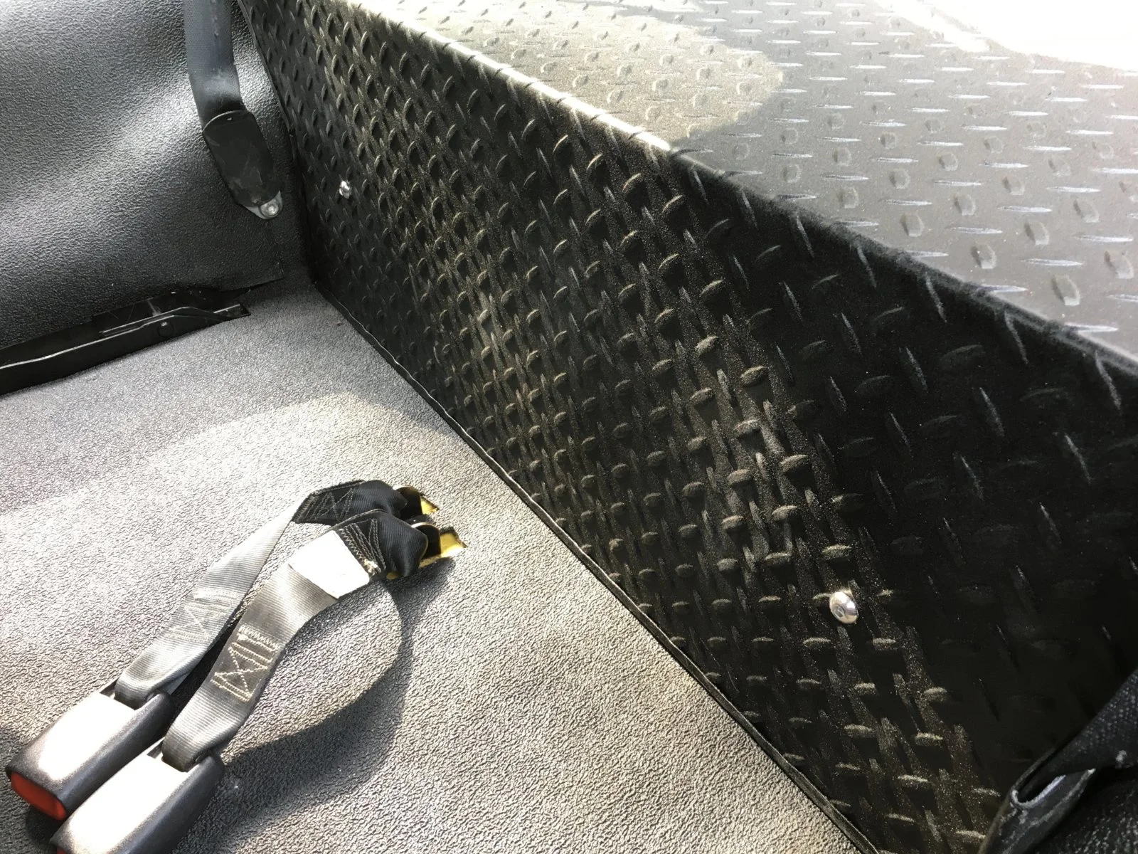

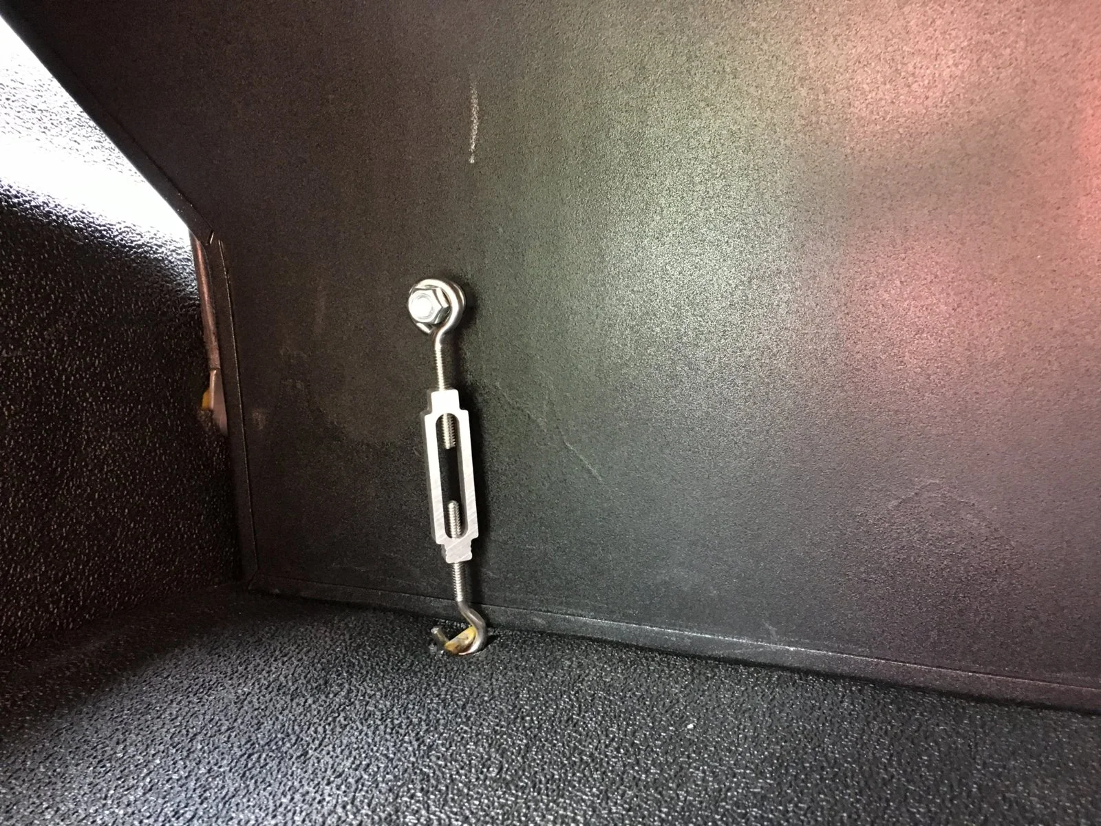

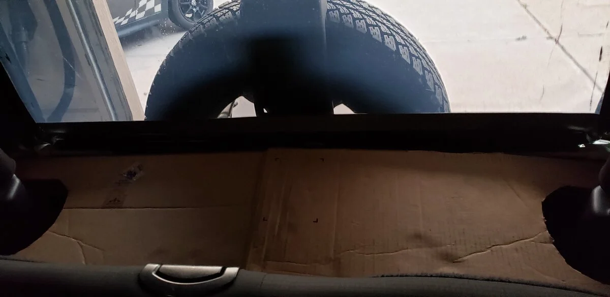

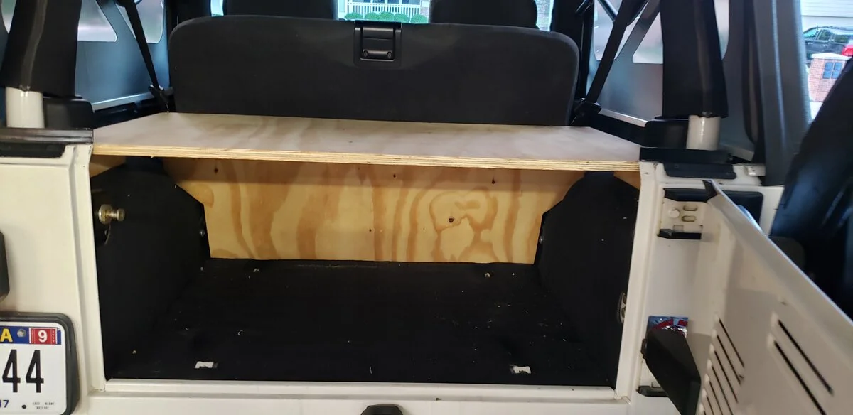

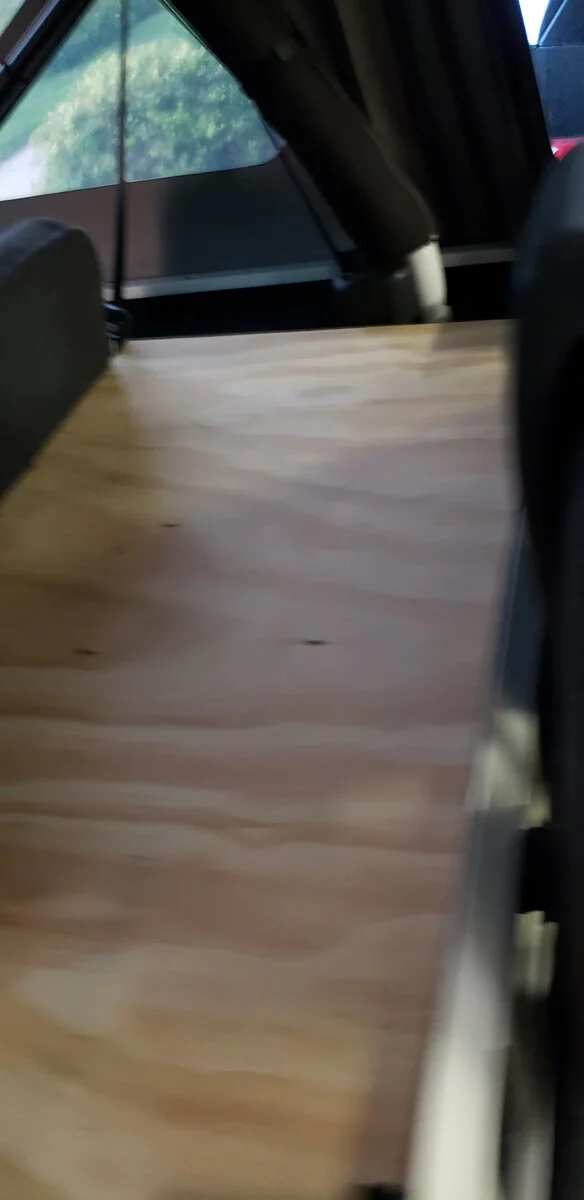

And my final piece of the installation . . . Making it a little more difficult to get into for the partially motivated. The highly motivated will be able to break into anything so this is just to keep the amateurs at bay. I drilled holes and took a pair of 3/8 x 1 1/4" button head bolts and passed them through. I attached a set of hook and eye turnbuckles to those and looped them through the tie downs on the floor of my Jeep. With both nuts on, and a locking washer, someone with the an allen wrench will find it challenging to back out the bolts. I'm debating if I should fill the hole with JB Weld and hit them with black paint.
