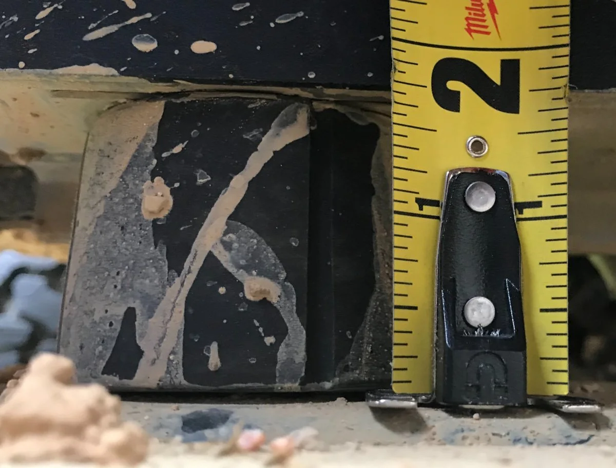

It has about 2” of space between the frame and body, so I am going with 2” lift . I was able to get it into 4 Lo and it worked, but when I pushed the locker switch nothing happens no light on switch and no light on the dash other then the 4WD in the top right corner of dash.and while I was playing with it the linkage for the transfer case “popped” out of the pivot bracket. It was in 4Hi at that point so I left it till I was through and was able to manipulate the linkage back to 2Wd. I expected that the light on the push button would flash until it was actually locked, so I figured either it didn't recognize it was in 4Lo. Looks like first thing is to remove the 2” lift and get the linkage working correctly adn then go from there.
The stock body mount is over an inch so a 2" space over the frame mount would not be a 2" body lift. Maybe a picture would help?
