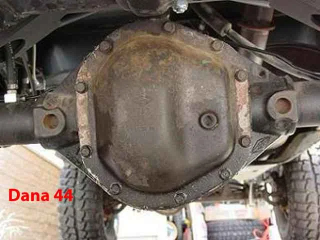

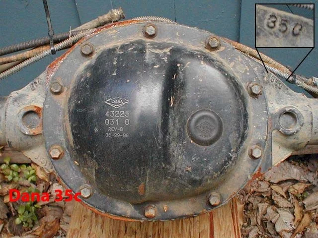

Take a look at these photos to determine if your rear axle is the standard Dana 35 or the more desirable Dana 44.
Basically the Dana 35 has a perfectly oval-shaped differential cover and it has a black-plastic snap-in fill hole plug. The Dana 44 is more stop sign shaped and has a threaded steel bolt plugging its fill hole.
Once you figure out what rear axle we can help you figure out if a rear locker is best or if a less costly front lunchbox locker would be enough.
This is a Dana 35.
This is a Dana 44.
