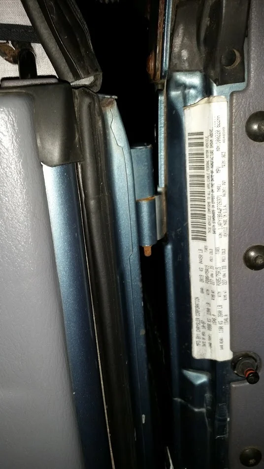

how about this
I'm not fully sure I understand the question. No doors should be threaded into the hinge. They slide in and then have a bolt on the bottom of each hinge post that screws on to hold them in.
I understand but the soft half doors have no threading on the part you slide in so there is nothing to attach a nut to
No nut is needed with them. They have so little weight to them that you don't need to worry about them falling off.
If you want to put a but on them you just need a tap and dye kit so you can tread the end. Make sense?
yes it does thanks i guess thats the reason i got the lock for the doors the half door is so easy to steal just pop it out they dont have a nut holding them so people cant just lift it up and out down Thanks Chris hate to be a pain
Not a pain at all. I know what you mean now, and if it was me I would just take the tap and dye kit and thread the end of the rods so that you can put nuts on them. That should be enough to deter anyone I would think.
If your half doors do not have a threaded portion at the base of the door pin then I would suggest that they either broke off or were cut off. If you want they can be replaced with new pins very easily.
