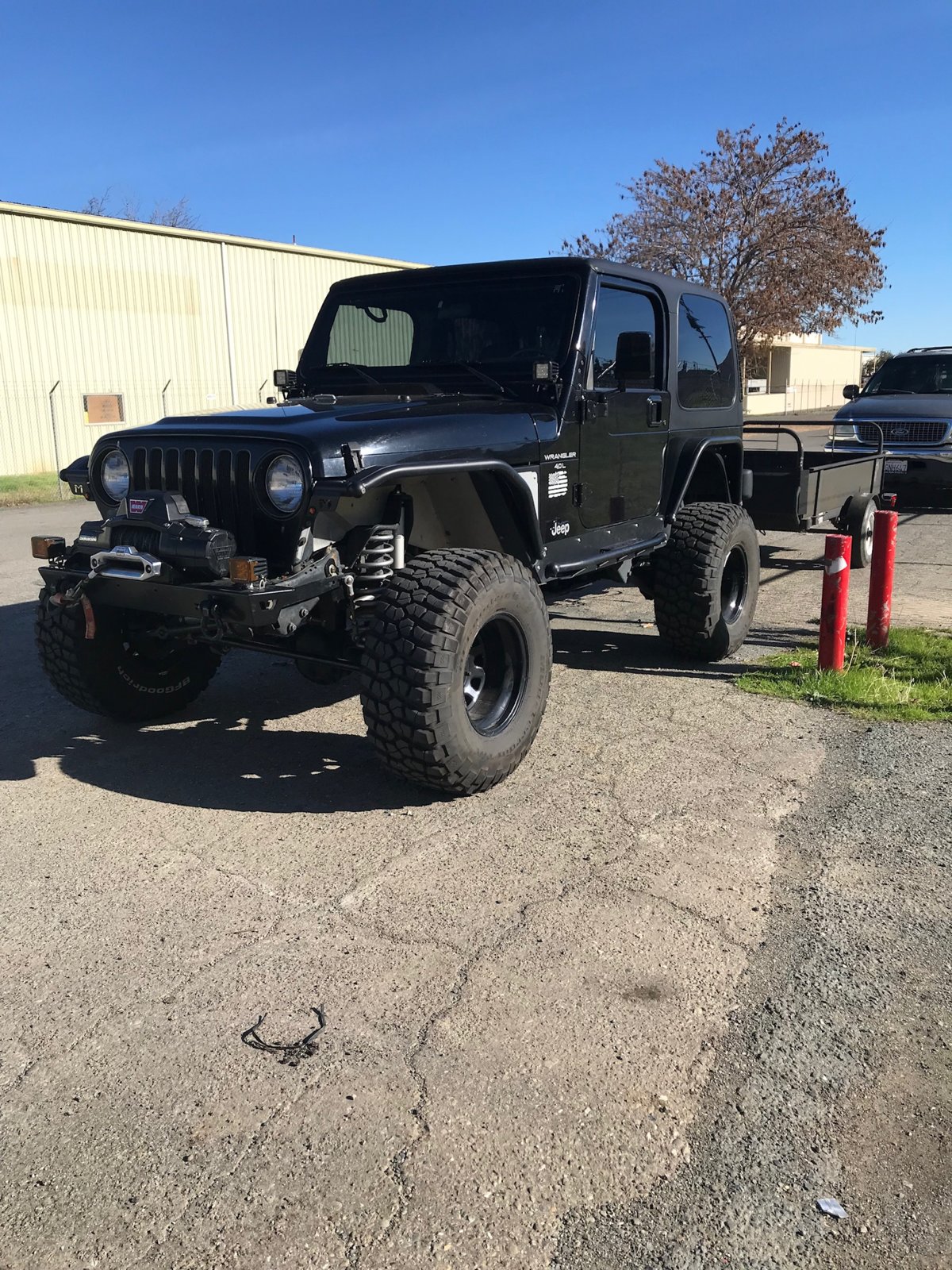

After driving it around I realized the stock 3.07 gears and 33’s were not cutting it so I started looking around for Dana 44s to regear , I struck out with finding anything reasonable so I decided to regear and install Detroit true tracs front and rear so I pulled the axles to have them regeared
80423

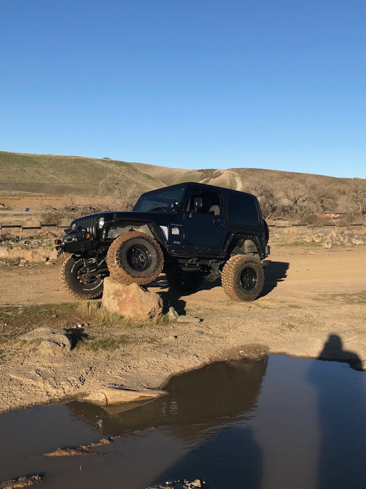

While everything was apart I came into a set 35/1250R15 General m/t ‘s so I sold the BFG’s and bought 4340 shafts for the Dana 35 , I know I’m playing with fire but with a light foot and the true tracs hopefully they last till I can find a affordable 44 to rebuild
So that’s where I’m at now 3.5 RE short arm lift metal cloak fenders and sliders, 4.88 , true tracks and 35s

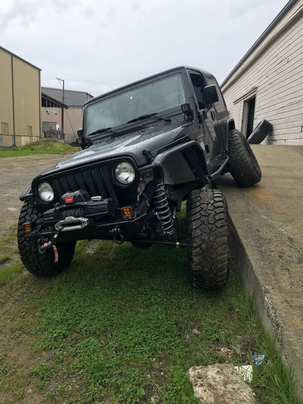

Nice lookin TJ. How do you like the Metal Cloak fenders?
im happy with them they clear the 35s well and seem really well made plus it makes the 20 year old jeep look a bit newer.

I put 30 miles on it today and there is zero bearing noise or gear whine just the occasional pop from the Detroit . I flexed it on a K rail and found I need to trim a bit from the back of the rear fender openings but other than that it should be ready for some summer trips

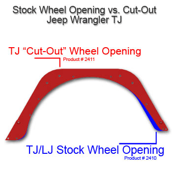

I bought the mod fit rear MC fenders so I had to trim a bit for the installation. I'm not able to fully tuck the rears due to having to bump for the shock body. I've been working on dialing in the fronts lately. My current plan for the front is to raise the shock mount in order to run 11 inch shocks while still maximizing up-travel. Out-boarding the rear is a bit outside my comfort zone at the moment but I've been doing lots of research on it lately so maybe one day I'll pull the trigger.
sounds good, It looks like I don't have the mod fit fenders so I will just cut an inch at a time till it looks clear, do you have a sideways shot of how the Mod fits look? I looked at your build thread and it does look like our jeeps started very similar. Ill be closely following how you setup your front.

I can take some photos / measurements today when I get home. I'm only working a half day today so you don't need to wait long.
For now here is the photo MC supplies
97107
The rear bottom 2 bolts appear to be in the same location on both style fenders. Seems like with a cut off wheel it wouldn't be to difficult to make yours the same size as the mod cut.
Yea some measurements at the bolts would be perfect thank you!

No problem. I've been tossing around the idea of painting them body color so if you want to stack them side by side to get an exact cut let me know.
If you have them off this weekend I might take you up on that but if not ill just try to measure and connect the dots with an angle grinder
