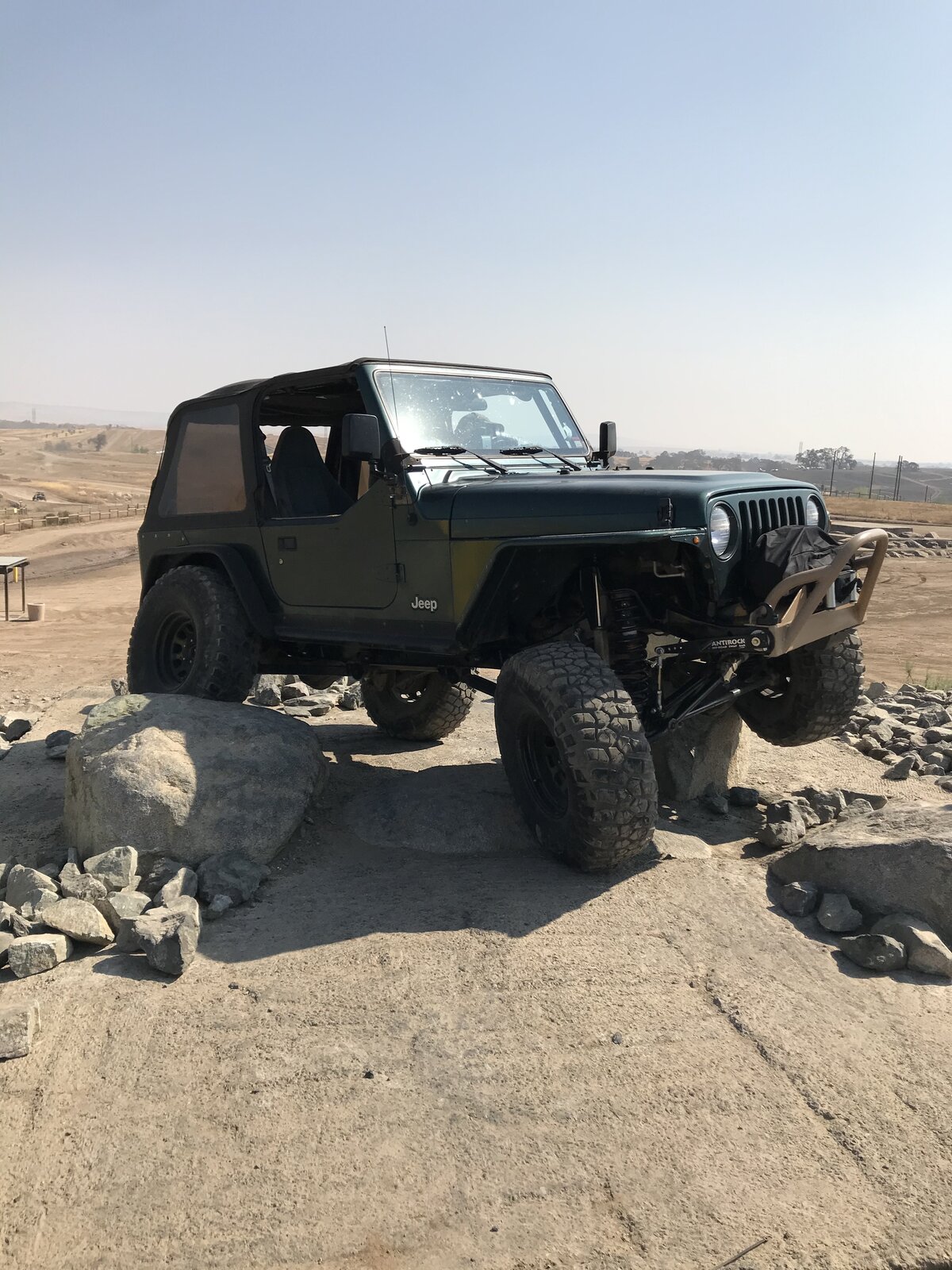

Before going out on any real trails I wanted to test the Jeep out first. So I went to Prairie city and drove around in there 4x4 course. I had no problem with anything I tried and everything worked really well . I’m happy with the locker and gear setup I just really need to address the the transfer case skid plate.

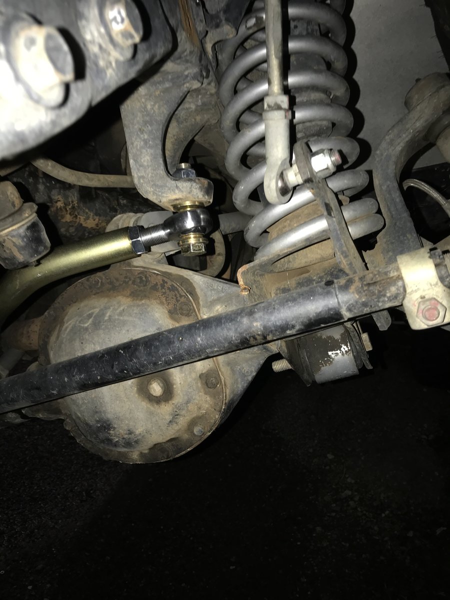

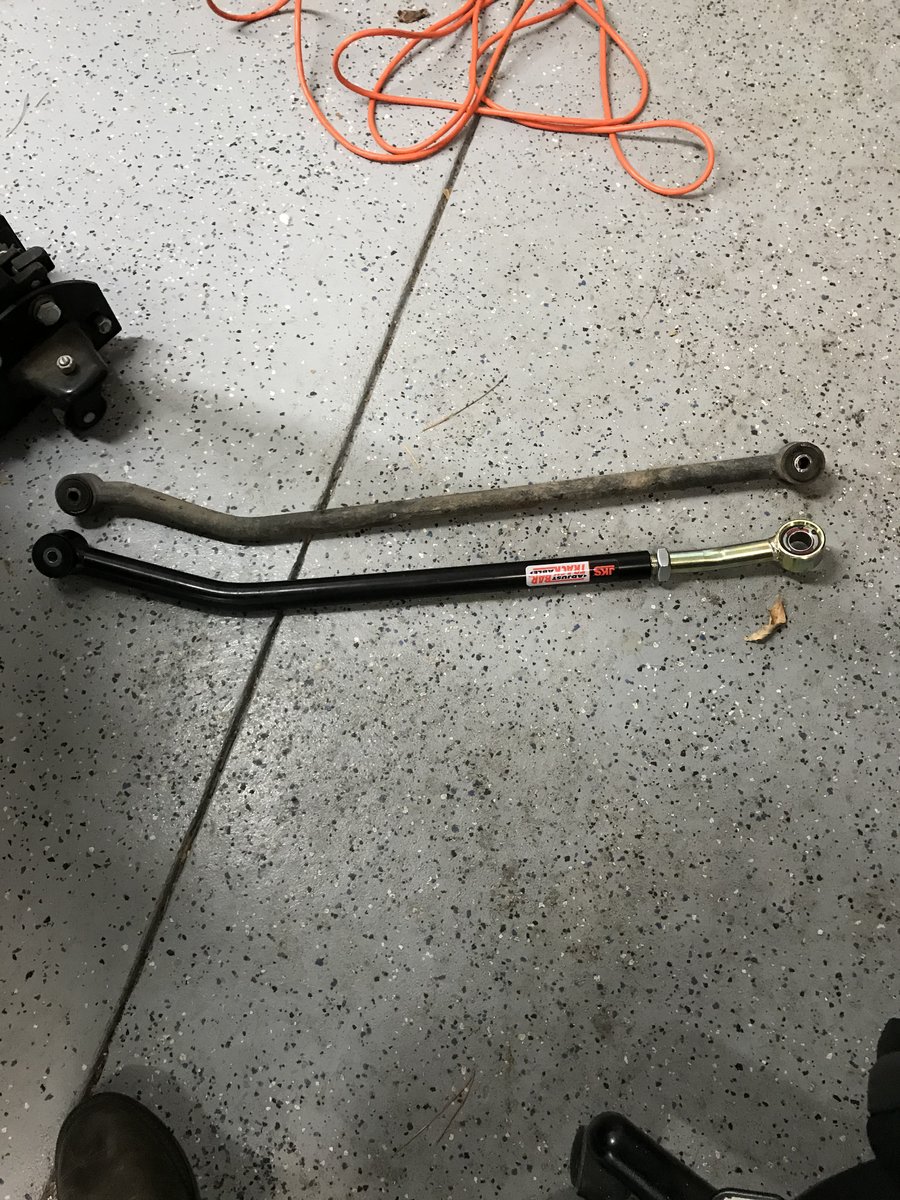

My next problem was the front trac bar, the previous owner had 4 wheel parts install a adjustable RE trac bar and a drop bracket but not a drop pitman arm. Also anytime the driver side front tire was stuffed The trac bar drop bracket hit the bottom of the coil Base and bound up the suspension
After dealing with the bump steer for awhile I decided to remove the drop bracket and install the adjustable trac bar in the stock location . Well that ended up not working because the track bar was too long , it was completely bottomed out and was still an inch off, and to add insult to injury the JKS trac bar was about 2 weeks out and I needed to move the Jeep faster than that. So I ended up with a metal cloak one as I could get it in 2 days. It went on easy and I torqued everything to spec
I went and stuffed the tire and there were no clearance issues at all, and im Looking forward to a lack of bump steer. I also trimmed the rear fenders a bit more and everything seems to be working well and its ready for the next adventure.

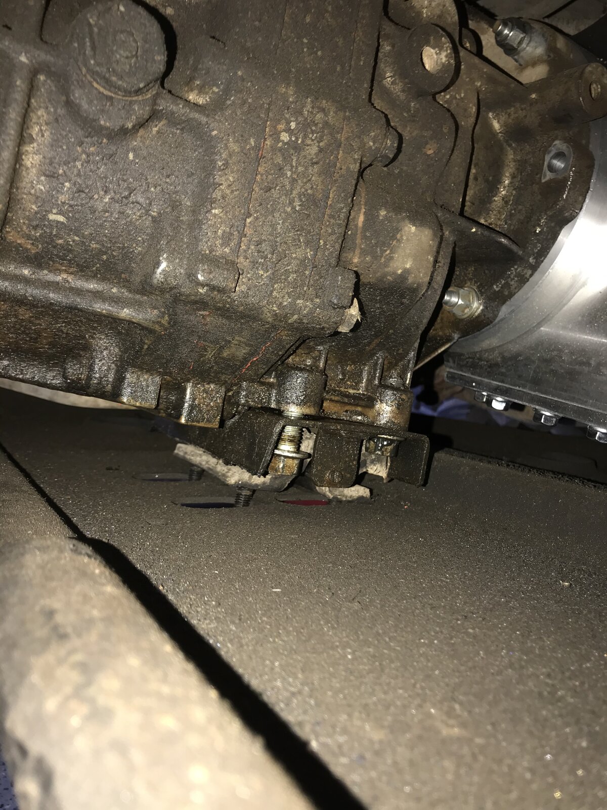

I did Slickrock trail, it was a blast , I didn’t have any big problems, I had to winch one time on the gauntlet and bent the hell out of my gas tank skid and had a dirty Maf sensor that made it idle strange.
so after that trip and following @Alex01 and @DrDmoney with their 5:1 atlas I decided a few things would have to happen.
The first thing I needed to tackle was replacing the beat to s**t stock skid plate.
I decided on a undercover fab aluminum no body lift skid. The install was pretty straightforward I tried to do it without dropping the tank with a strap but it doesn’t work as easy as the internet tells you

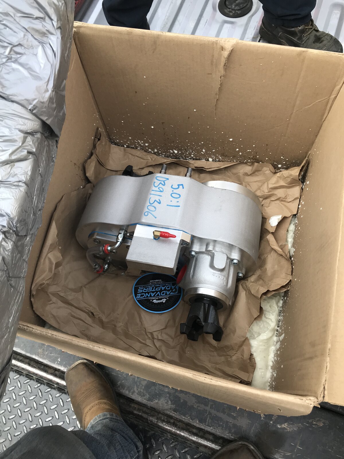

well I came out ahead on the deal so I was able to buy a new Atlas 2 5:1. I ordered it end of July and it finally showed up on Oct 8, it was a long wait but is hopefully worth it

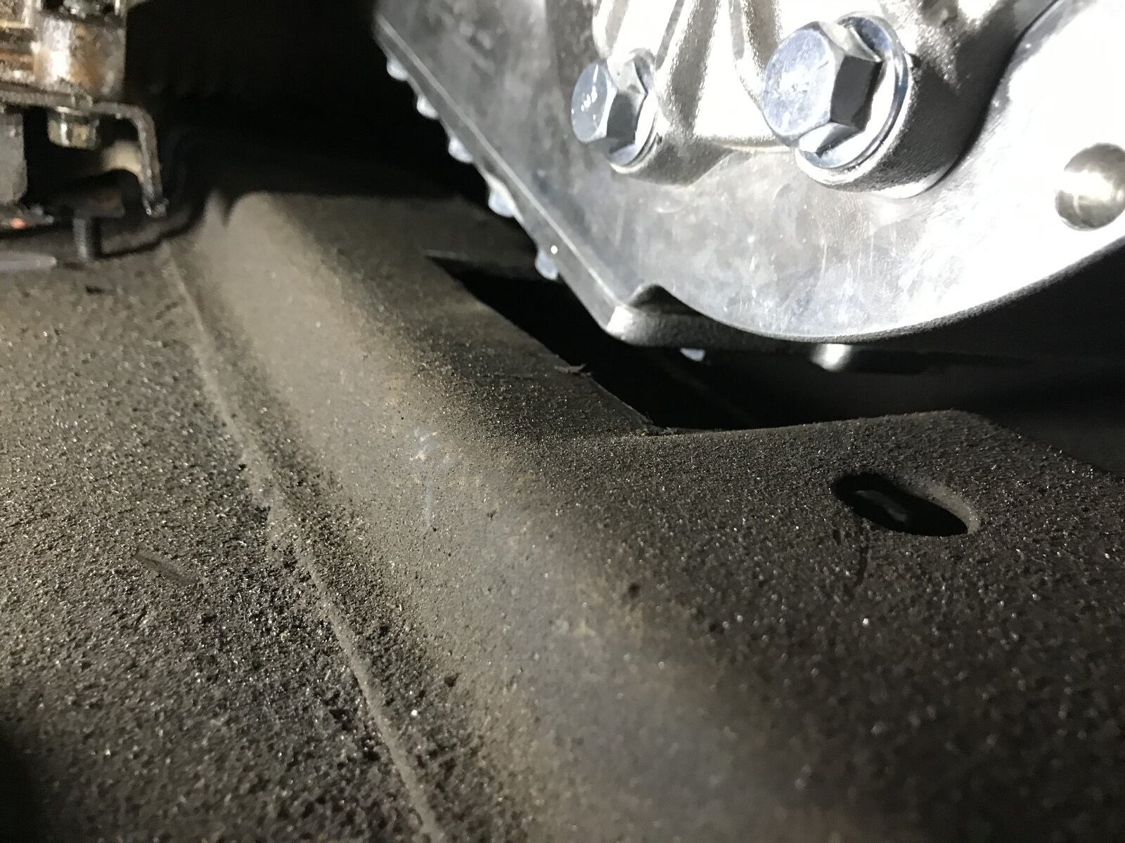

I had searched the Internet on the atlas install and there were so many different option but the majority of them used aftermarket skids. I decided I would just throw the Atlas in and start measuring on what will and won’t fit.
I started with it clocked at 7 degrees and without a body lift I knew I would need to clearance the tub
I was happy with how it sat but when I checked the front driveshaft angle It looked a little steep so instead of fighting caster issues later I reclocked it to 13 degrees and everything seemed happy. After some measuring I figured out where I needed to cut the crossmember on the skid

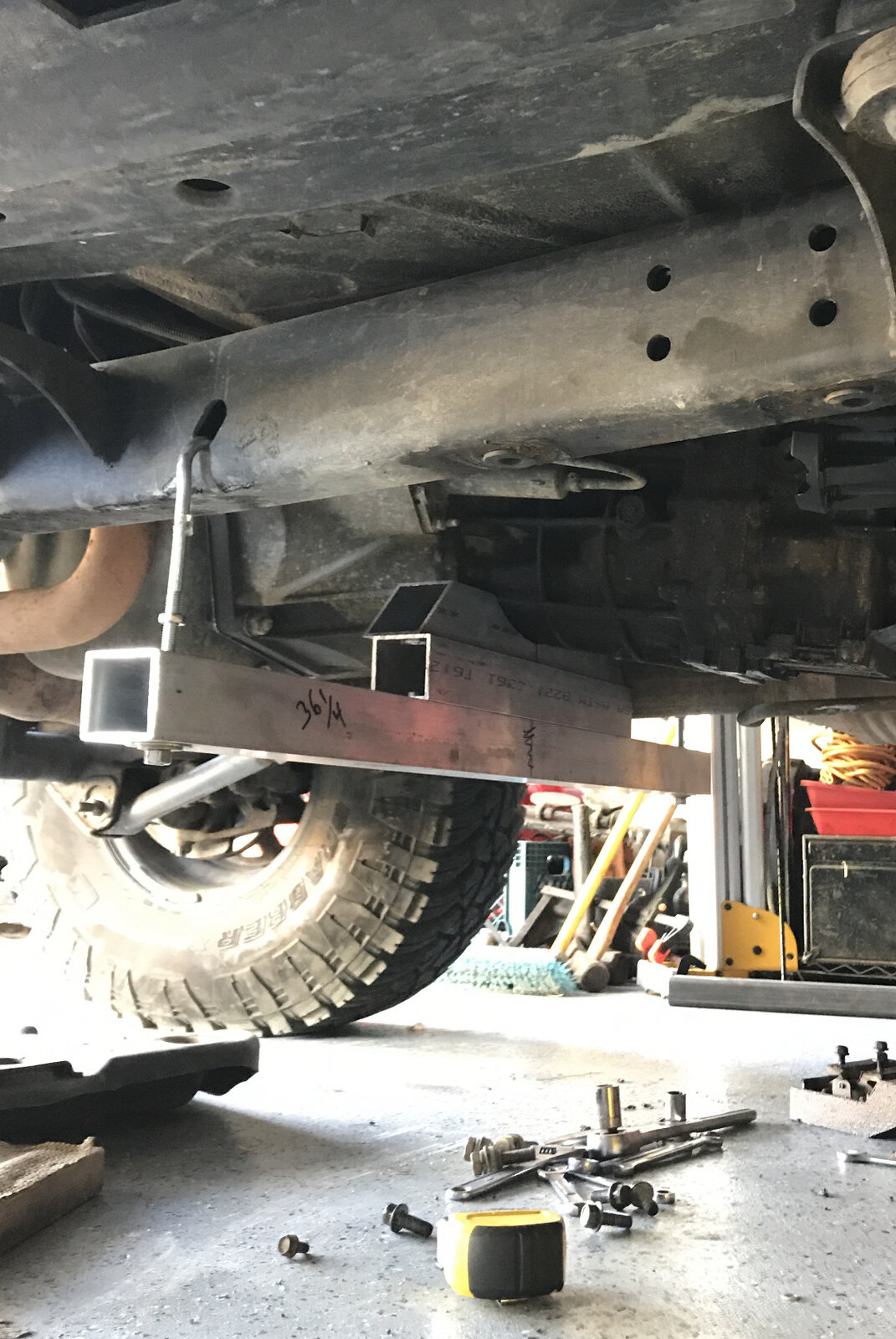

next up was trying to figure out how to make a transmission mount work. The stock setup bolts onto the bottom of the transmission and then steps back a rubber mount that mounts right below the stock transfer case. the extra girth of a Atlas makes that mount useless. I moved the rubber mount forward to mount on the bottom of the transmission and also added the exhaust hanger from the stock mount
At this point I test fit the skid and found that I would need to trim the bottom of the skid for bolt clearance, I also made a plate for the mount to bolt to and measured for the angle of the plate. Then I pulled everything back out and welded it and plated it .
Everything was fitting good at this point but it was raised up about a inch and a half because the new mount location was higher so I had to trim the exhaust to get it to sit higher without rubbing the skid. During this I ordered new driveshafts from Tom Woods and they showed up in 2 days. With @Alex01 help we got the shifters figured out and I got everything installed the next day and set the new pinion angles

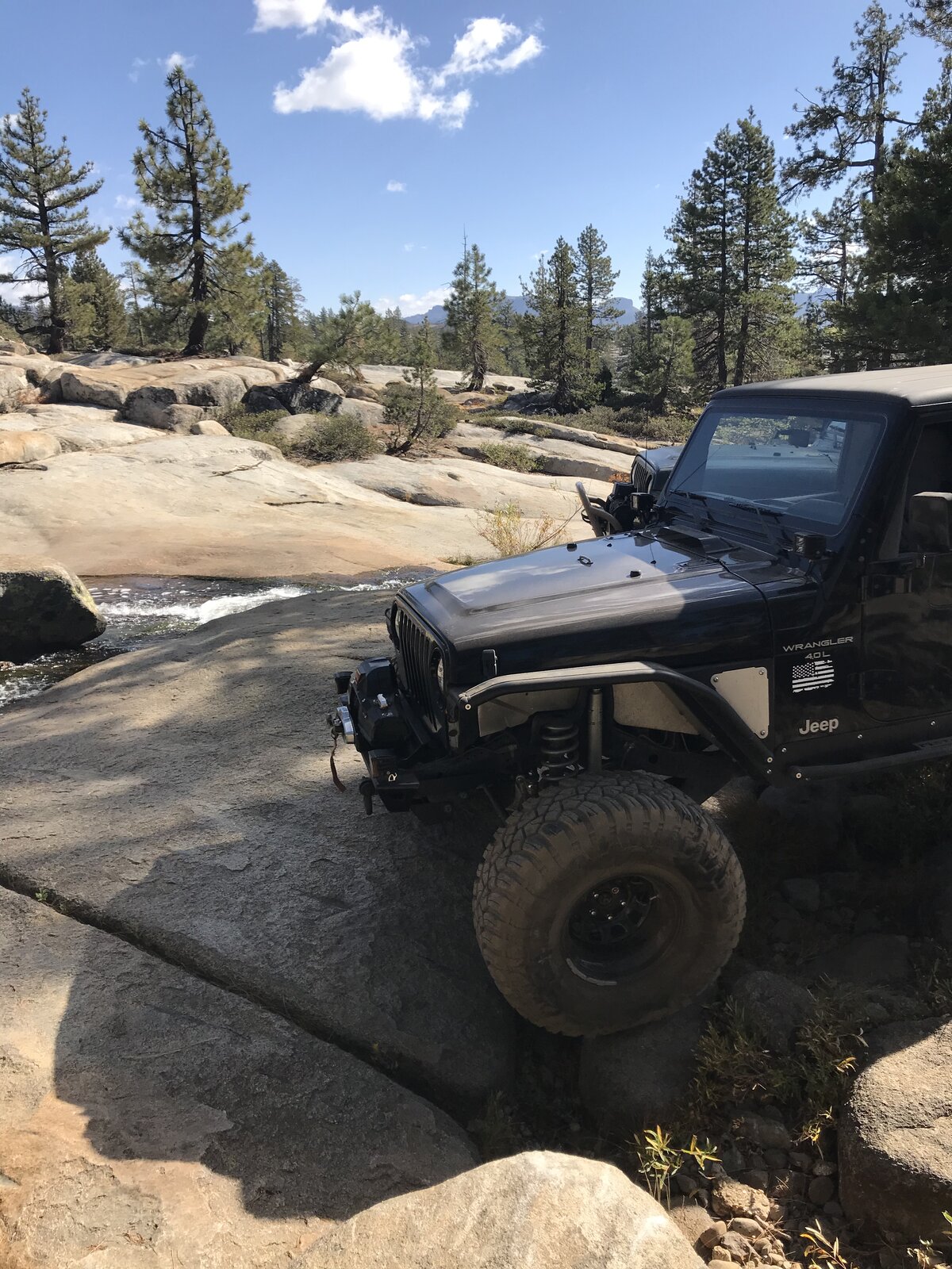

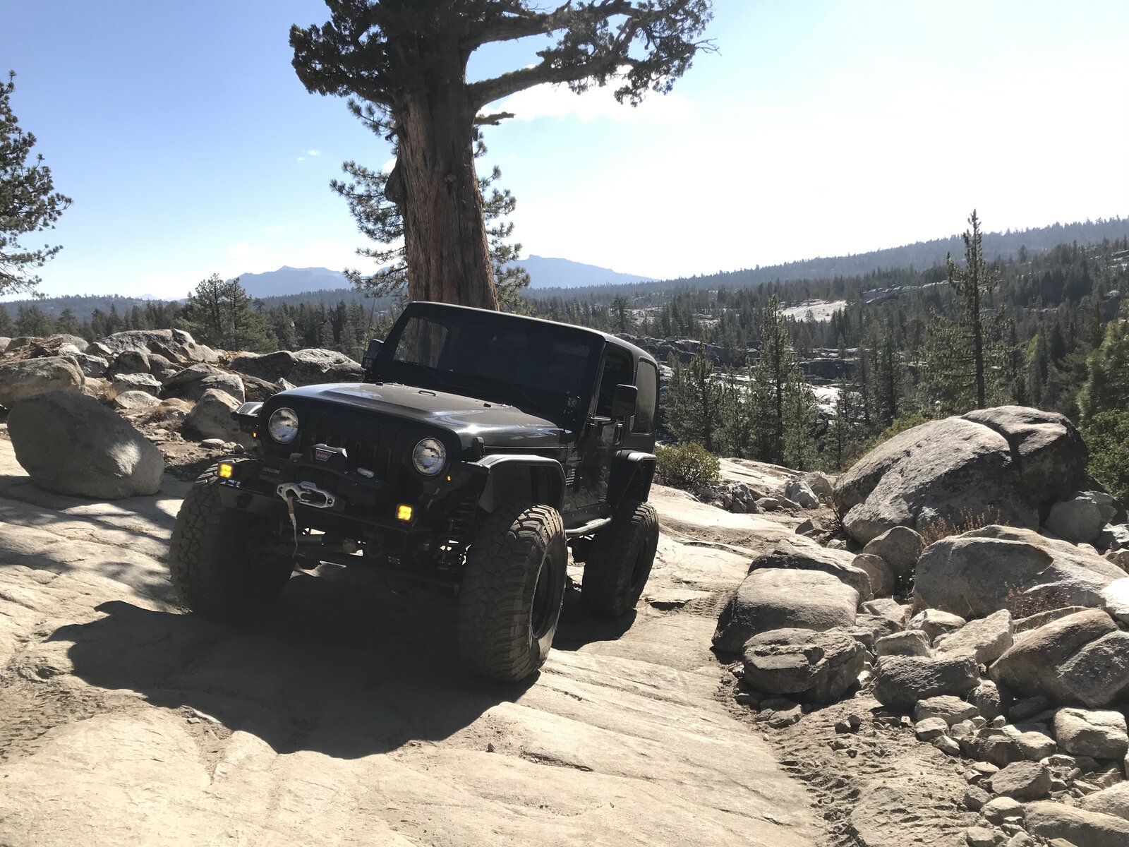

I went back and ran the Slickrock trail again and the lower gearing was a night and day difference. The Jeep handled all obstacles with a lot more control and I never had to “bump” it up anything and break traction. It worked great and seems like it is easier on the drivetrain.

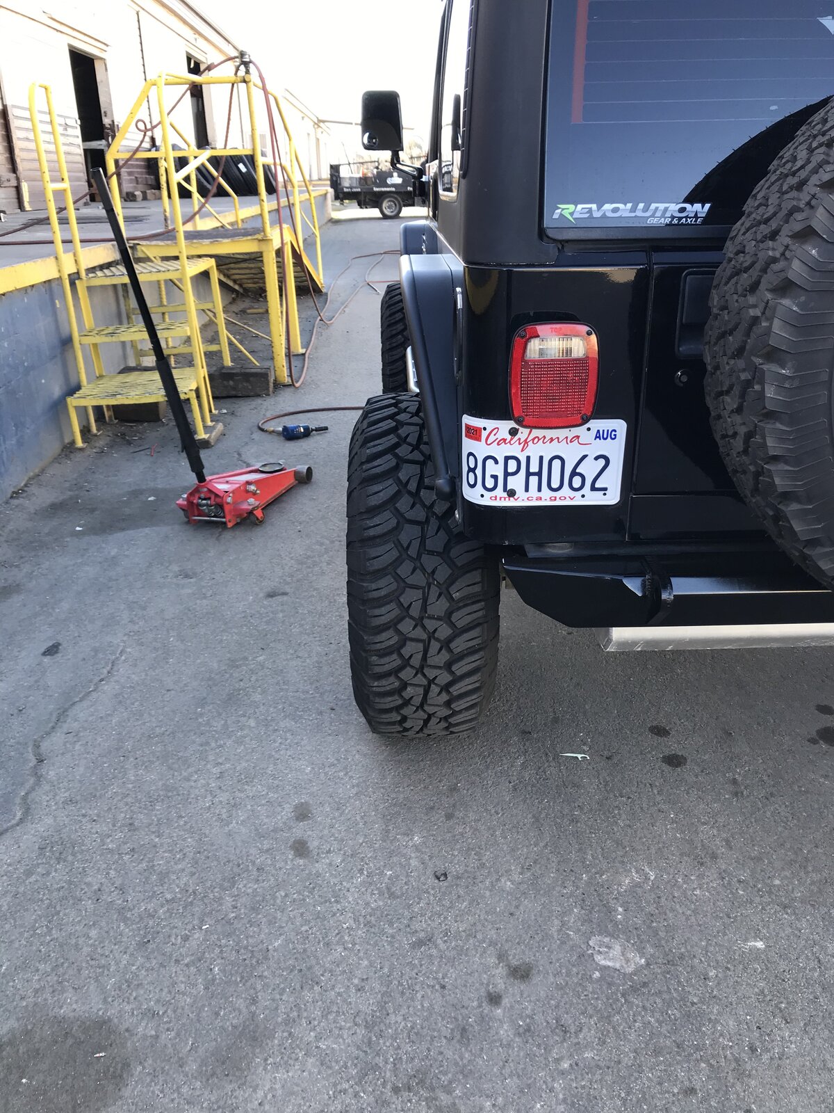

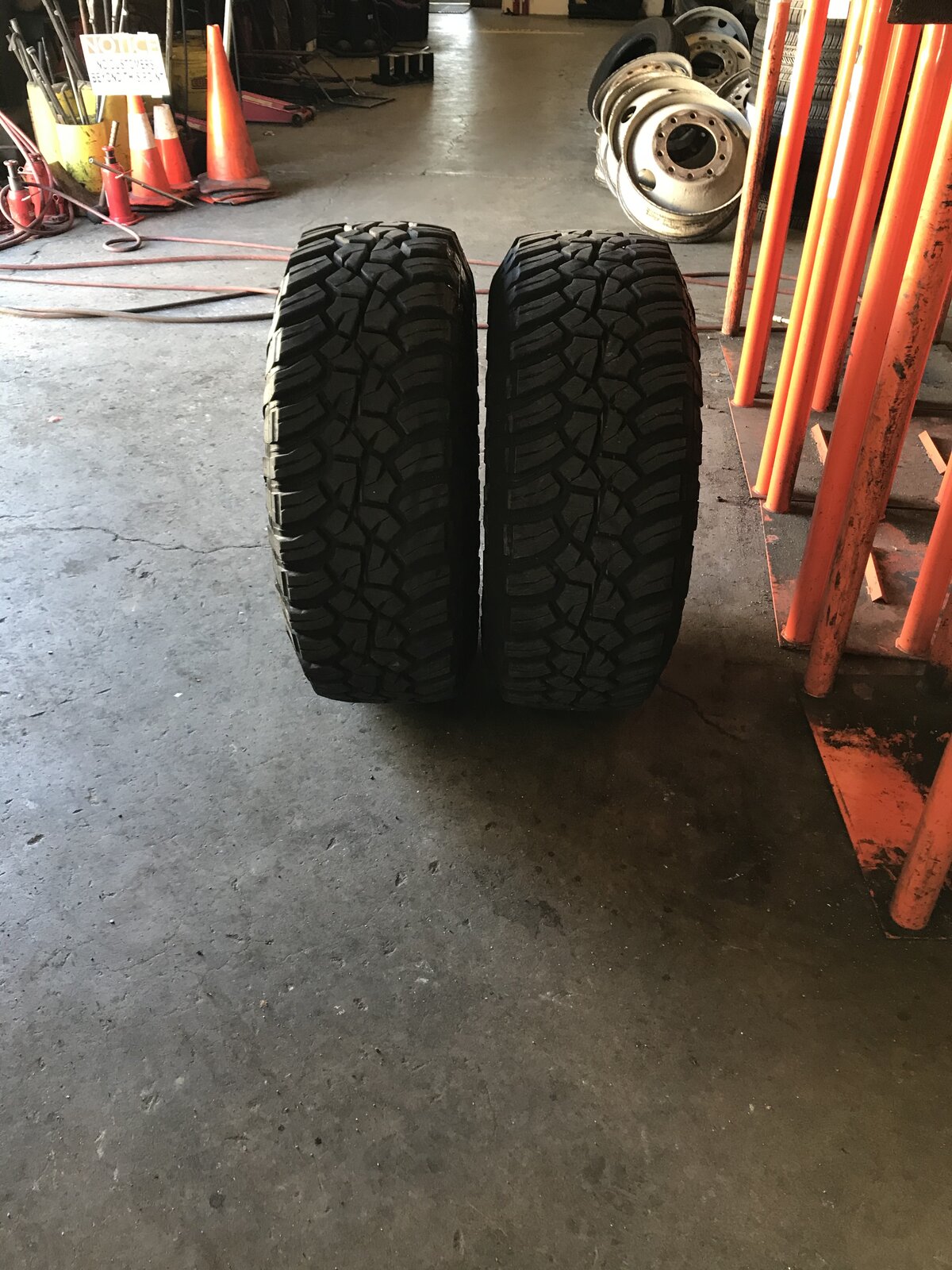

I also found some used 15x8 steel wheels and was able to swap out my 15x10s. I was always worried about loosing a bead with the wide wheels when I aired down and felt that it was putting undue stress on the bearings and ball joint.
here are some comparison pics of the different widths
