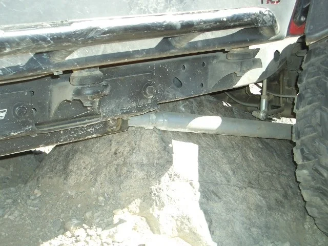

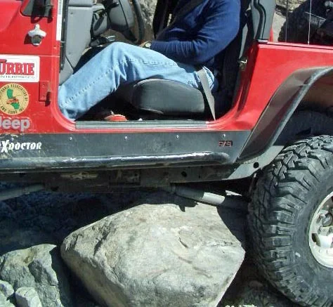

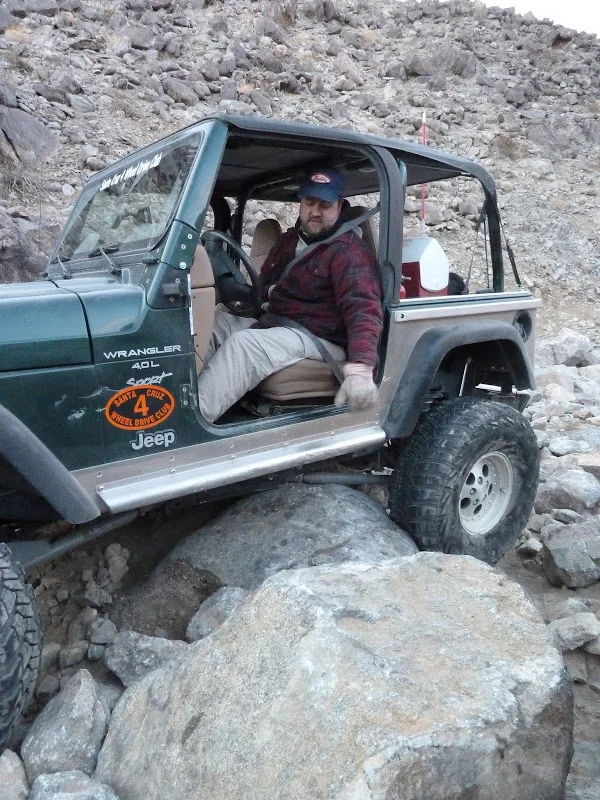

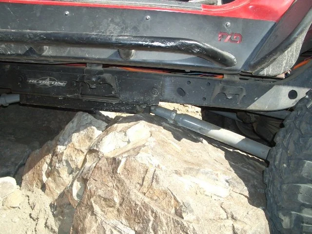

With the exception of the green Jeep I was on the trail with, all of these are of my previous TJ with its RE longarm suspension. The meme at the end was made by a friend after mrblaine shot that pic of my TJ. I don't know of any serious rock crawlers that I wheel with that use long-arms. Most of my red TJ photos were taken on a trail called Sunbonnet in Johnson Valley CA and I was the only Jeep in a large group of exceptionally well built Jeeps with a long arm suspension. They were all giving me crap about it before we even started the trail, they knew better & I didn't. I haven't run a longarm suspension in over ten years now and I haven't had a control arm hung up since. My current Currie short-arm suspension does EVERYTHING better than my previous LA suspension did.

True. If I had the $$$ I'd go with Savvy's exceptional mid-arm suspension as it just plain works without the arms being so long that they get hung up.

I can tell you that if you play a lot in the rocks, the long arms will get hung up much more frequently than a short arm lift. Maybe if you were running 42" tires or something, this wouldn't be such an issue. But with most of us running 33s or 35s, it becomes an issue.
