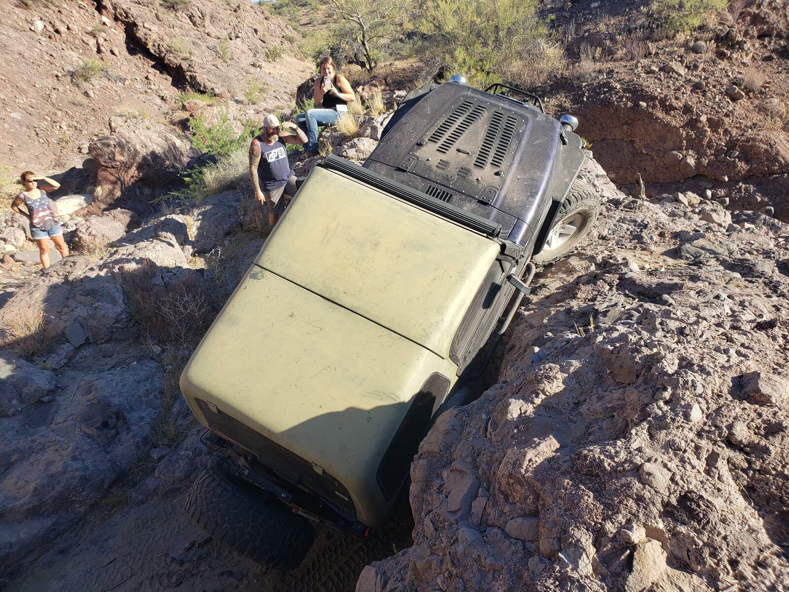

It works, just light in front when climbing really steep stuff.

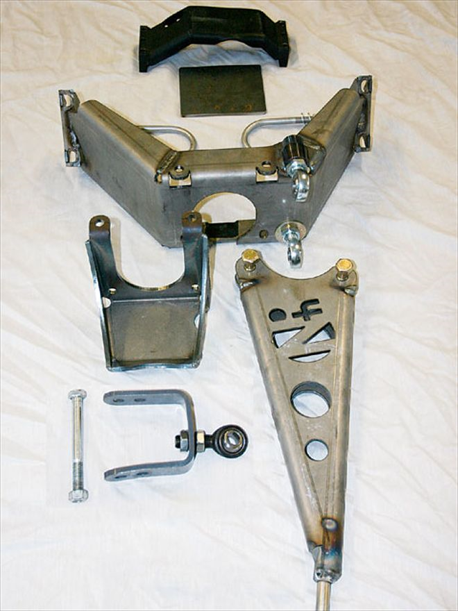

So does @Wildman does your nth seem to have a design problem causing it to go light when on steep climbs or was it a different lift?
I don't really know. The kit I had used a universal bracket for the HP60 rear axle and I always felt this might have been part of the problem. But I've never wheeled with anyone else who had a Nth Degree kit to answer that fully. I'd like to see a kit on stock axles and coil springs and see how it reacted on steep climbs.
I've known a few people with the Nth rear stinger kit. It had a LOT of antisquat it looked like. A buddy broke stuff a few times hopping around. He now has a custom 3/4-link.
Reactions: Wildman
That would be my experiance with it and WHY I'm swapping it out.
The popping problem may have been from the universal kit but the geometry is still the same. I think is has more to with the instant center being at the back of the transfer case. So this gives you high antisquat and since the instant is well behind the center of gravity I can only imagine what is going on when you point the nose in the air. The idea of a torque arm works well in many applications like Camaros, Mustangs and even Jeeps while on the street, as it reduces torque roll, and can really plant the rear axle in straitline acceleration. We just do not operate on the street or strip is all.
Reactions: Wildman
