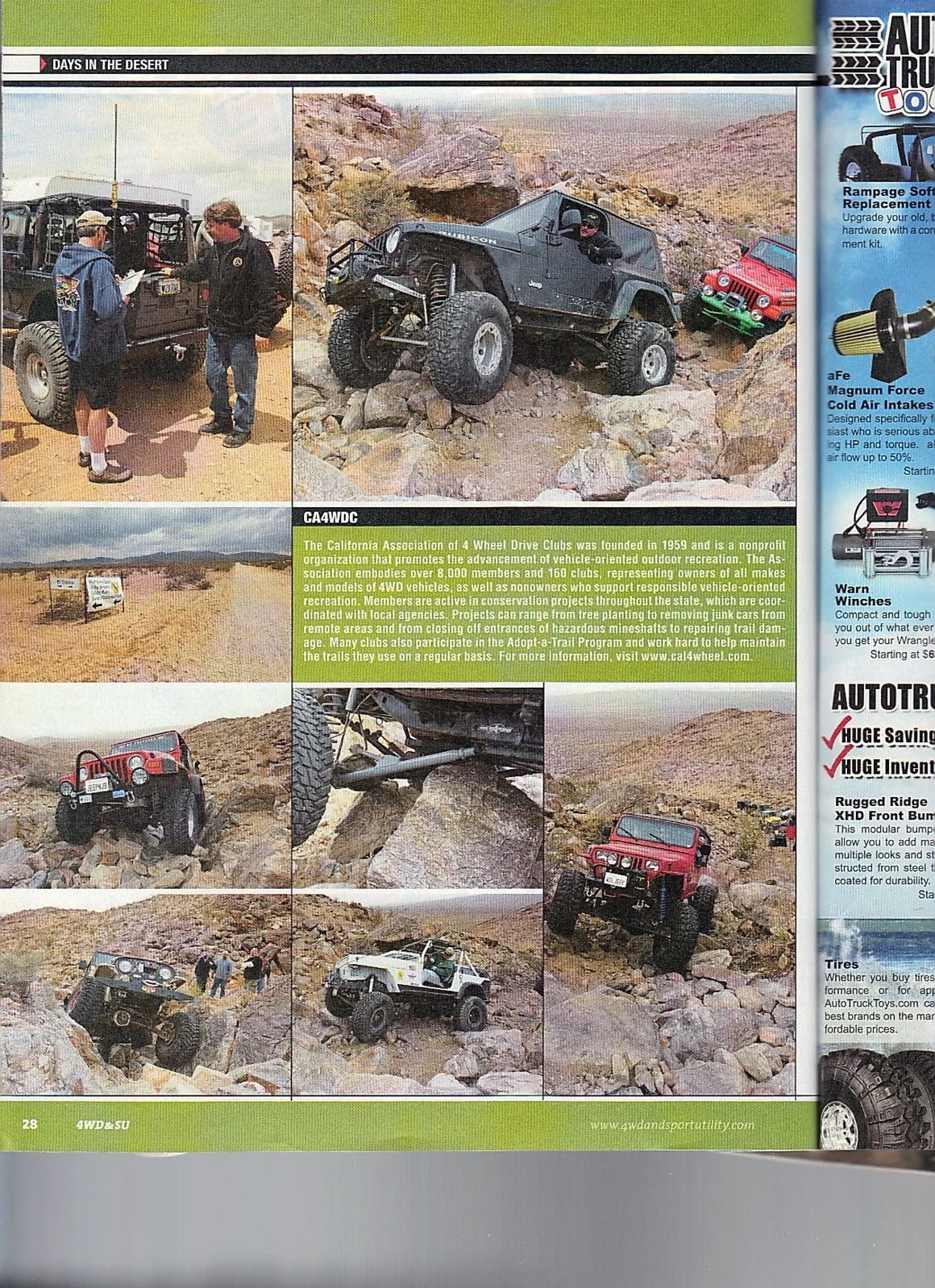

Having run a short arm suspension for years on my previous (stolen) TJ, mostly wheeling on the rocks, my current Currie short arm suspension outdoes it in alll important areas. The only thing my previous long arm suspension was much better at was getting hung up on the trail obstacles more easily. The one time my TJ made 4WD & Sport Utility magazine was when it was hung up on a trail, jammed up on a lower front long arm.
The two pics just below the mid-point of the page show my previous TJ and one of its long-arms hung up on a rock.

I could certainly see how a long arm system would be much, much easier to get hung up on trails.
Very good article Jerry! I think that photo of your TJ hung up on the rocks clearly displays one of the disadvantages to a long arm kit. This is one of the reasons I've decided to stay with short arms.
