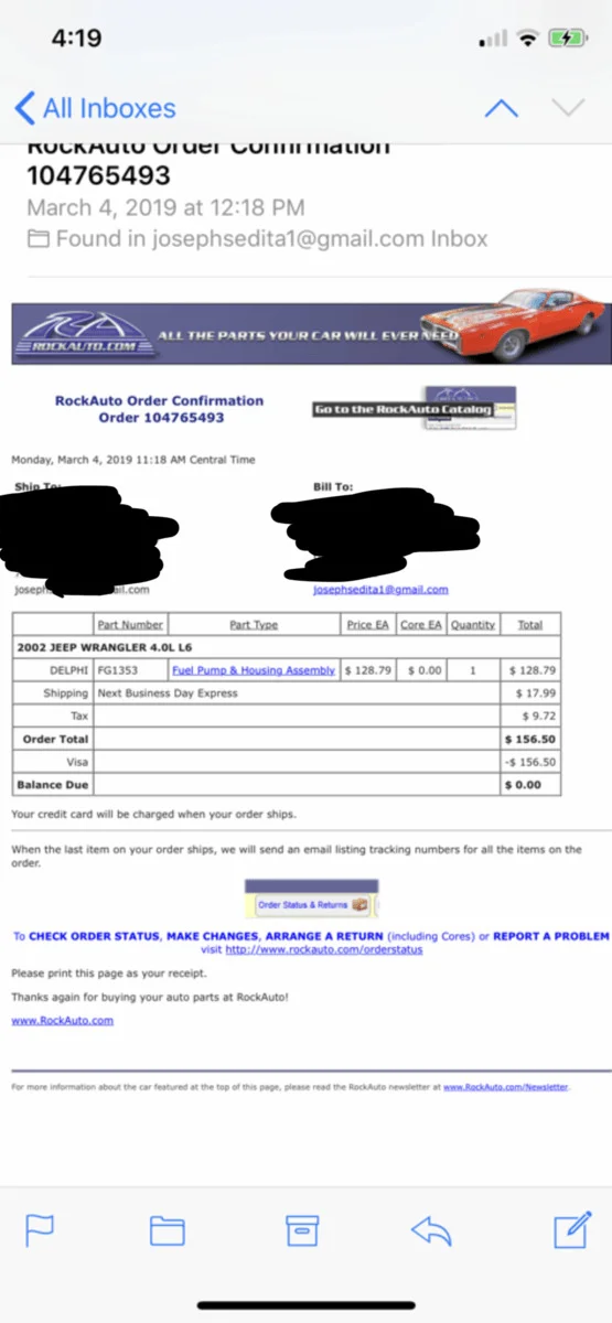

The long crank went away and came back for the colder weather. I just did this fuel pump in March, is it really possible that less than 7k miles/6months later it’s gone bad again?
Went to start last night at the bar, long crank for 7-8 seconds and died. Fired up right after that. Leaving the next bar, same thing only it didn’t die. This morning again, same thing. Except when I started taking off, it felt a little hesitant. Maybe I’ll just get a subaru lol
Does anyone have a recommendation for an assembly?

Bosch is the best fuel pump replacement out there, but since they no longer make them, you have to look for them as leftover old stock (eBay usually has some).
However, Delphi I've heard good things about, and it's highly unlikely the fuel pump would fail again after 7 months. At that point it has to be something else I would assume.
