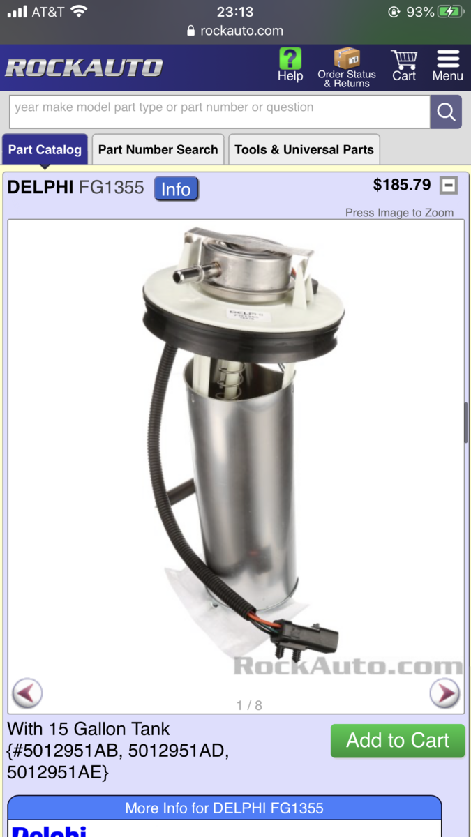

@Jerry Bransford my 97’ 2.5l is having the exact problem. Just replaced the starter but still has a problem turning on until the second one like the video shown. Will the screenshot I took be the right choice?
That is not the number I used for a 2003 but yes, that is what you want. Check the pert number for your year. I found them cheaper on amazon.

Yeah sorry, that’s I meant. So pretty much after a night of sitting, when I go to crank it on, it doesn’t turn on till the second time just like the guy in the video on this thread showed. After changing my starter I still haven’t solved the issue. Is the pump I screen shotted from Delphi good or not the one for the 2.5l? I believe it’s 15 gallons if I’m correct

Yes the FG1355 is the correct Delphi fuel pump if you're absolutely certain you have the 15 gallon tank. Generally speaking even the 2.5L Wrangler SE came with the 19 gallon tank unless it was a very stripped down/basic SE.

"Yes the FG1355 is the correct Delphi fuel pump if you're absolutely certain you have the 15 gallon tank. Generally speaking even the 2.5L Wrangler SE came with the 19 gallon tank unless it was a very stripped down/basic SE. "
And if you have the slightest bit of uncertainty you can enter your VIN into this website to get your build sheet (All caps, starting after the equal sign) https://www.jeep.com/webselfservice/BuildSheetServlet?vin=
