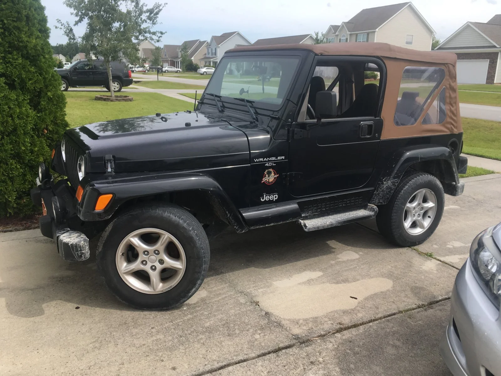

    31x10.5 will be good for now. Save money for new wheels by not buying spacers. Are they really 16" rims? I hope they're 15's. Lots more tire choices. Here are my 31.5x10.5 on a 15" rim with 3 5/8 backspacing if it helps.

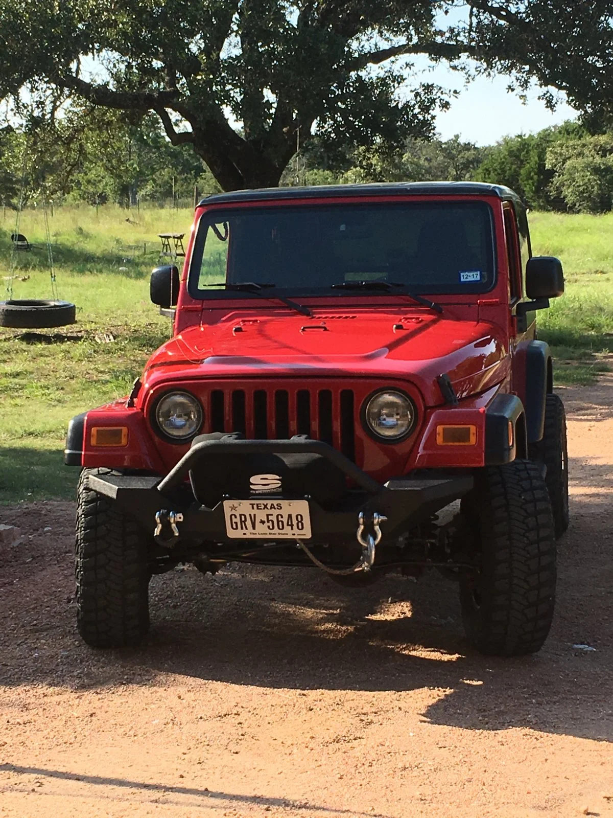

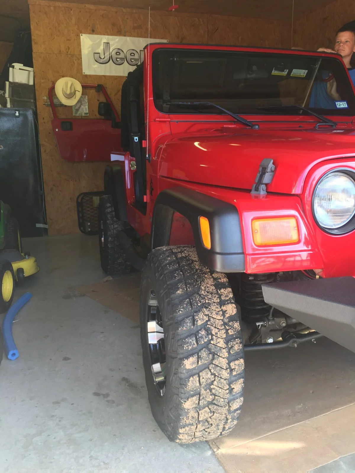

    First off, really appreciate everyone's input. Never hurts to get a second look at a project, and you all definitely helped me pick out a great product. I decided to go with the Falken Wildpeak A/T3W tires, however I did go up in size to the 265/70/R16. They look awesome compared to the old tires and drive. Since the install, I have come across two minor issues: at full turn there is a bit of rubbing on the backside of the tire, and the stock spare tire holder can't hold the new tires. Neither issue is a deal breaker, and I'm already working on fixes for both. Here is an updated pic of what she looks like now: IMG_3198.JPG
