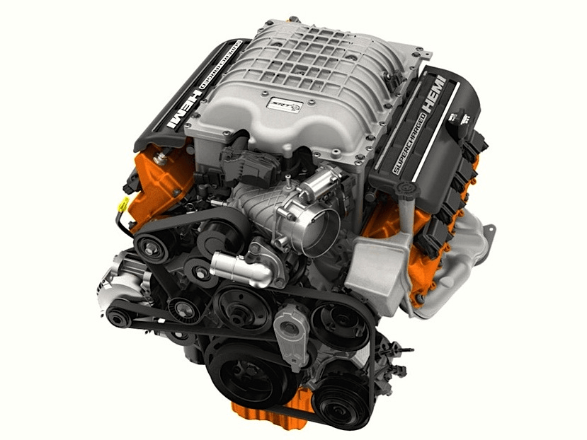

Go big or go home. I haven't heard of anyone putting a Hellcat in a TJ, but you could test that out for us, right? I mean, 707 horses would be a nice little step up from the 2.5L stock engine, I'm sure.
About 700 horsepower in a TJ .... that would be something.
I want to stay around 300 -350 HP so I will probably go with LS1 unless I can find a 4.0L.
Either way lots of work but that's what I call fun, 👍🤗
