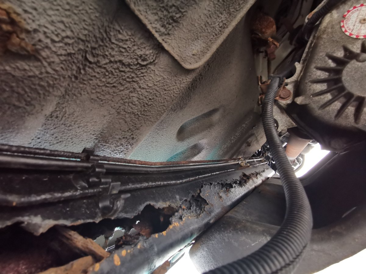

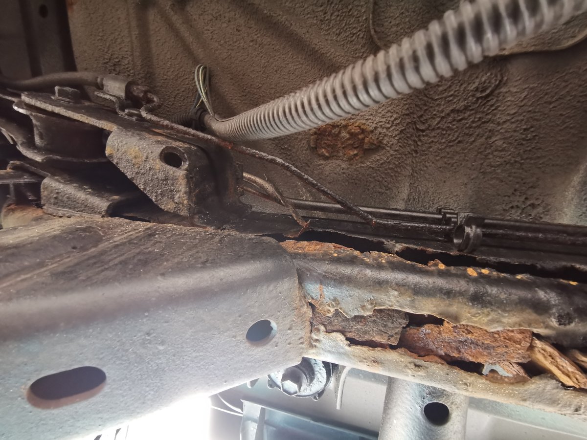

I picked up my first Jeep yesterday, a 1997 TJ (Sahara) with 180k on it. I've been looking for a Wrangler for about a year now and I did a decent amount of research so I somewhat knew what to look for. This beauty is originally from NY and had 1 owner prior to the guy I bought it from who had it only a few months. Turns out the body and tub are somehow in fantastic shape for it's age (fenders, floorboards, rockers all solid) but the frame is in pretty bad shape - especially on the drivers side.
I knew going into this I would have a major repair on my hands right out the gate, but the price was right and with the condition outside the frame I couldn't pass it up. However, now I find myself in need of a welder who's had some experience in repairing these things. I figure I'd source the parts needed from Pocono (spoke with them today). I'd like to do the drivers side ASAP as I believe I can get away with the passenger side as-is for another year (it's in much better shape).
Can anyone recommend a shop here in NJ/NY that can handle this for me and not whack me over the head on price? I've attached pics of the rot
All input is appreciated. Thanks in advance!!!

Call Oskar in linden he specializes in frame repair
I got a quote of $2000 to do both sides. Seemed very reasonable to me but like I said, he's out in PA. I was hoping to find someone closer.
Hello, I was wondering if you actually found someone who helped you out? I am from Jersey as well and dealing with something similar. Thanks.
