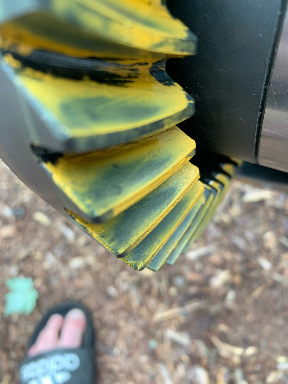

So this is the latest pattern, been on and off raining so haven't got much done... Pretty sure it is the exact same as the first pattern that I had. Everything I had written down got soaked with a nice, out of nowhere pouring rain (the axle was under a tarp!!) lol. If this is too deep I have a few choices for removal, and replacement. Thanks for all the help thus far!

That does look like you are very close to where you started. You do look to be a touch deep and I would try to pull .003 out of the stack and try again.

Had a quick break in the rain. Headed to practice now, however, this is the pattern after removing .003 My guess is it is a touch shallow and add 0.001? That is just me trying to learn and make the dana 30 quicker! This pattern is with a backlash of 9 thousandths.

Drive is starting to look good... Coast is shallow... But I thought your patten before removing 0.003 was shallow too. Since you don't know what your 1st pattern was, I'd go much deeper from what you are... Like 0.010 thou. See what that pattern looks like. It  should be obviously deep, if the rest of your set up is predicable. Since your backlash is a bit loose, moving the pinion that far will probably not require and change they're either (high gain for low effort) With that, you have it bracketed and can really start to dial it in.

I tried with the 0.01 shim, deeper than the original, and makes its way too deep. After that, I run out of shims from what came in the kit. From that pattern (with the .003 removed) I can only add a shim that is 0.013.
edit: that's where the I need more shims came in. In that pattern before the .003 removed is the drive too deep?

Both your drive and coast look shallow to me in that pattern. I'm not an expert though... You really should get some more shims.

Hm okay. I did like the fact there was a slight line between the tops and nothing harsh on the bottom where it made contact (before removing .003)... Going to wait for a couple of others to chime in and then pick some up after most likely.
