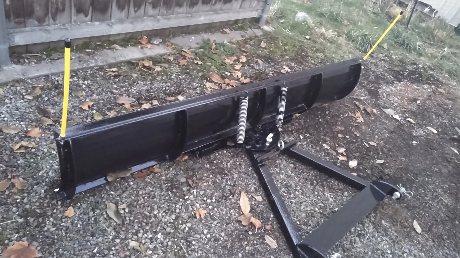

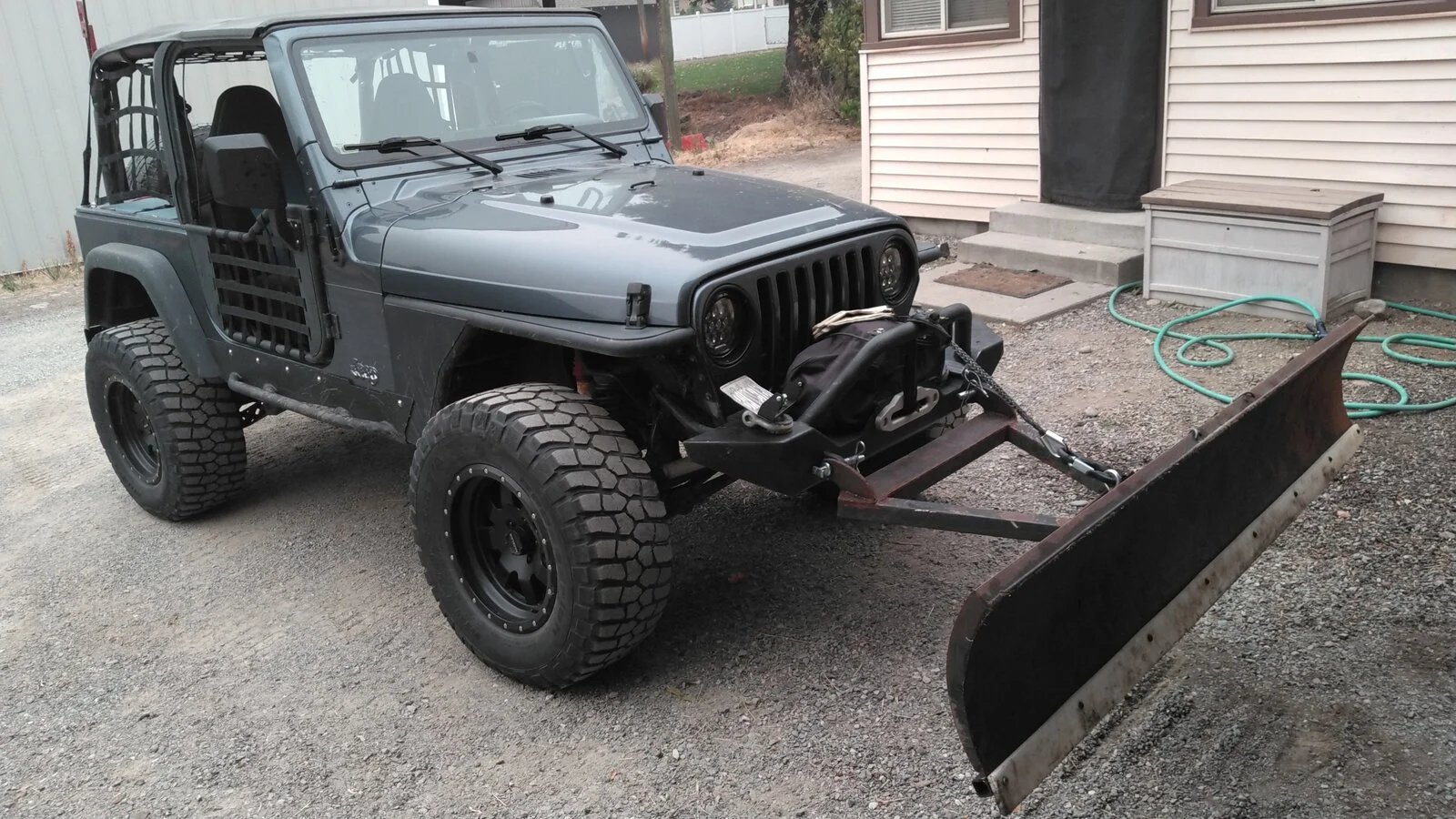

I bought this off Craigslist last summer do I don't know a lot about it. It was pretty rusty and sitting in a pile of Jeep parts on the side of the guy's house. There's no tags or badges on it. But it was clearly made for a Jeep. The mounting tabs are the same width as the recovery tabs on my Smittybilt bumper. And it's very simple, like an ATV plow. No hydraulics, manual adjustment for side to side, uses the winch for height. But the blade is 84" long.
I have since stripped it and painted it with POR15 so it looks a lot better than when I bought it. Cost me $180. Takes me like a minute to plow my 200' driveway. Plus maybe another minute to do the neighbors & in front of the mailboxes.
