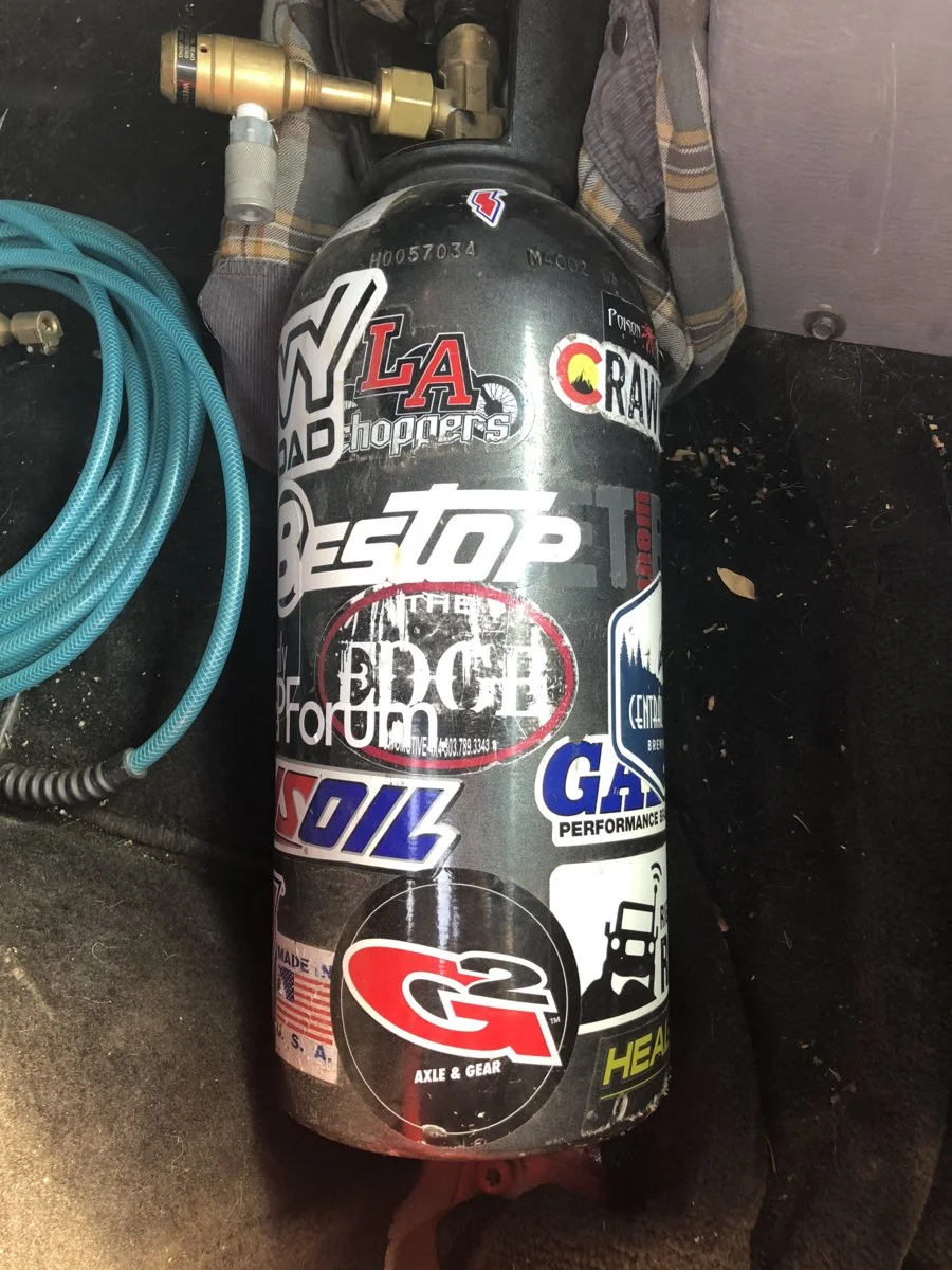

I am using a CO2 tank. It does take up space in the back but its bearable. Refills happen maybe 2-3 times a summer. I can fill up each tire about 5 times with my 10lb tank.
