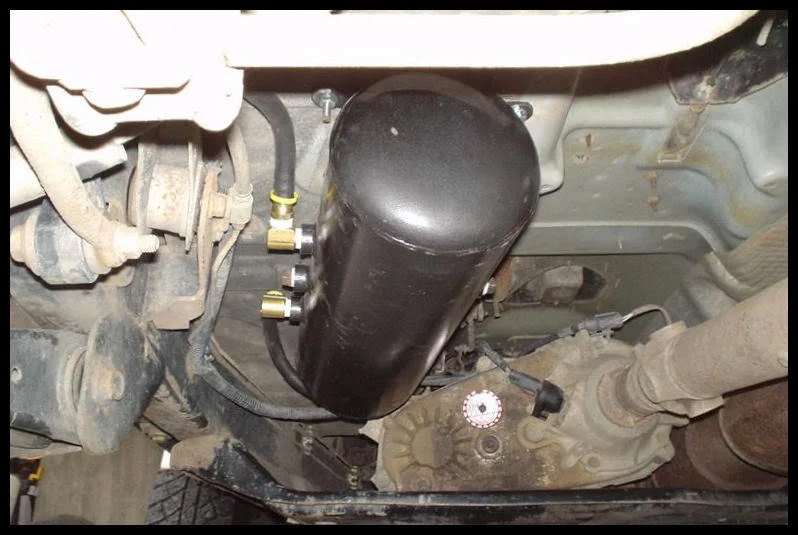

Consider a 1 gal. or 1/2 gal. tank instead. There isn't as much room under the rig for an air tank as you might think.
For tanks I often recommend the Hadley 1 gal. and 1/2 gal. air horn tanks. The small diameter allows them to be mounted in several locations under a TJ or LJ that the larger 2 and 2 1/2 gal. tanks would never fit. (The Hadley 1/2 gal. is 5" dia. x 7" L; the 1 gal. is 5" dia. x 14" L.)
The onboard air system I used in my CJ-7 had a 1 gal. Hadley tank. It used exactly the same mil-spec Thomas 1/3 HP 12v compressor and tank that Currie marketed at the time, but I bought my compressor from Brad Kilby when he was first starting his onboard air company and the tank was used from a wrecked RV. When comparing "air up time" with similar systems using a Hadley 1/2 gal. tank, my 1 gal. Hadley tank, the 2 gal. tank that Kilby offered, and no tank at all, there was very little difference in total times. ( I remember the occasion well because there was a case of beer at stake and much wailing and gnashing of teeth when the judges declared there was no clear winner.)
If I were to add a tank to my current system it would be the Hadley 1/2 gal. tank.

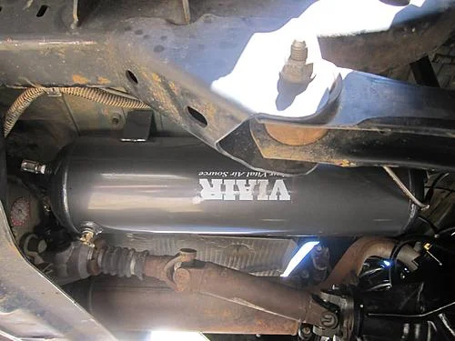

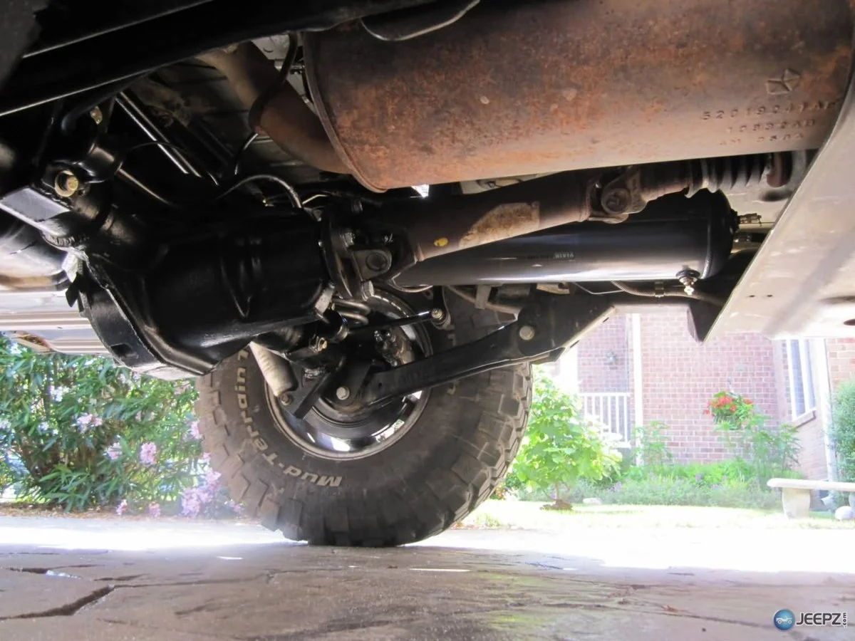

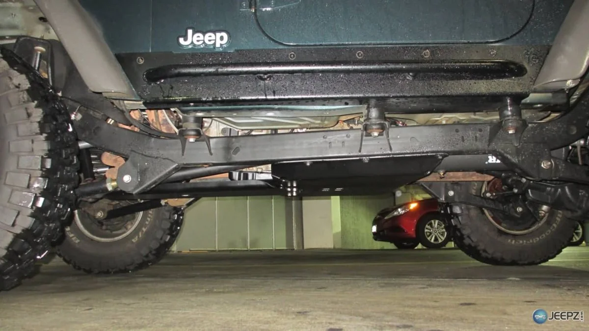

I spent hours dry fitting a 2 gal. tank under my LJ, including the positions illustrated in the photos. Eventually I gave up. My concern was that each possible position is low hanging fruit for a hungry rock - even with the body lift shown in the last photo. Without a body lift I question how long a 2 gal. tank could survive.
The advantage of the half gallon and one gallon Hadley tanks is that they are only 5" in diameter. On my CJ-7 I mounted my 1 gal. Hadley tank laterally just behind the step up in the tub behind the front seats, above the driveshaft. Even at full stuff the driveshaft couldn't hit that skinny tank and it was completely protected from the rocks.
But the issue is largely academic to me because I do not need a tank and do not have one in the system I linked in post #5. I could easily have installed one, and have a Hadley 1/2 gallon tank from the auto recycler on the shelf in my garage ready to go if I ever choose to add air horns or ARB lockers.
