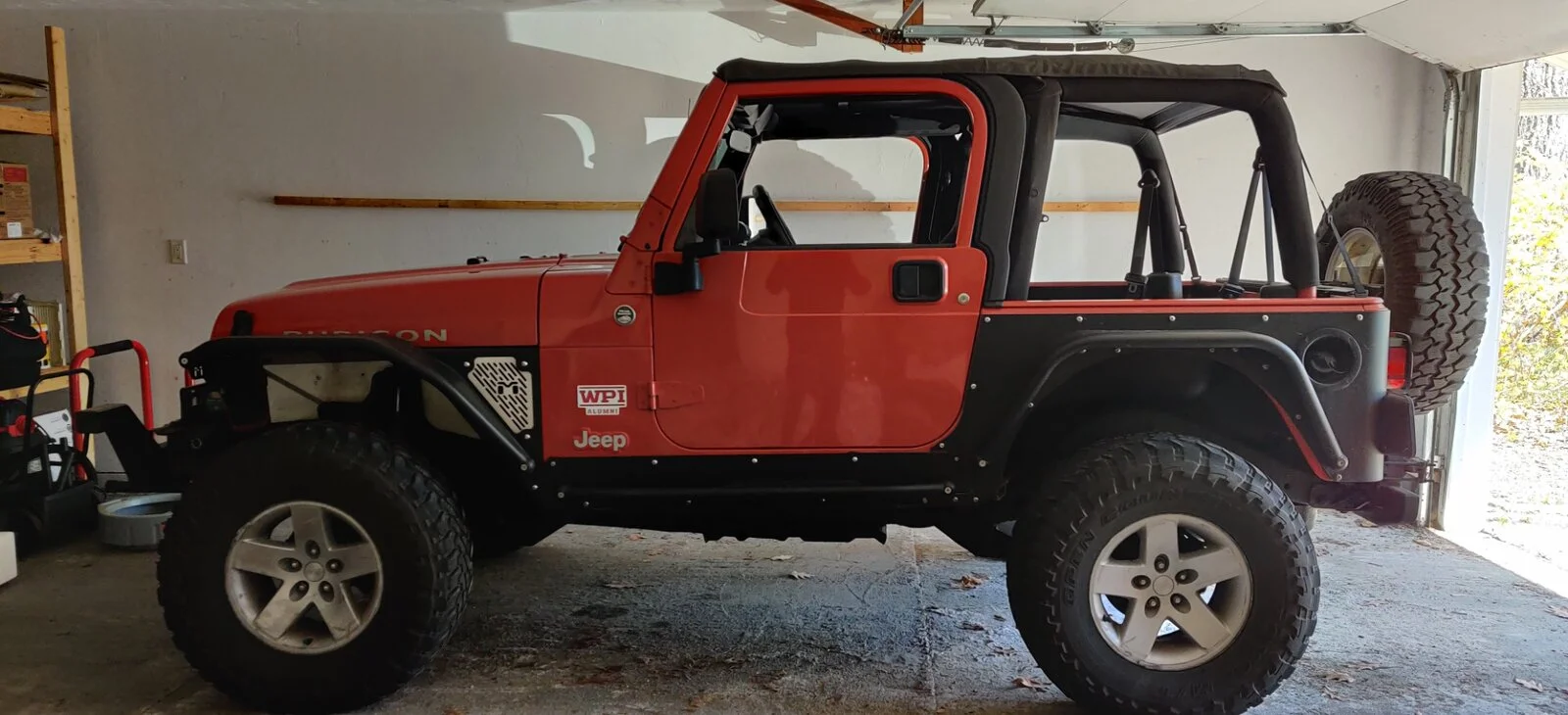

You got some pictures now and as everyone has already commented 33's with a 4" lift might not be the best option.
And as has been said the MC fenders don't really add any more clearance than other stock type fenders. The one thing that is nice about them is that you can remove the flares if running tight trails and you need the tire coverage for street driving.
I have the MC fenders and flares.
I measured before and after, the MC fenders gained about 1.5-2" clearance above and behind the tire... I no longer bend my fender when at full stuff like I did with the OE fenders (tire tread would catch on the stupid pinch seam).
