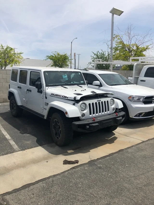

Have had hood fly up once in a Cj-7 and smash through the fiberglass winshield frame and almost hit me and passenger. Around 45 mph. I think the pass latch somehow got loose. There was tremendous hood flutter for about 2 sec. before the hood latch let go.

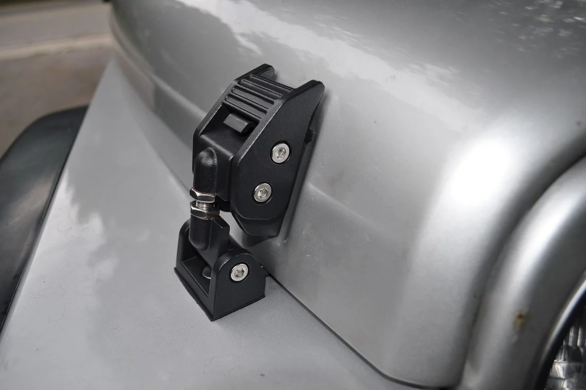

I busted one of the original latches when I was replacing my drivers side fender. Bought the Kentrol stainless latches. I like them have not experienced any hood rattle or looseness.
Reactions: EBW and Ericict

These were actually the first thing i did to my Jeep, really didnt like the hood flutter and threw on some daystar hood latches. Its been over 2 years and i havent seen it flutter once even up to 80mph. Id recommend the daystars as they keep the factory look and end the hood flutter although they do make it a little tougher to latch the hood.
Just swapped mine out with the SS latches and for the first time I experience a solid feel when latching. The metal pivot arms are a huge difference.
