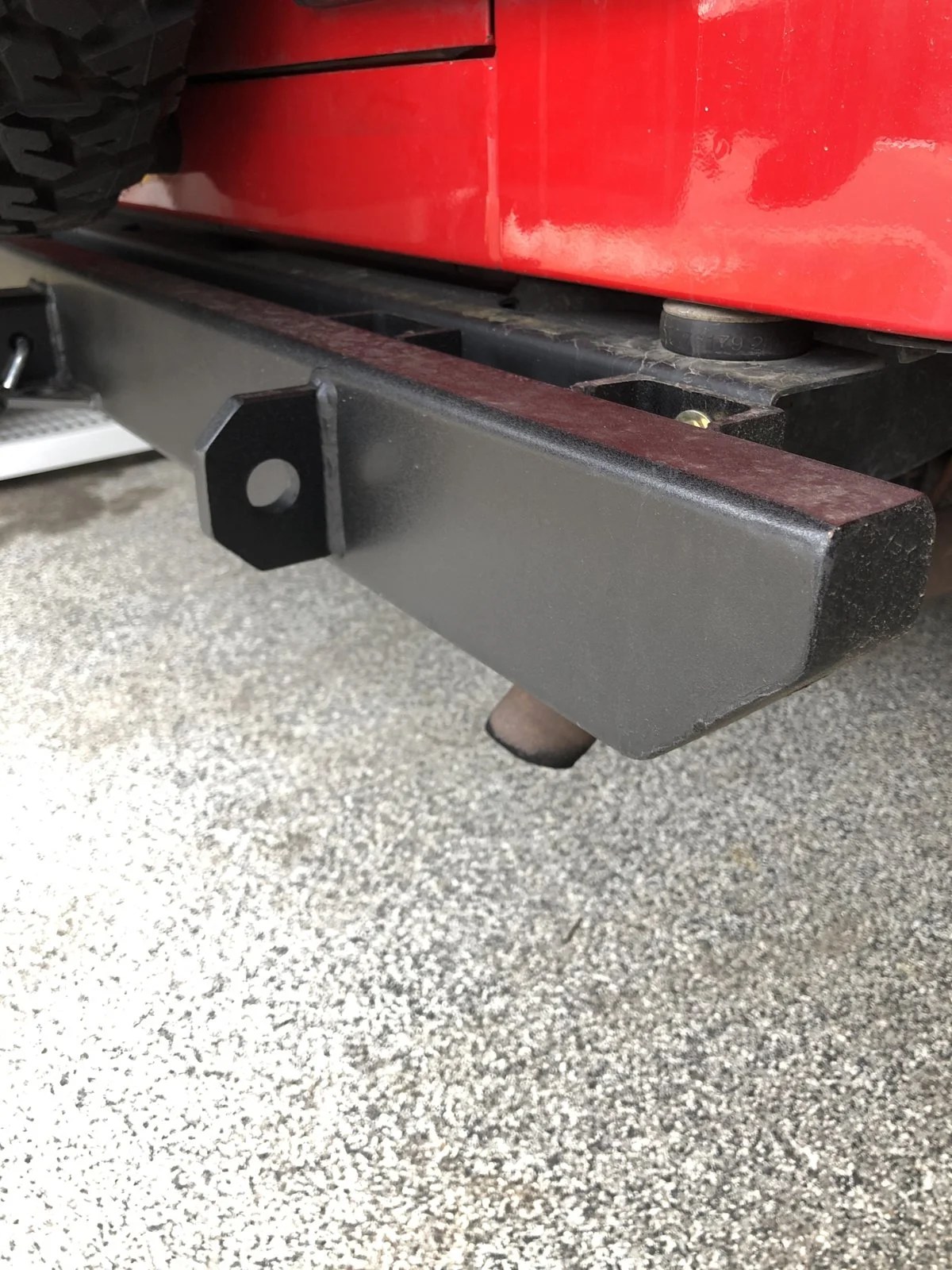

Are you uninterested in all Rustoleum, or just the base paints? I finished my rear bumper with their bed liner rattle can and am so far really pleased with it (granted only a few weeks in). I’m considering using it on my tub as well.
View attachment 85336View attachment 85337
I can see the rattle can being a good option for a bumper, but I am thinking of the brush/roll option for the floor boards. Just more control and no need to tape or mask.

I should share that I did use Hurculiner in my 1969 Commando. While it may have been a prep issue (I was less experienced then) it would come off in little rubberized sheets and had a different feel than the rustoleum finish (which doesn’t feel rubbery).
That’s definitely a good point, the product in both forms is probably pretty good and which sounds to be use case dependent :)
I plan to redo my rockers and front with the rattle, but you’re right to do the tub with the paintable cans.

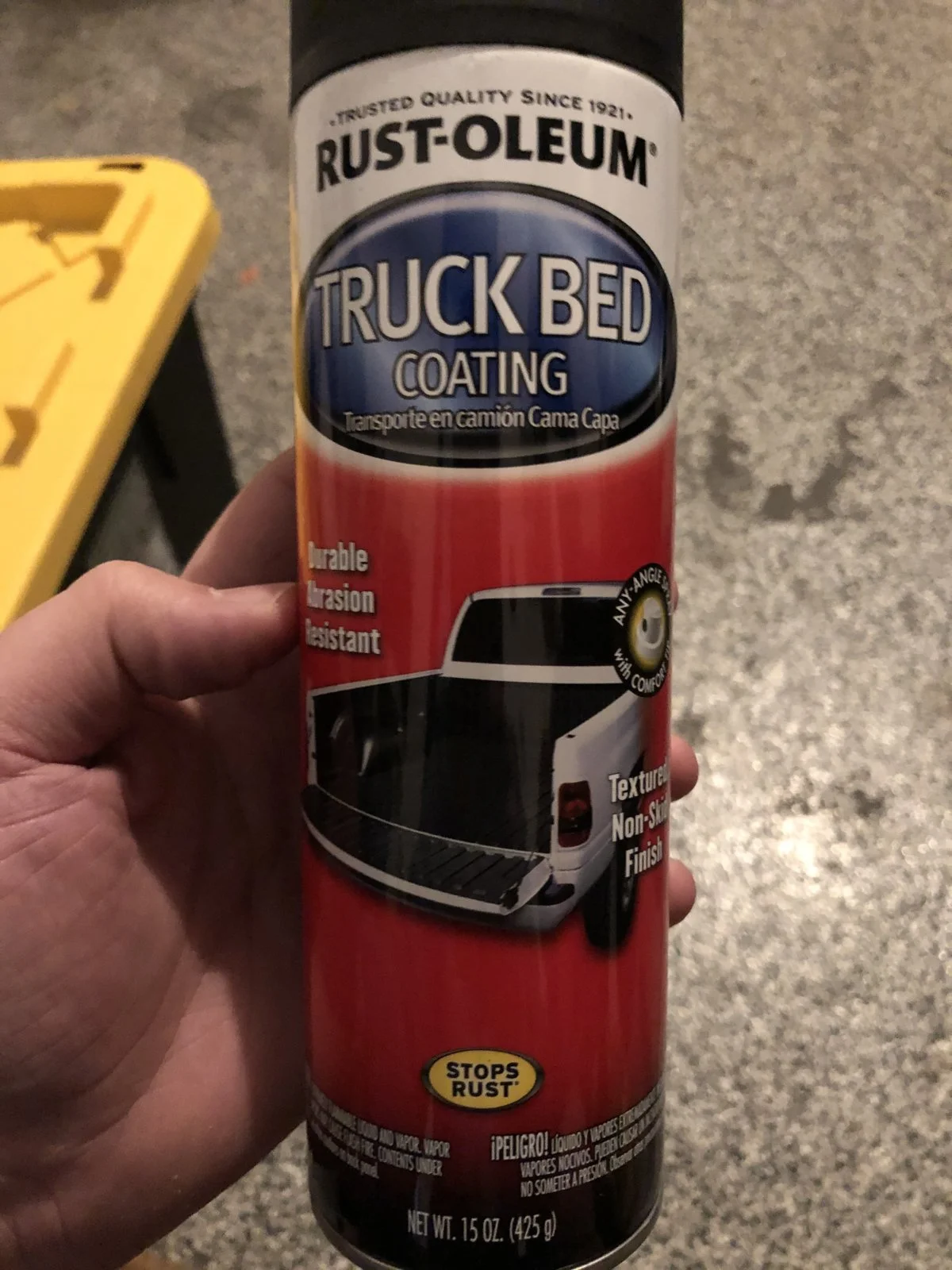

I'm thinking the Rustoleum Truck Bed Coating would be good on my Savvy rocker guards too. They've seen some recent additional abuse lol.

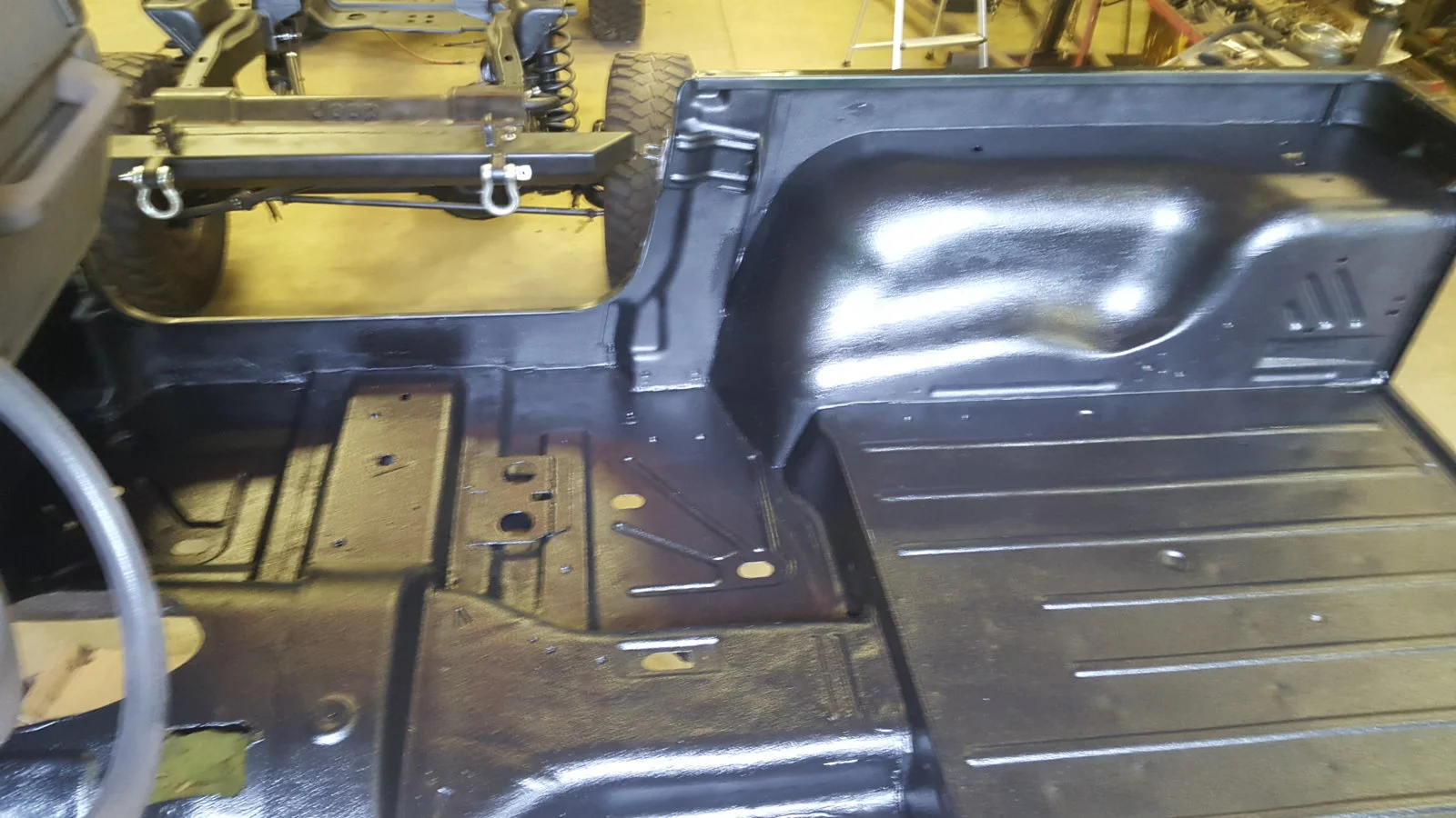

This does not meet your criteria at all but here it is anyway. I used Monstaliner in the tub of my LJ and am very happy with the durability of it. It is not a real quick process, but can be done in one (albeit long) day. The problem I have with spray in stuff (rattle can variety) is it will wear off fairly quickly from grit and whatnot abrading through it's relatively light coating. I have had pretty good success with Rustoleums brush on industrial paint (available at Home Depot). and the "safety red" is a close match to my stock red.......

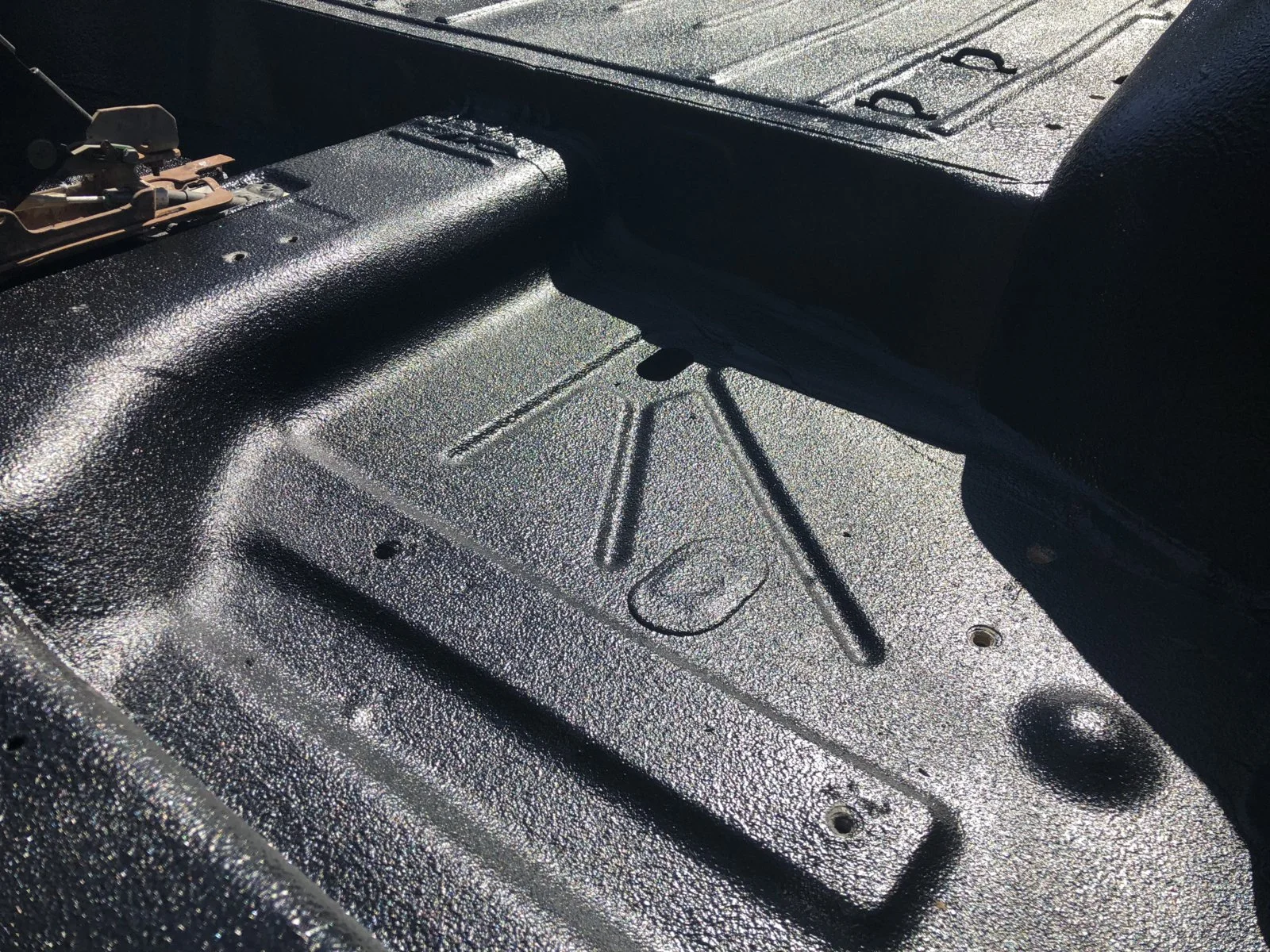

I used the spray rustoleum bed liner on my new fenders.The tj was black already .I also used it after I put in my new floor pans and it seems to be holding up well.I used 3 light coats and let it sit up for an hr. between and the fenders came out great.The floors have stood up well also after a year.Can get it at walmart up here in Canada.

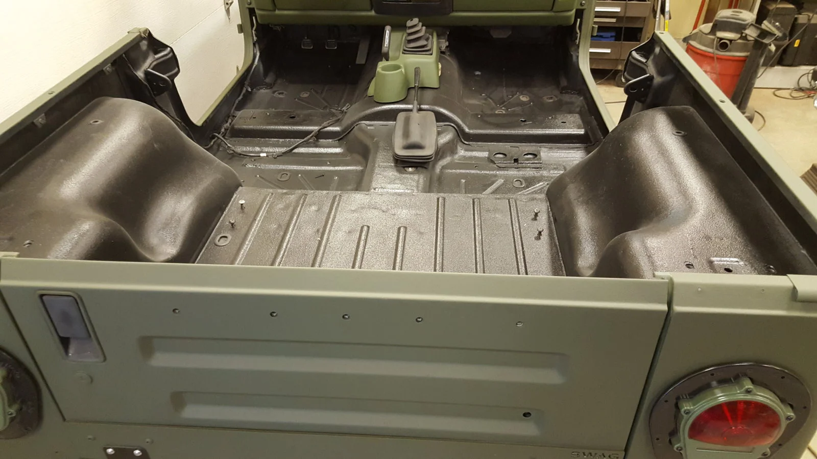

You should really check out @JamesAndTheSahara build thread on here. He did his in a weekend and it came out looking amazing. The product he used came in spray cans I believe.
It came out looking really nice. He did it in his apartment’s parking lot. He did a whole write up in his thread with lots of pictures and details.
